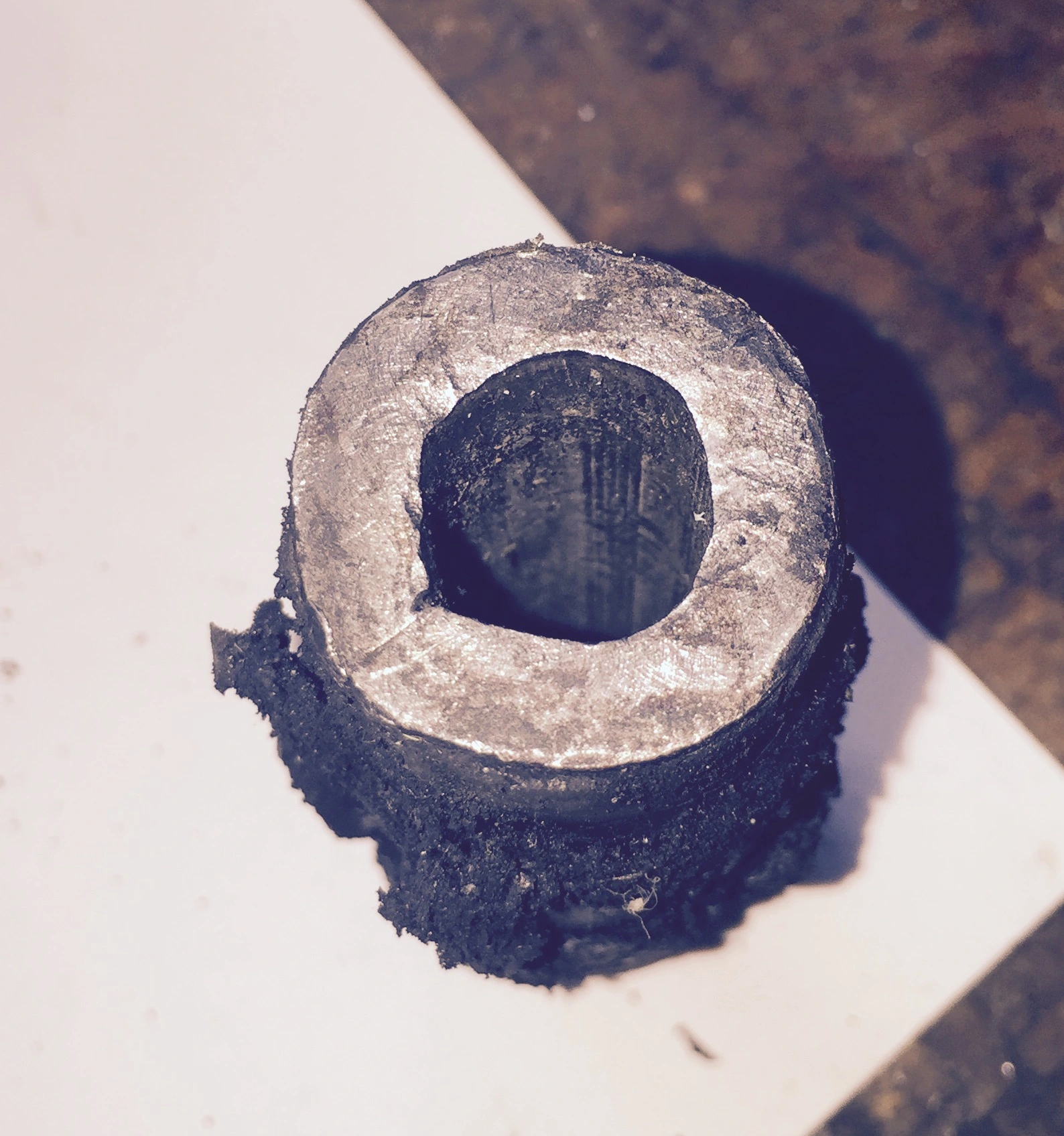

If all else fails, look into the differential bushing. This is the bushing on top of the differential that absorbs movement from the upper control arm. It's not an easy replacement but do-able with patience. I was surprised how beat up the inner sleeve was after only ~15k miles.
Pics of the inner sleeve. I drilled/dremel-tooled it out, just cut away the rubber. New BMR bushing slides in in 2 pieces, 1/2 from each side.
