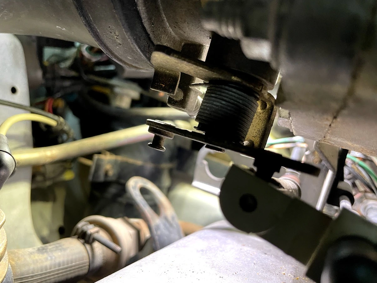

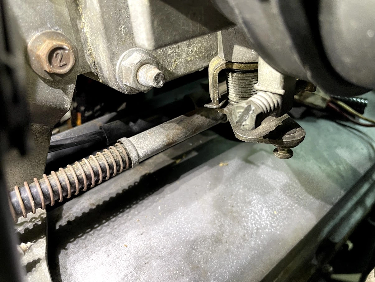

Here you go.. as you can see the screw/spring combo is almost all the way in compressed. If I force it tighter, I get a bad loping 400 idle, if i back off a bit I get a smooth 400rpm, then if back off more then it gets to 300rpm or so and any less on the screw then it just dies.
Maybe I need to get the timing back up high as before with the IAC and check timing first?
Again, this is all stemming from a bad cold start requiring a second key turn, then a lope then smooth idle and NO driving problems at all. Just a high idle of 900rpm.

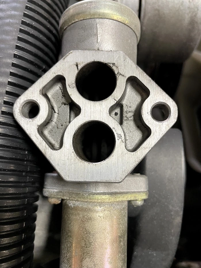

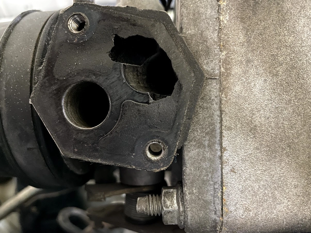

OK I took off the IAC as well just to see what I could see, it itself looks rather clean but the gasket and TB look kind of wierd, like jagged on the top hole in the TB. Does this look right?
Mike

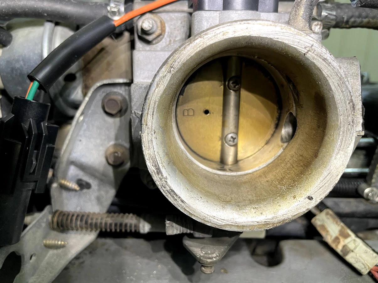

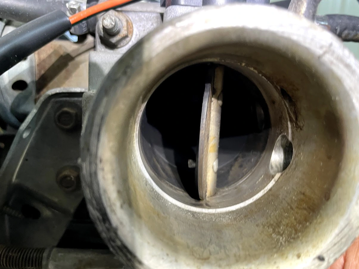

Here is TB at idle position which looks to be pretty much closed and that is with idle screw all the way in, and the second picture it wide open throttle just to see inside, looks a bit dirty, no idea if that is part of problem but I think I'll take it off and clean it anyway eh?
