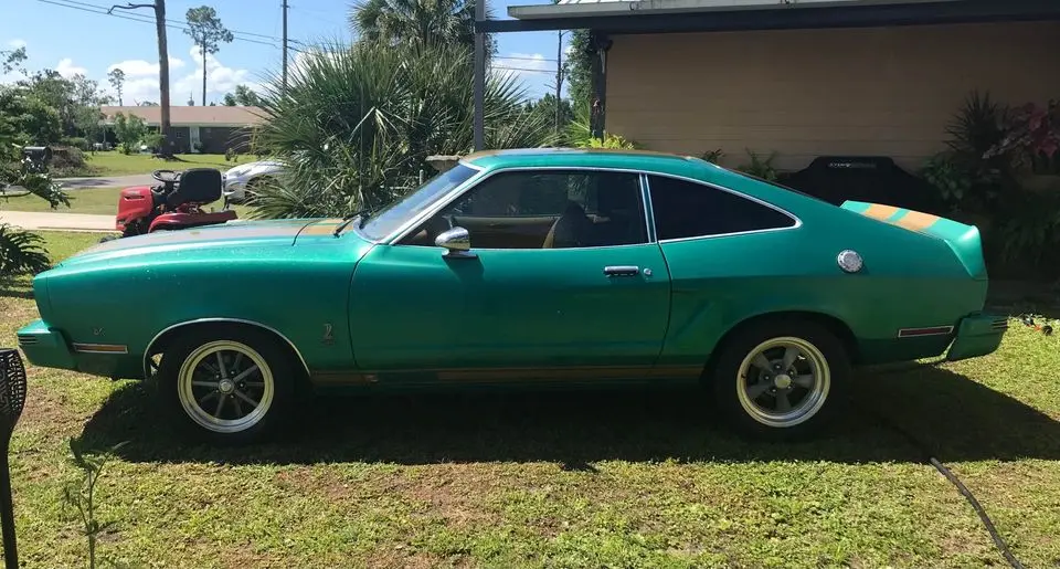

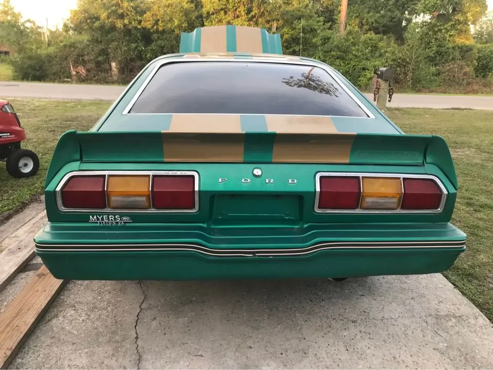

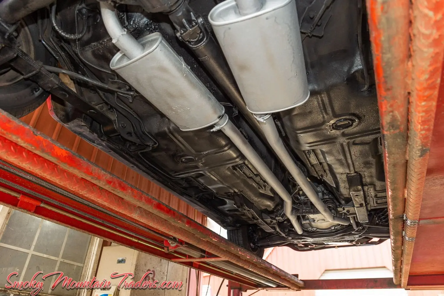

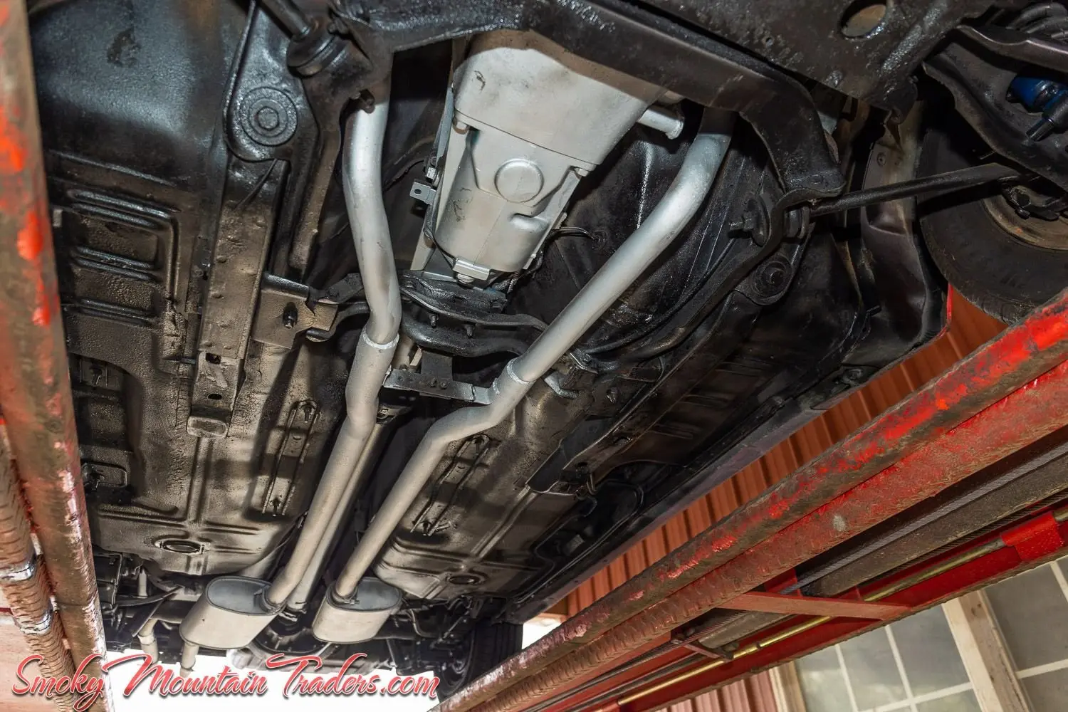

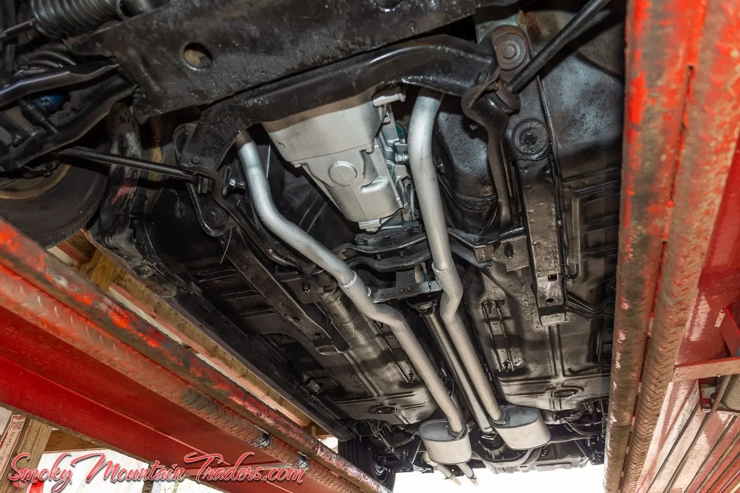

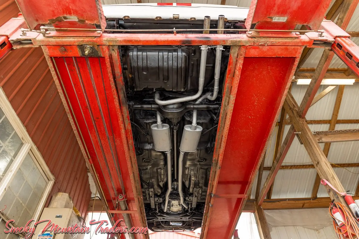

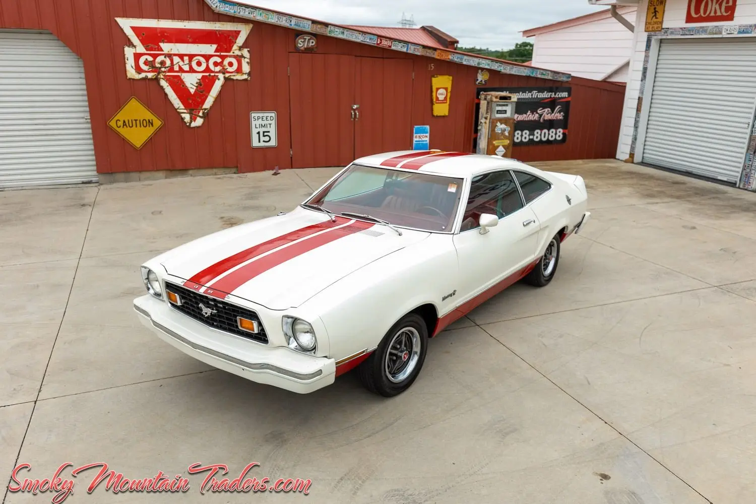

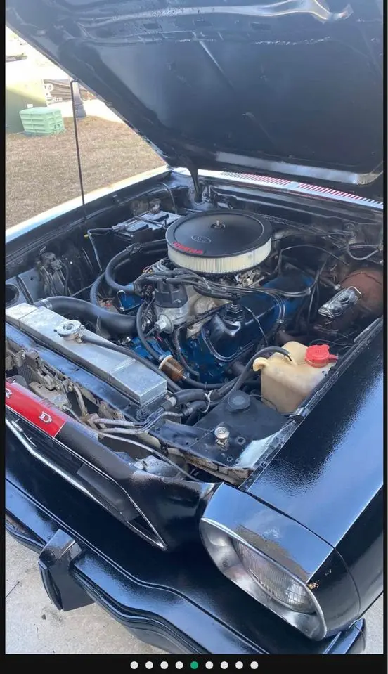

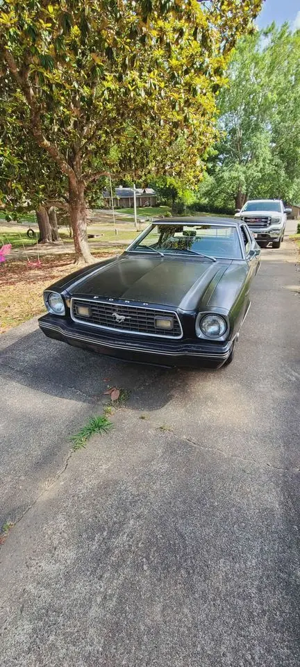

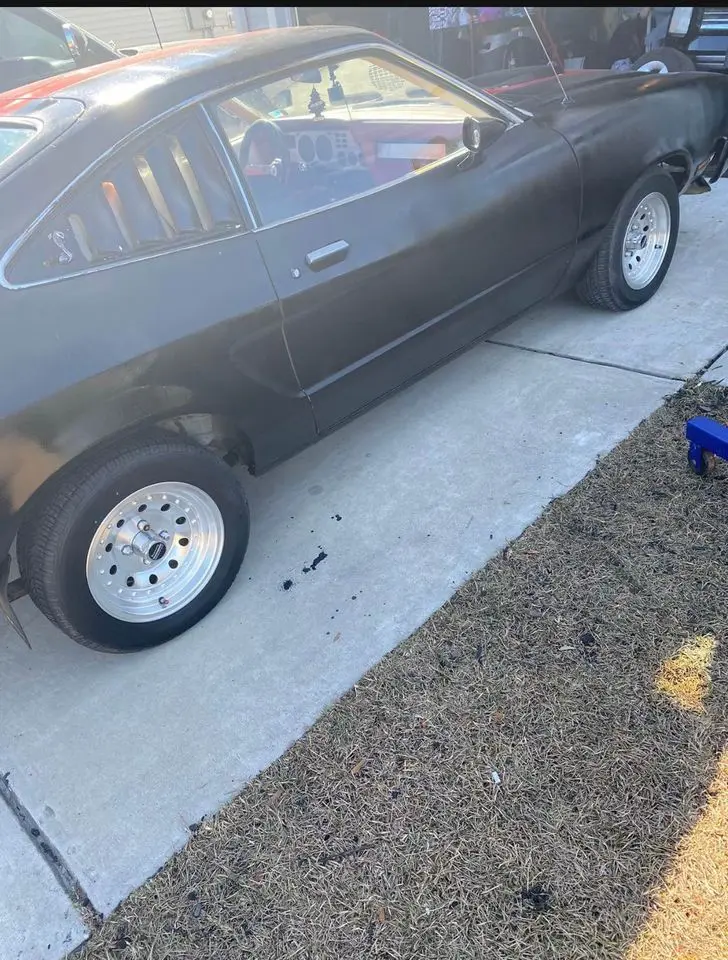

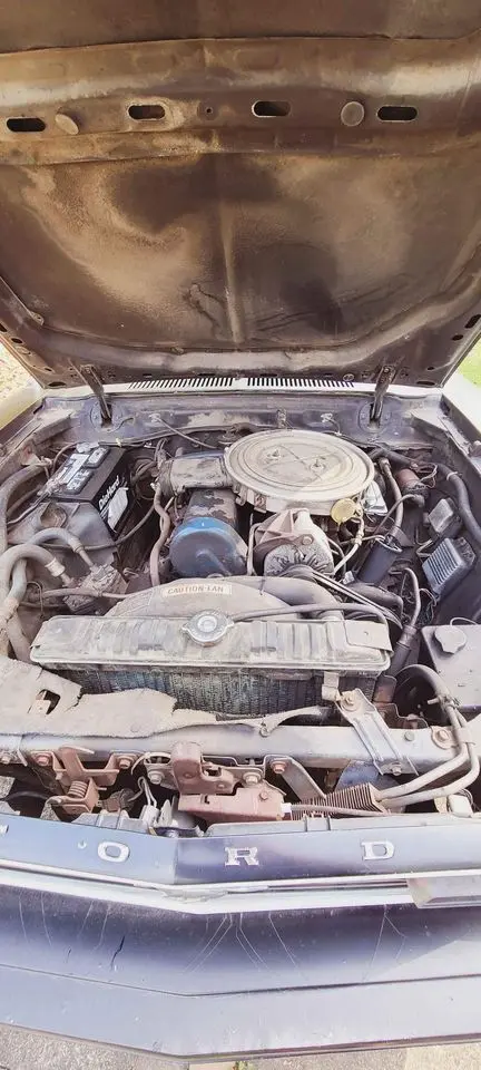

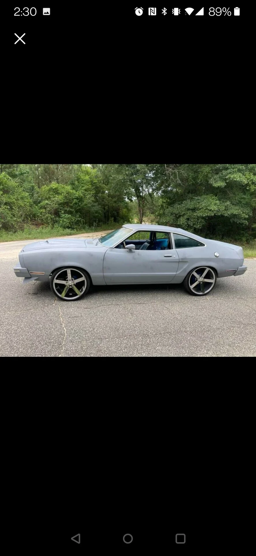

Lipstick on a pig to my eyes. Rusty seams. Looks like they did an Earl Scheid paint job top to bottom and are asking restored prices. I can see non painted surfaces on the bottom. Rotted weatherseals. Ghia badging and an a/c panel on a non ac car. Painted hood latch ect indicates lazyness. Why is there a plastic tray under the battery? Metal too rotted to keep it level without it? Door jambs look horrible.

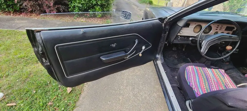

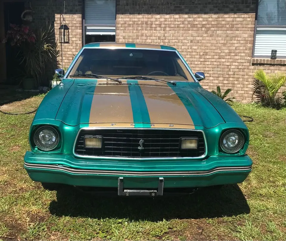

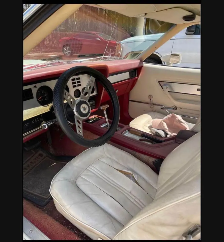

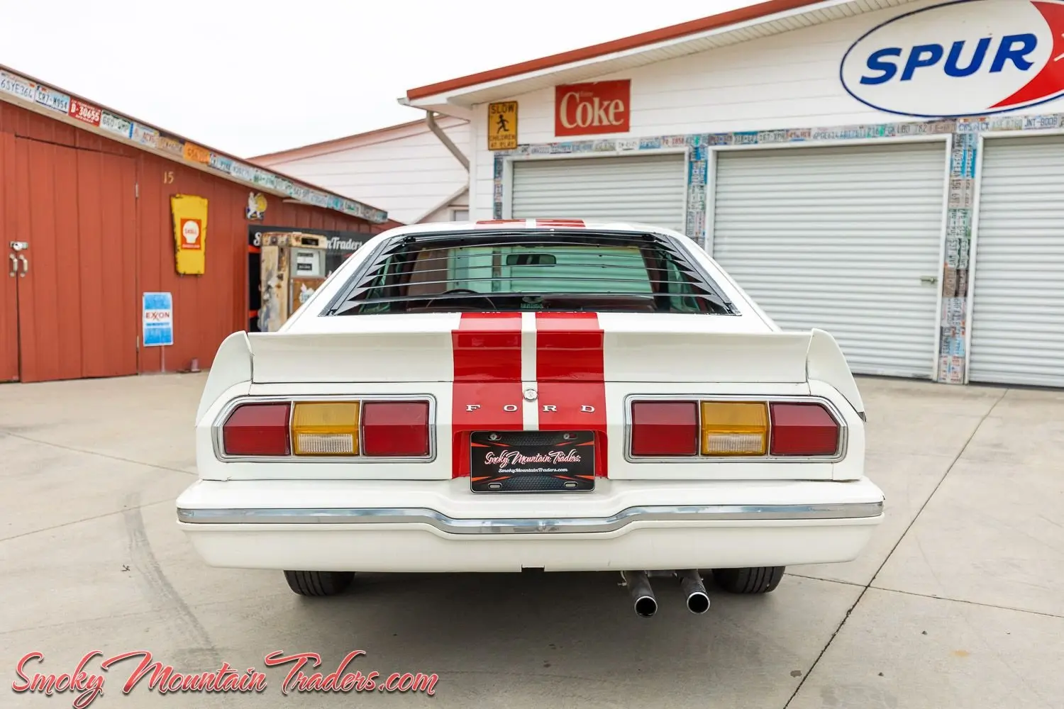

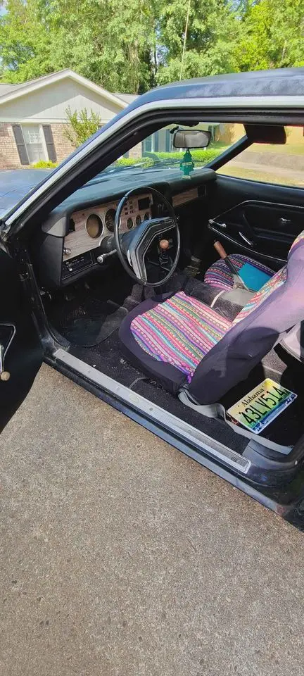

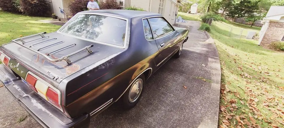

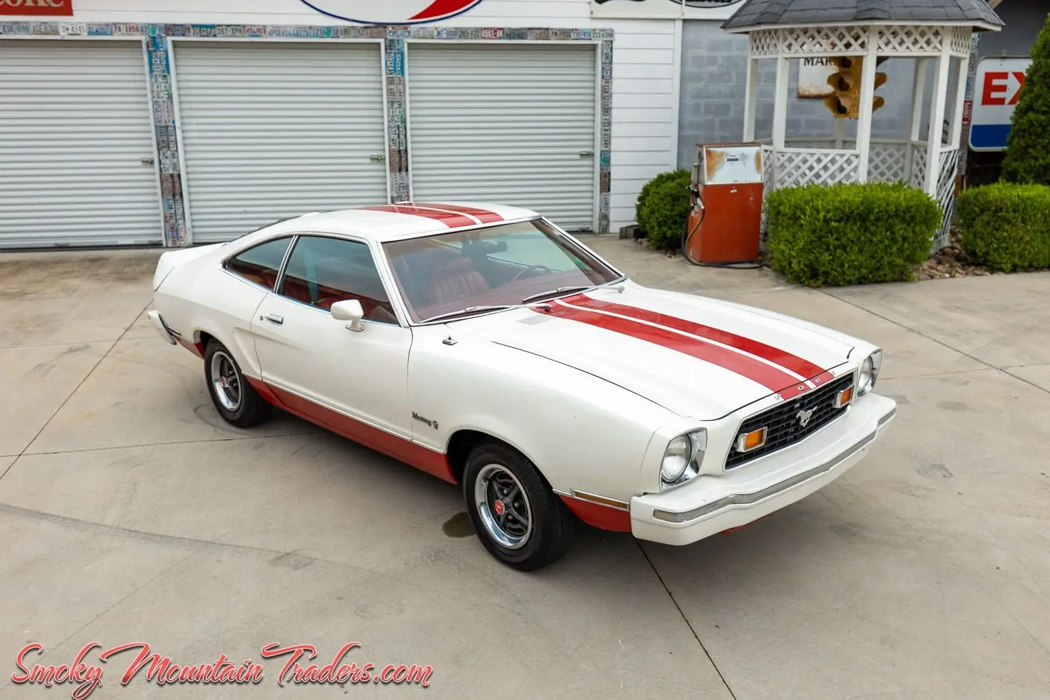

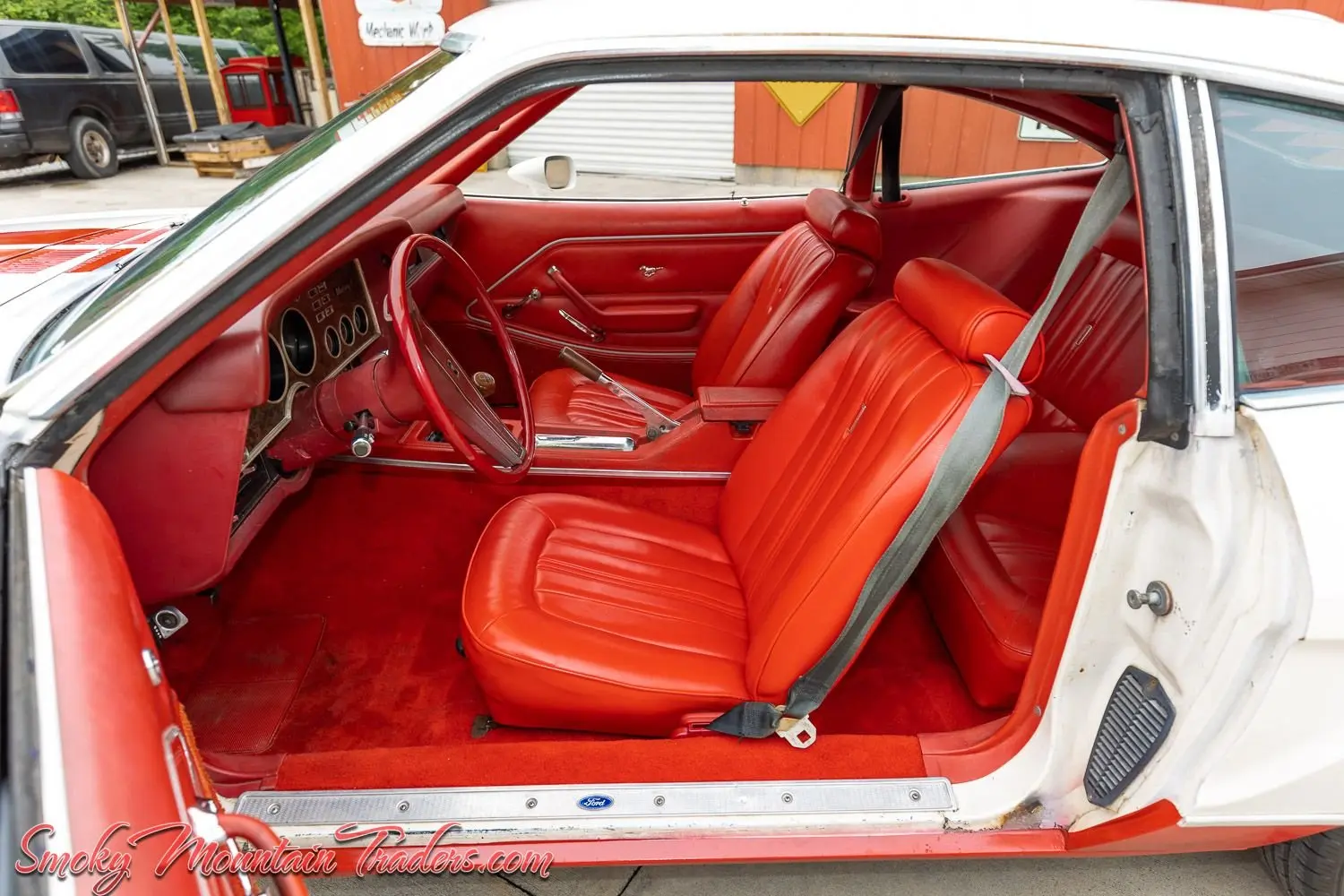

I highly doubt this is a Mach I. I was under the impression Mach I's came pretty loaded. This car looks like it came with am radio looking at the door panels. No rear sway bar. The front looks like the smaller one. I think Mach I came with the competition

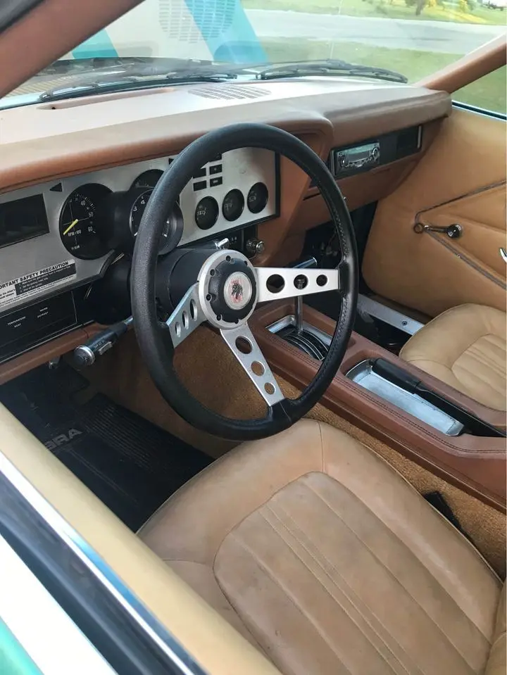

suspension. No front spoiler. It should not have the rear spoiler. It's poorly installed but there. No hood scoop. The tail panel is body color and not black. Steering wheel should be the three spoke.
Very misleading and just screams run by the way they are presenting it.
