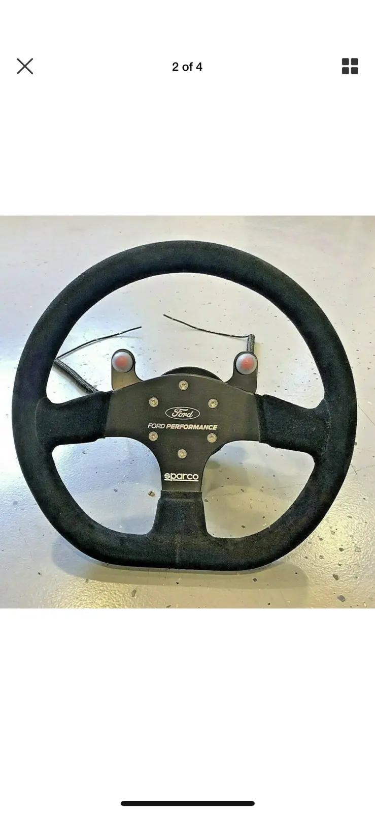

Progress Thread My centrifugal ppl, how’s this deal?
I believe I could use this setup but how does one go about hooking this up??? Just the piece from amazon, the other wheel was just for reference even though I’m sure all you guys know what that piece is, ha ha. Has the wiring from the back of the buttons ready to go Im just not sure how I’d wire this to make the horns work. Thanks!

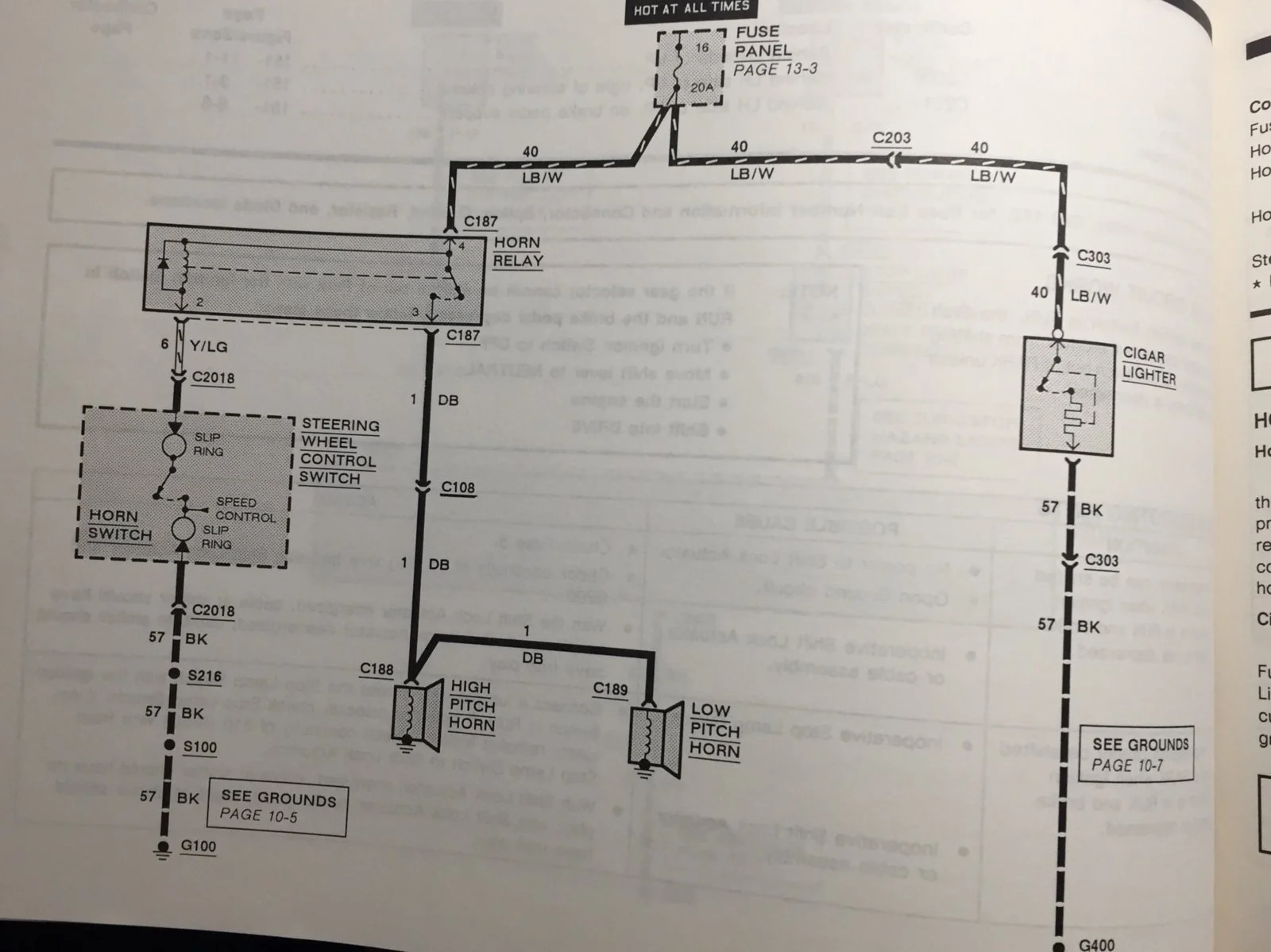

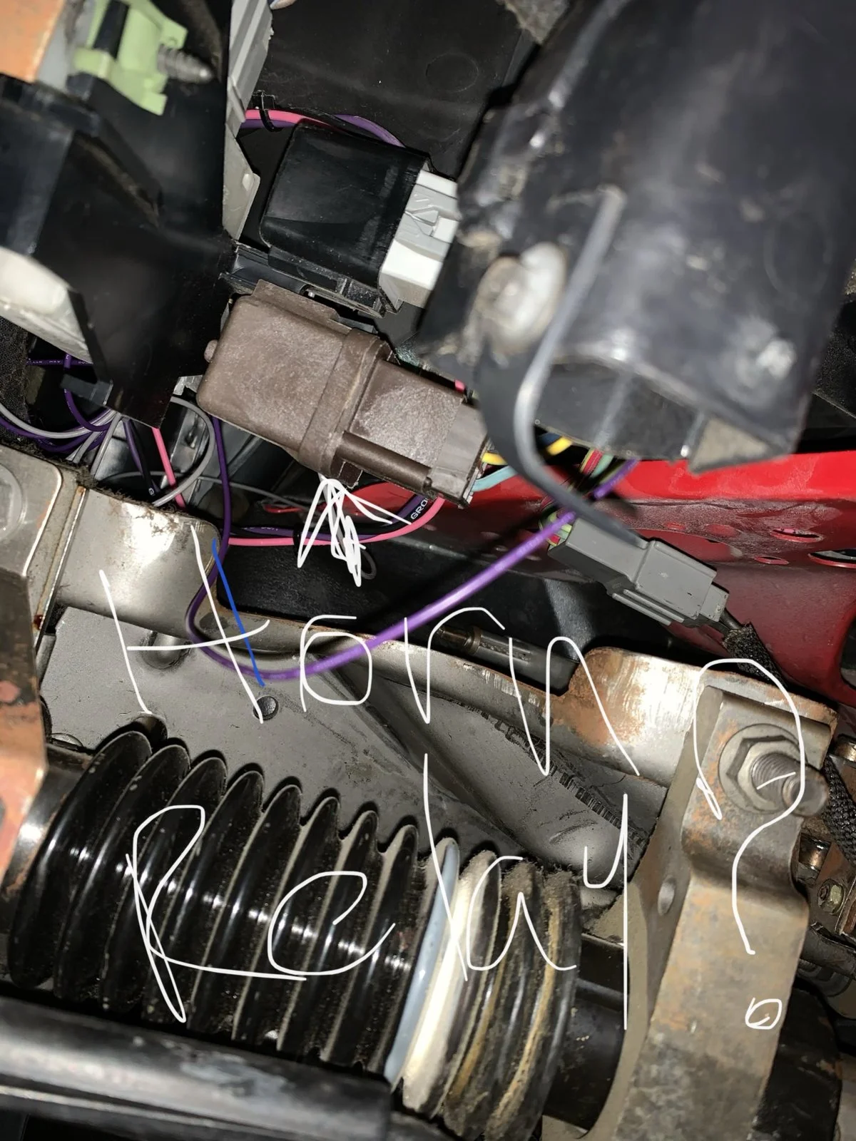

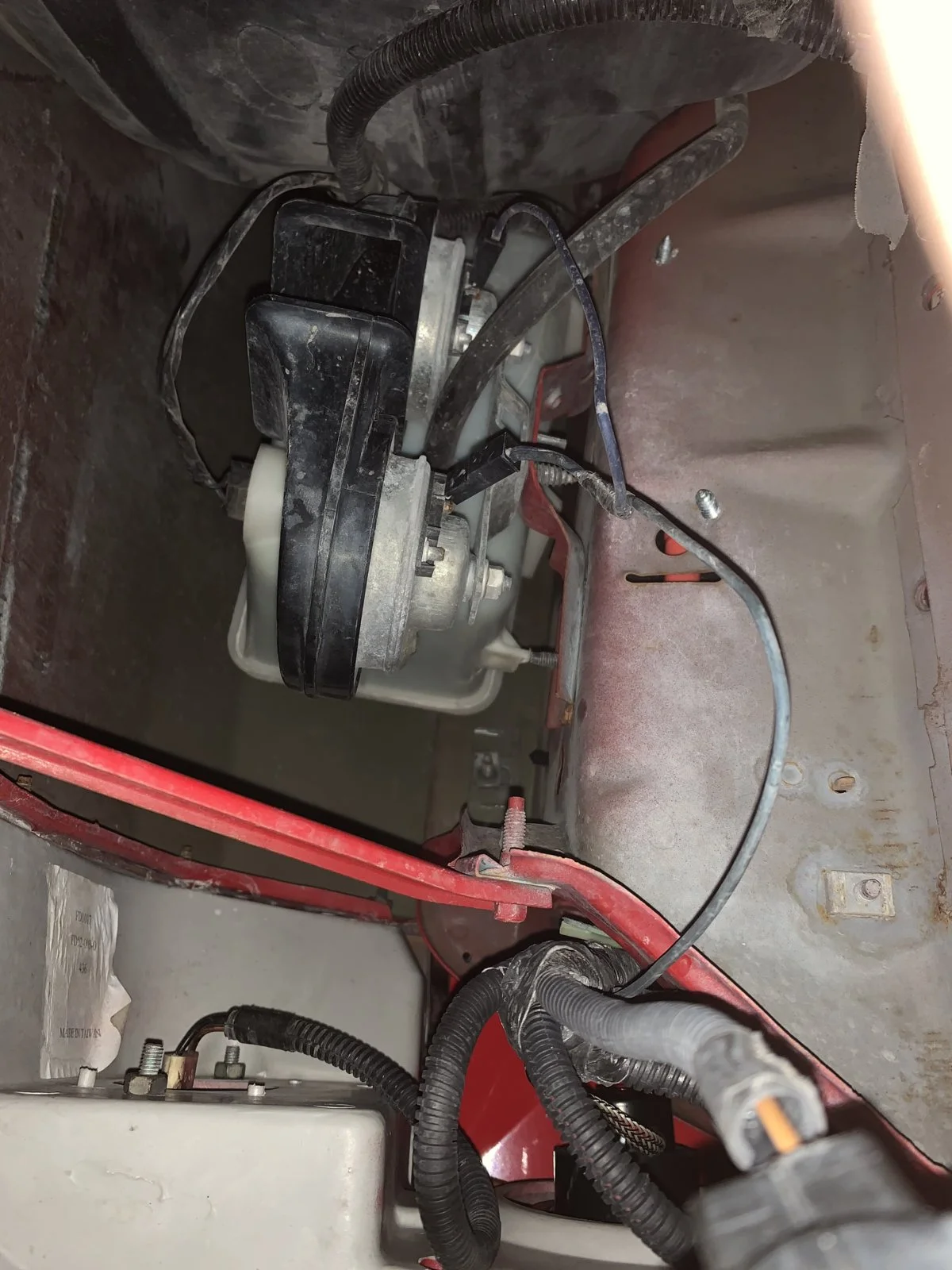

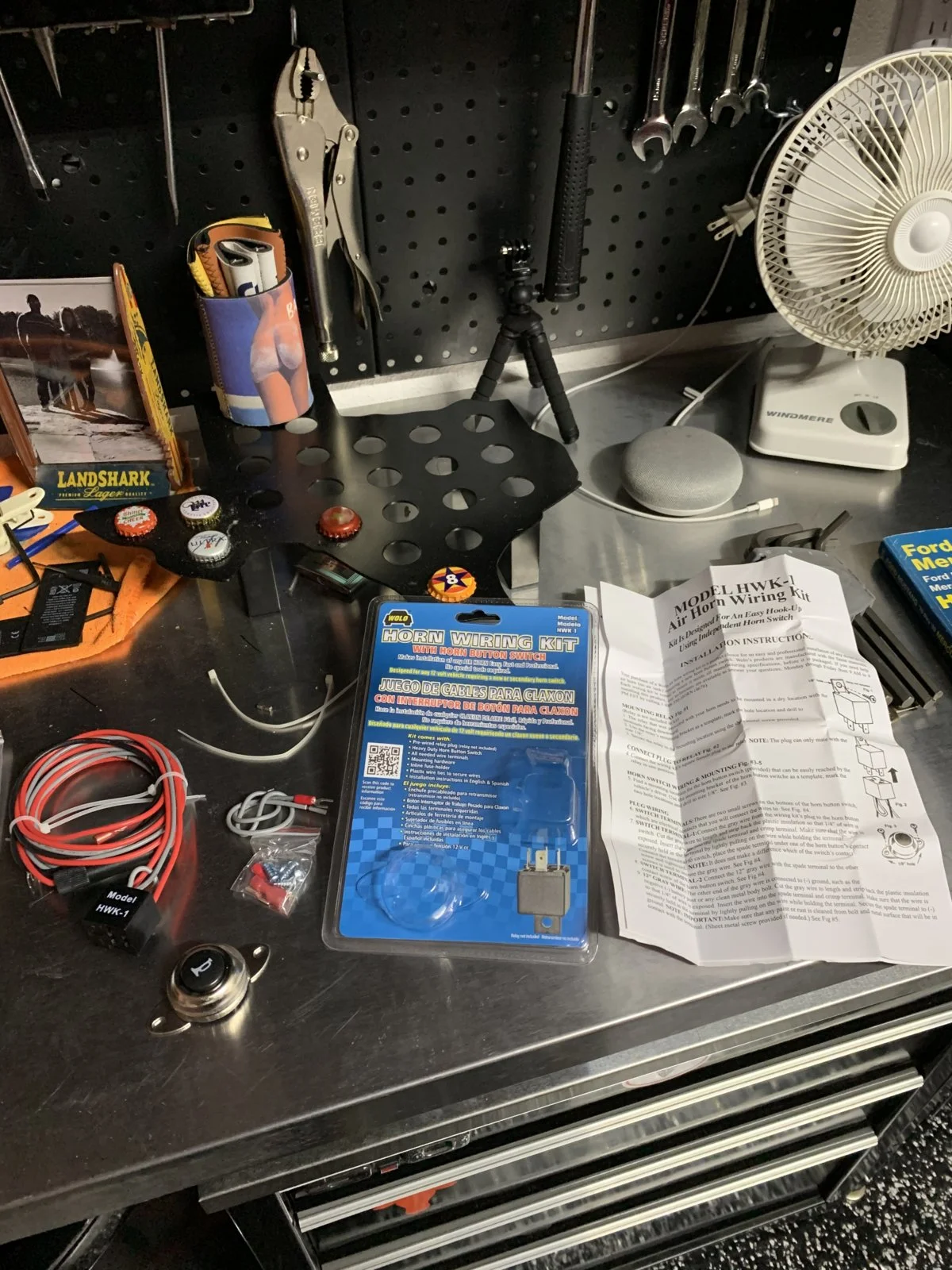

Ok so I opted against the fast and furious nitrous express button thingy. So picked this kit up at autozone. I’m just trying to rig something so I can honk for inspection. I’m not sure if I’m suppose to buy a whole new relay or use the existing horn relay to which I have no idea where it is. I know this is probably super easy for a lot of you but wiring is not my expertise and just suck at it. Found the horns, and what I think might be the relay but not sure. My car is a 91 so if you can help me out I’ll take it. If there is an easier way I’ll listen to that to thanks guys.
I don't think you need the relay here. You aren't running a high current horn. You just need to ID the two horn wires on the colume, tap into them and install a button to connect them.

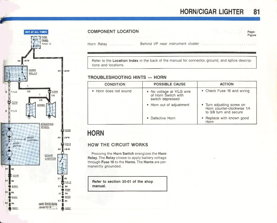

I'm at work now (not that I would really call it work the Friday after Xmas) but my 91 wiring diagram manual is home. I can get you two colors to tap into in the colume. Just tap into those, run your wires to your button and you should be good to go.
Cool that would be appreciated thanks
It's a high current air horn. The factory uses a relay, don't need a 2nd one. I have the same horn from HF.
Not needed though. Just ground that wire and your horn should beep.
That means tap into the wire, connect to horn button, connect other wire to any metal chassis ground and call it a day
