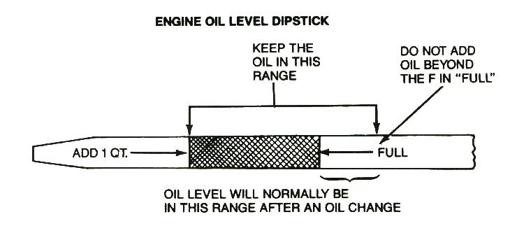

Changed oil and filter. Drained both front and back of oil pan. Filled with 5 quarts. Dipstick shows 1 inch above full mark. I was told before "just mark the dipstick at 5 quarts and live with it". The dipstick is the correct part number per the ford parts website (F1ZE-6750-DA M). The car had work done to it before I got it but I cant see someone changing the dipstick tube. Does anyone have an explanation for this?

If you look in the Ford Service Manual, it shows that the oil level can be all the way up to the "F" on the Dipstick.

Drain both front & rear sumps, put the drain plugs back in. Then change the filter and add 4 quarts oil. Start the engine and let it idle 2 minutes or so. Shut it off, wait 2 minutes for the oil to drain back into the pan. Pull the dipstick out, wipe it off and stick it back in. Pull it out again and take note of the oil level. I marked the dipstick with a scratch from a file at the 4 quart level.
Add the 5th quart, start the engine and let it idle 2 minutes or so. Shut it off, wait 2 minutes for the oil to drain back into the pan. Pull the dipstick out, wipe it off and stick it back in. Pull it out again and take note of the oil level; it won't be anywhere near the factory full marks. I marked the dipstick with a scratch from a file at the 5 quart level, which is about 1" above the factory full mark.

Yes they left the Factory this way, again the Service Manual says the level can be all the way up to the "F" and considered normal.
