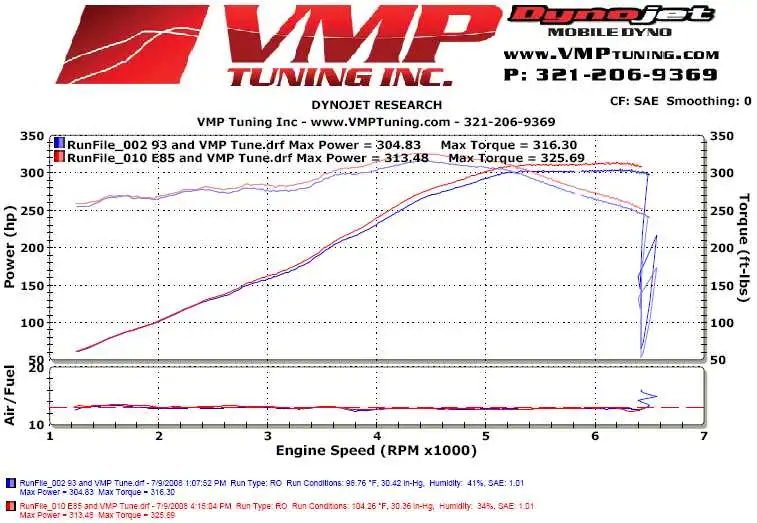

Recently we put one of my local customers cars on the dyno to test E85 in it. He has an 08 Mustang GT Manual with a C&L Racer intake, CMCV deletes, stock cats, and magnapack mufflers. I made some baseline pulls on his 93 tune with around 12.7 A/F (.87 lambda), this car is able to run 30-31* of timing at WOT with no major knock sensor activity.
We then drained the tank and put in 8 gallons of E85.
I got the tune set up for E85 and dialed it in to run the same lambda that I was running on 93. I've found that a lambda of .86 to .89 (12.6 to 13.0 in gasoline terms) works best on these 3V motor. Going to .92 lambda on E85 (about 13.5 in gasoline terms) caused a power loss.
On E85 the car did not run significantly more timing, there may have been slightly less knock sensor retard, by 1/2 degree or so.
Now onto the results, the car gained 9RWHP and 9RWTQ on E85. This is totally suprises me, but is consistent with another 05+ GT owners results found here. The additional power could be from the oxygen locked up in the fuel, which is realeased during combustion or from the cooling effect of the greater fuel volume and the alcohol. On boosted cars, the gains will be even greater because of the additional timing that can be run on E85, due to the additional octane.
