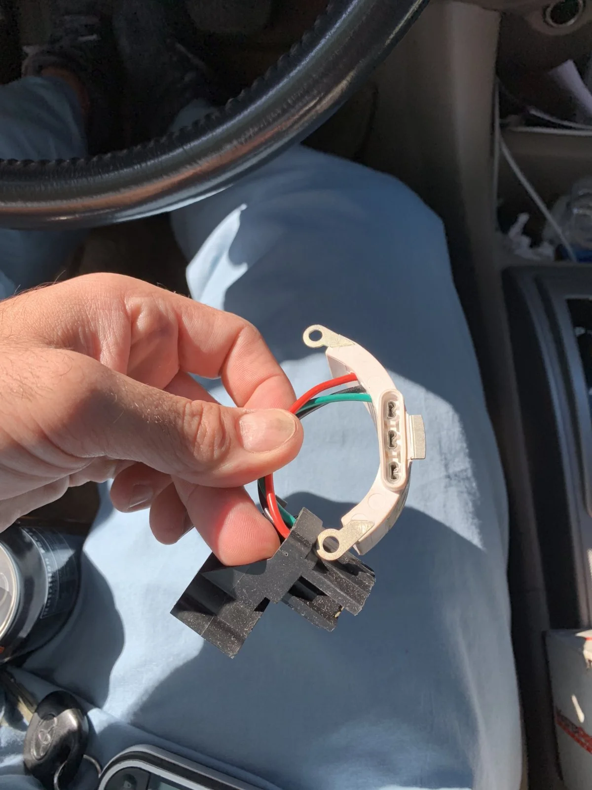

Ok so picked up this little do dad from oreillys. Is this hard to swap out? Do I need to put anything on it like i did for the tfi module? Anything I should or shouldn’t do? Never replaced one of these things before.

If you going to do it in your garage you will need a gear puller or similar device to get the distributor gear off the shaft. Then you will need an oven or toaster oven for reinstalling the gear. This is used to expand the gear to slide it back on the shaft. Be careful to align it before sliding it on, but you dont have much time due to the gear cools quickly
If you dont feel comfortable then you may want to take the distributor to a shop to pull and put back on the gear.

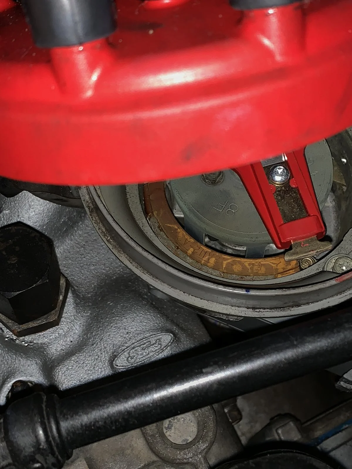

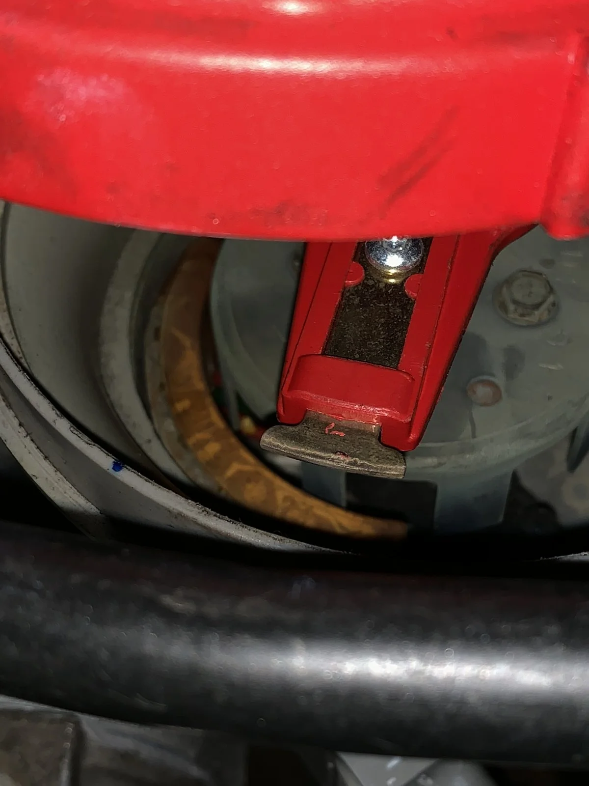

Take the cap off and look below the metal plate the rotor sits on. You'll see a little sensor down there. It shouldn't look powdery or soft. All the ones I've found that we're bad has some weird corrosion.... almost like battery acid on a battery post. It's easy to overlook.
It's the part the TFI module plus into inside the distributor and reads the metal piece under the rotor button.
So this is what mine looks like on the inside. Is this what you were talking about?

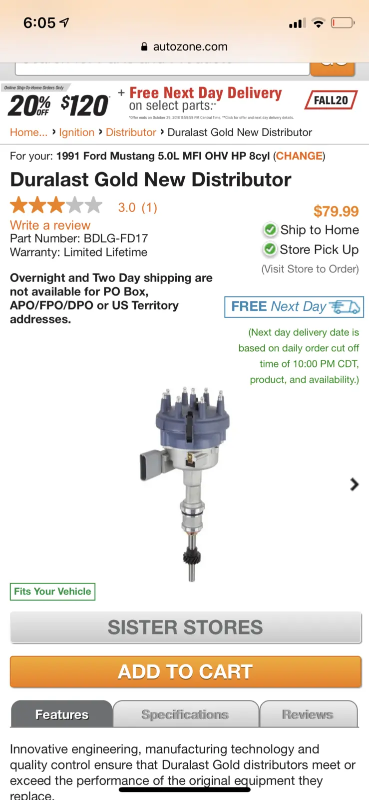

What if I just bought one of these from autozone? Are they ok? if i pull the distributor out is my timing all going to be off?
Those are fine, we just put one in a customers car and it ran great.
Checking your timing is pretty much mandatory whenever you pull the distributor out and put a new one in. Timing lights are cheap and it’s good peace of mind.
Everything ive seen on those rich porter new distributors ive seen says run far far away. Rebuilt stock ones are hit and miss too, I bought one for the 427w and it was unusable because the gear and thrust collar were waaaay far from being in the right spot. Ended up going with an msd since I didn't have a stock 351 distributor to just rebuild myself, but since all your components match I would just swap that sensor. Yes, you'll need a puller or a press to get it apart, but it really isn't that hard.
