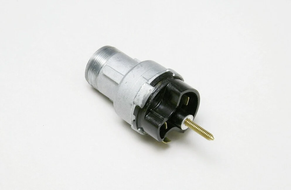

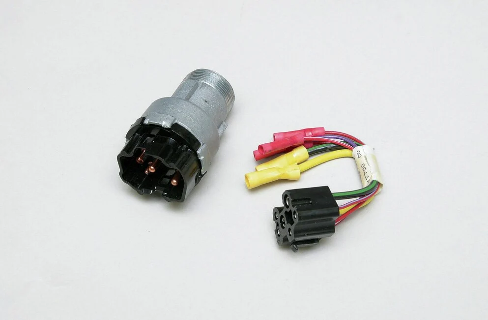

I read something about the hokey ignition switch on the 67 with the accessory post. Although you have a 69 you may want to see if someone used an easier ignition switch with your car. I bet if you had a 67 and the post was accidentally connected to the starter circuit as soon as you turned on the ignition (not to the start position) the starter would fire.
67 ignition switch
69 ignition switch
This may also give you a clue where to look. If you have the 69 ignition while it may be protected better than the 67, if the starter circuit is touching the accessory circuit somewhere you may have the same effect.
See sections 07-09 at the below link.
