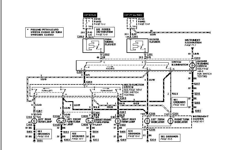

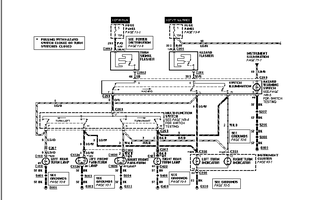

92 LX 5.0, turn signals don't work but 4 way flashers do! Changed the fuse and both flashers (all checked out OK). Still don't work. I also have a Painless Performance switch panel in the ashtray that also quit working at the same time, switched for line lock and back up lights. Any ideas for my next move?
