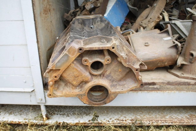

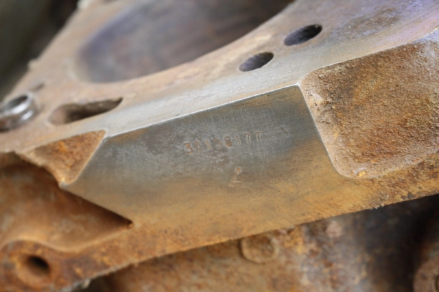

On the 302 and 351 Windsors ,it is on the very back of the block behind the intake on the square flat pad cast into the block ,i have a couple of 4 v Cs i can look at though .
I found the numbers on the back of the block on driver side ,they will not be easy to see in the car .I believe this is the vin number and not a date ,but if the vin matches the vin of the car it should be the original block
