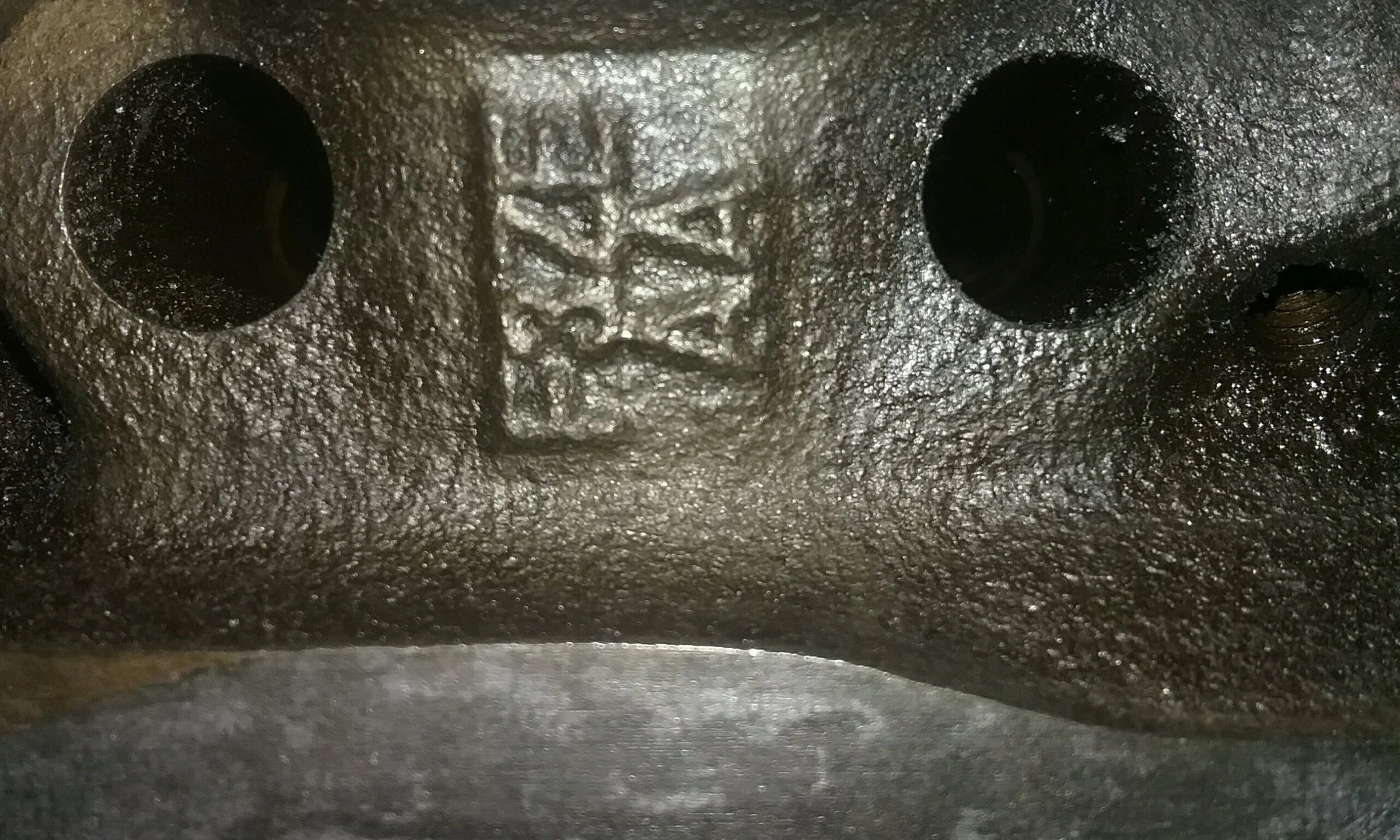

I have gt40 heads stamped F3ZE AA with half inch head bolt holes thats all i know they are steel heads pedestal mount rockers need to know exactly what car or truck they came out of thanks

The GT40 heads with the 1/2" head bolts were on the 93-95 F150 lightning with the 351 in it, and 1996 Ford explorers.
1993 Cobras used GT40 heads with 7/16" head bolts.
Unsure what the 94-95 Cobras had. I want to say 1/2" head bolts.
Do your heads have the smog ports in the exhaust port?

I dont believe so
