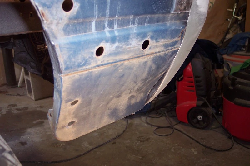

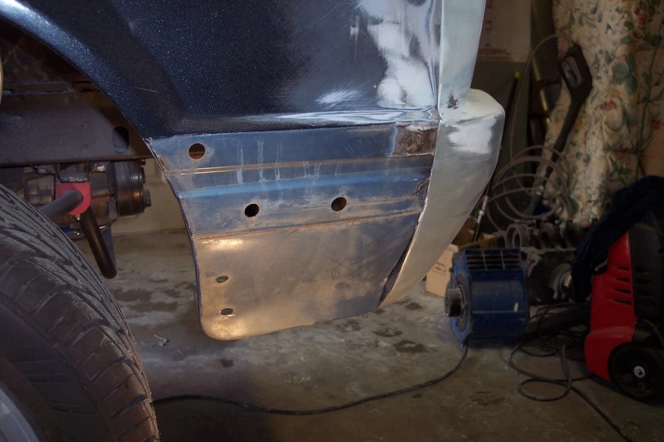

But first I had one last fabrication hurdle to clear. The front lower valance and the front fenders don't like each other at the bottom. The 68 lower valance is curved, and the lower fender w/o the extension is concave.
There is a significant mismatch and the thing is full of holes for the fender extension.
Now the hacker in me wanted to fill the damn thing w/ filler. And after arguing w/ Mr Hyde, the good Dr jeckyll prevailed.

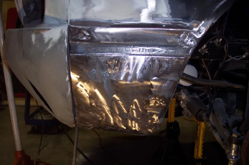

So I cut the front edge and "convinced" it to follow the same radius.
(I know, it's from the other side, but I didn't take any pictures of the side before I started changing things.)

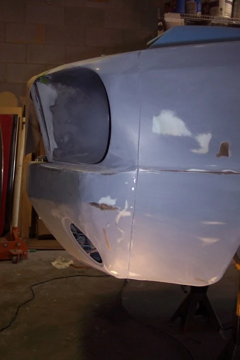

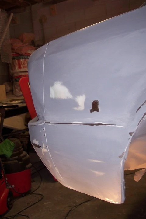

After the requisite 50 lbs of bondo, and after sanding 48 lbs off, it looks something like this finished.
So now for the primer part.

Cheap Epoxy primer sucks! It took me about two hours to wet sand off the hardened concrete. I will not be spraying coat #2 with this junk, and will be investing in a 2k poly to finish.

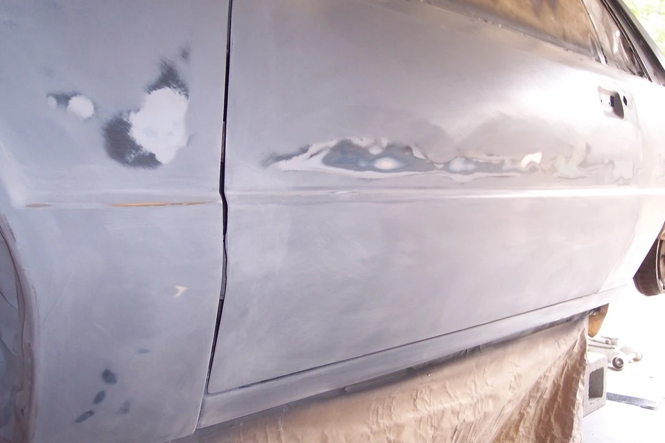

For those of you that don't know. There will be no body side molding on this car. I filled it. In it's place will go a 69 mach 1 factory stripe.
So if you ever imagined what you car looks like w/ that channel filled in it looks like this.
I know that the light in the garage never shows any detail, but I've managed to get the quarter pretty OEM looking.
