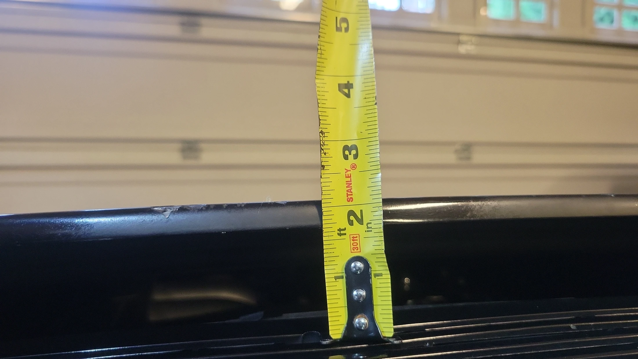

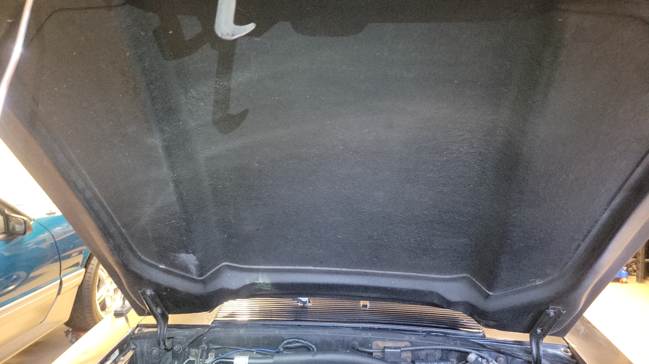

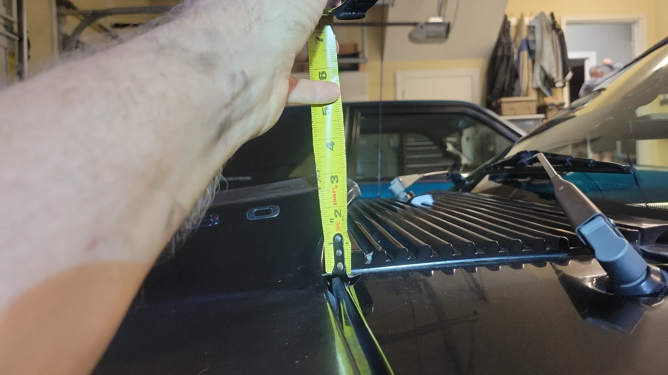

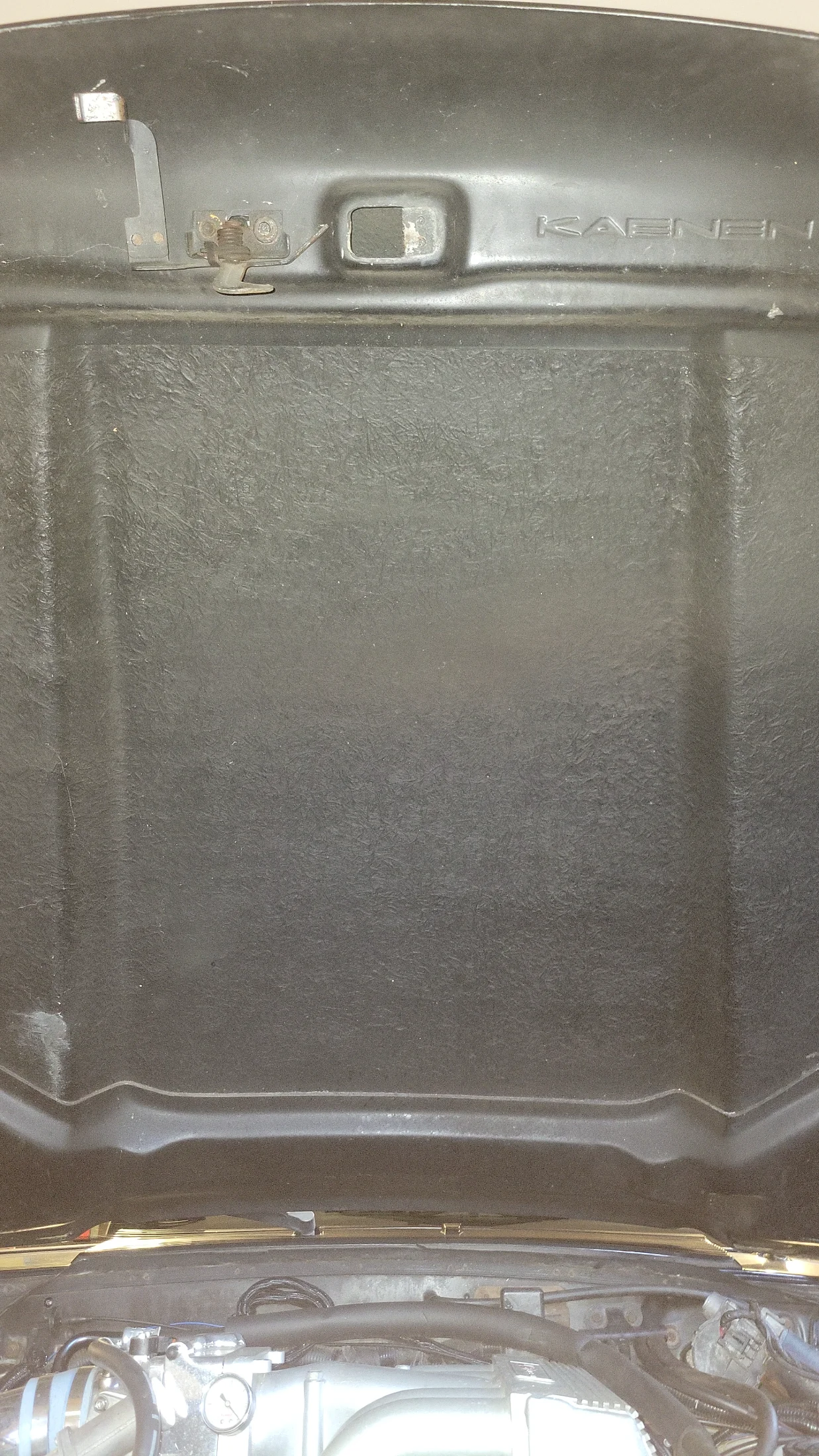

All I can tell you is that I used motor mounts that brought the motor down, and I have a 2.5" kaenen cowl hood. It barely fits. That's with an 8.2" decked 302. The RPMII would fit under a stocker with a 302. With a 351 and a TFS R, you'll need plenty of room, but I have no idea which hood the stalker is, and unfortunately don't have time to do the research. Hopefully someone else here has tried. Good luck!

Yeah it's the cervini's stalker ram air hood and a 2 to 2 1/2 raise. The rpm 2 is about 5/8 inches shorter than the box R and I like the rpm 2 on my 302 so I may just go with the 351 one. If I have to notch the hood where it's hitting I'll do that. And I don't Wana bring the motor down and have LT ground hithing issues
