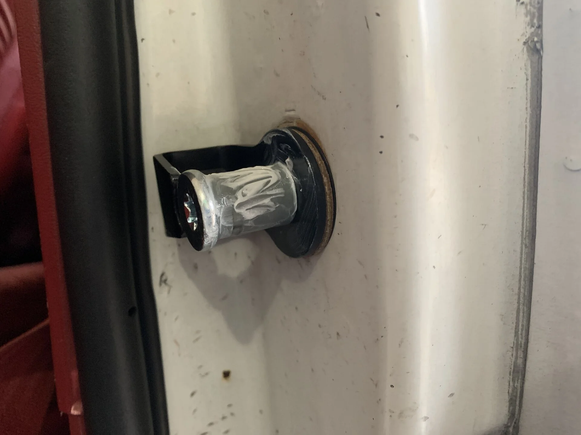

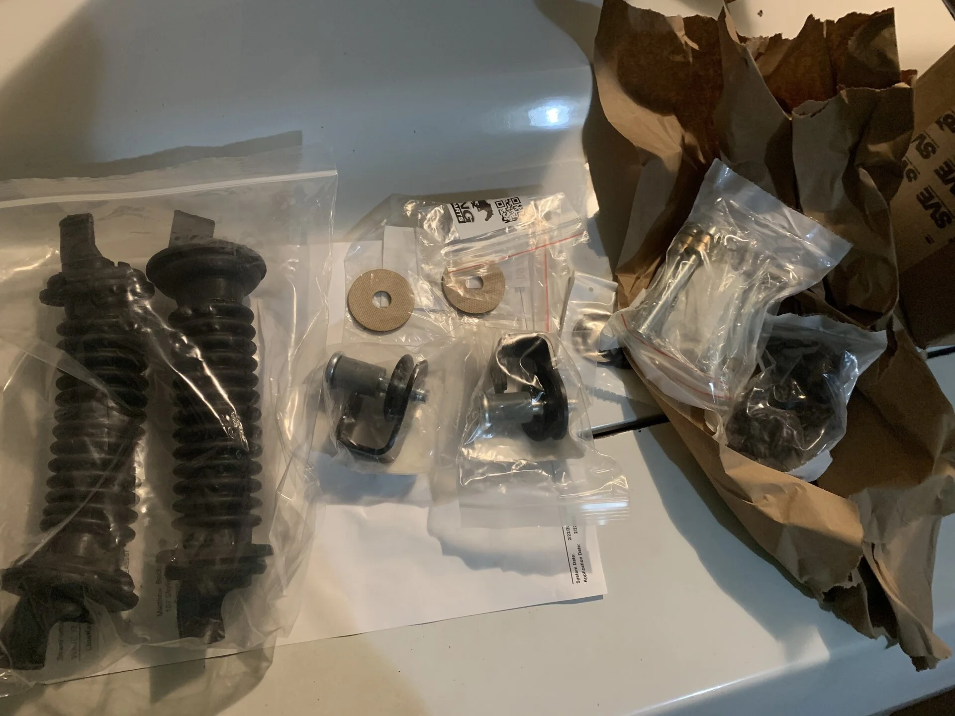

So I got a few parts in the mail a couple of days ago. I wanted to try and start working on getting the door aligned (I think I mentioned this in my latest video) so I went ahead and ordered the inner door renewal kit. After watching some videos, it seems this won’t be particularly easy but that’s fine.

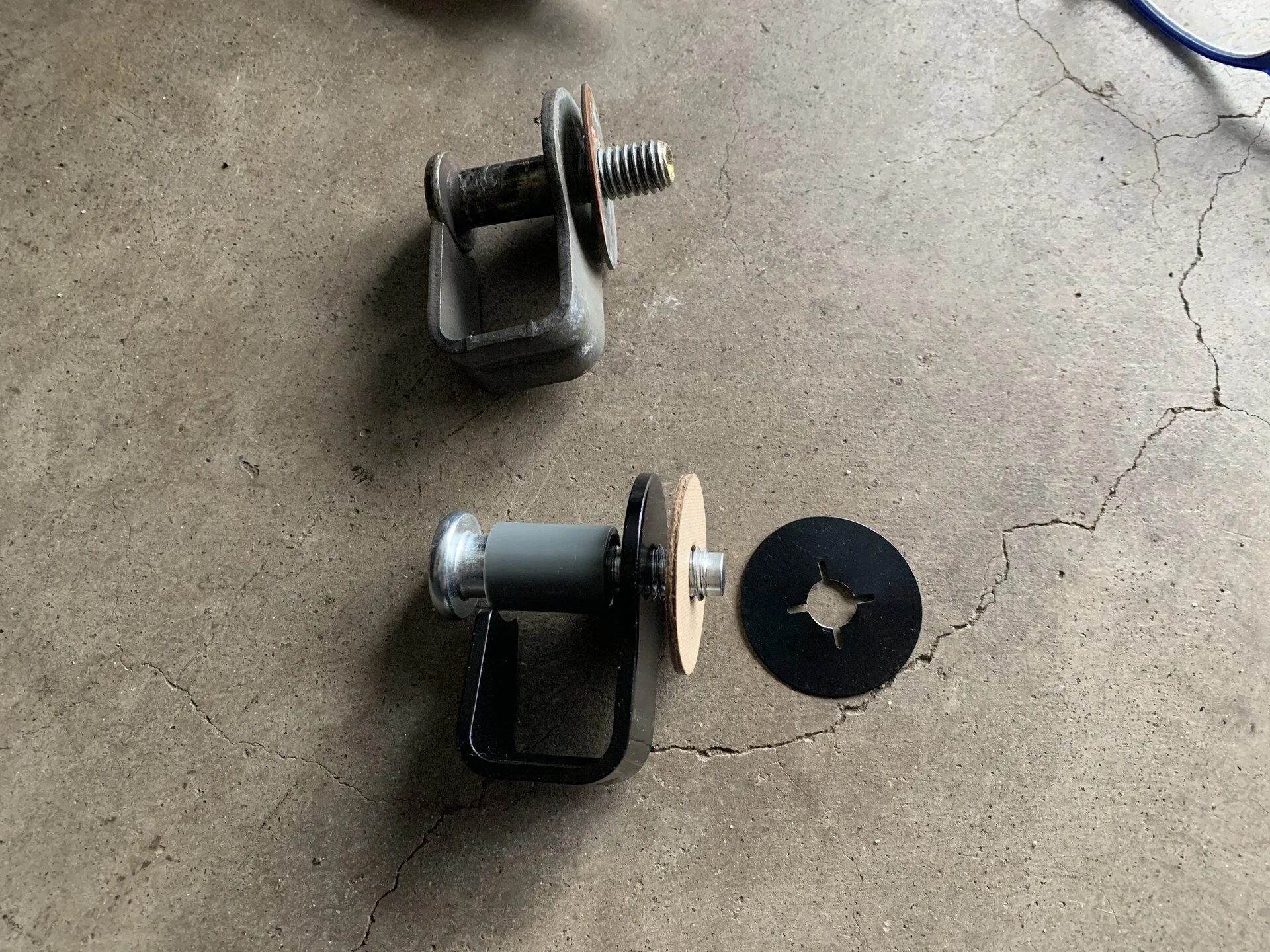

So naturally I started with what I thought would be the easiest part - the door latch strikers. I had noticed recently the bushings were missing on mine anyways. So I got the new striker installed on the driver side with the spacer (the cork/beige looking washer, followed by the lock washer (it doesn’t have any parts list in the box so based on the LMR video, Im assuming the black piece is the lock washer).
I threaded the new striker in by hand, lined it up, and tightened it with a wrench. I also put a little grease on the washer. Here’s how it looks at the moment.
The first time I closed the door, it closed fine and sounded good but then I couldn’t open it. I had to go around to the passenger side, get in, hold the inner door handle open and push hard on the door to get it to open. I have tried closing it and opening it multiple times with mixed results. Sometimes I can open it on the first try...sometimes I have to pull on the door handle really hard like 5-6 times before it opens.
Anyone else experience this after adding new door latch strikers or even just the bushings?

Ok, so I just sprayed some WD40 in the door latch assembly and now it seems to open every time on the first try but it still seems I have to pull up a little harder on the door handle than I’m used to.
DudeStang
Nuts fell off while driving
5 Year Member
Apr 30, 2017
619
337
83
Try moving the striker out just a tiny bit, if you continue to pull on the door hang hard to open it will break, same with the inside handle and it's plastic.
Thanks. I played around with it a little bit. Now it seems to open pretty easily, consistently...but it’s really quiet, whereas the passenger side makes a pretty loud click sound when I open. If this doesn’t make sense in writing it will make more sense in the video I’m working on hopefully.
I haven’t changed the passenger side striker and it is also missing the bushing. Is the door supposed to open quietly? It seems I’ve been so used to the loud clicking sound that it feels normal to me...and the quiet opening makes me think something is wrong. :chin
