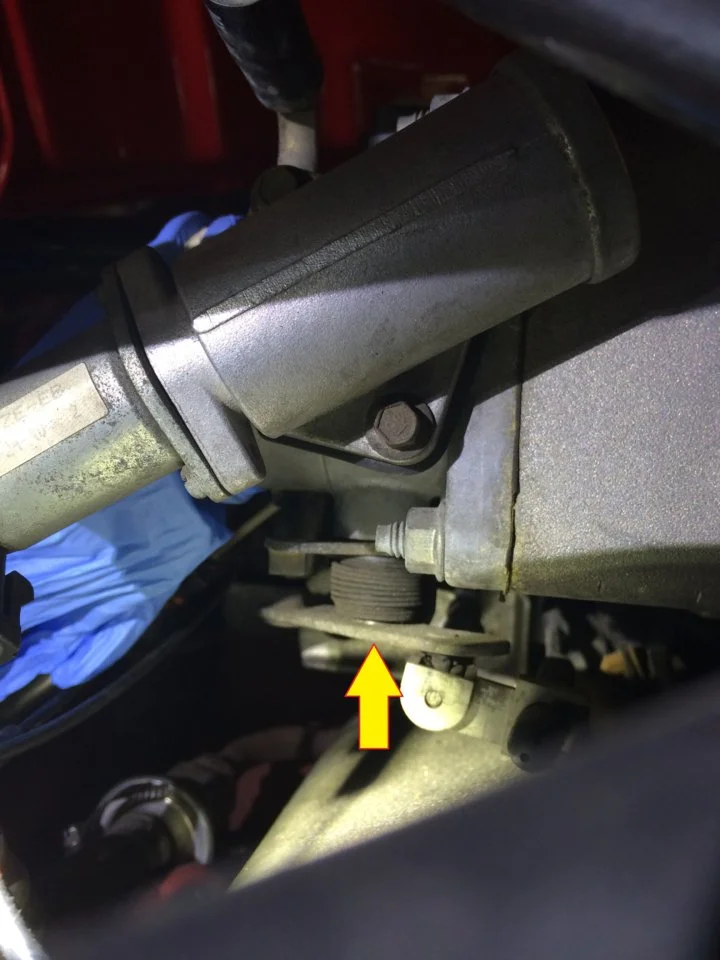

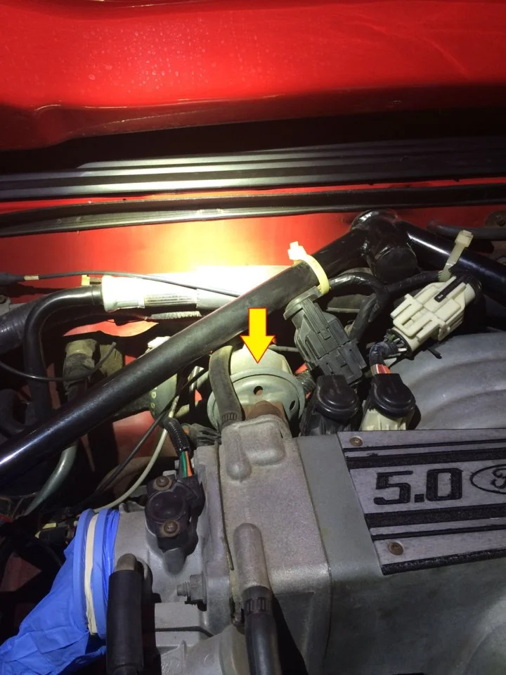

My check engine light will come one, then go off, and back and forth for about the first 10 miles when I'm driving. I noticed this new problem after changing plugs and wires. While changing those i found a broken vacuum line on the passenger side. The little grey one which comes out of the center of the vac block just behind all the air intake piping. I patched that vac line up with an over patch and sensor safe silicon.
