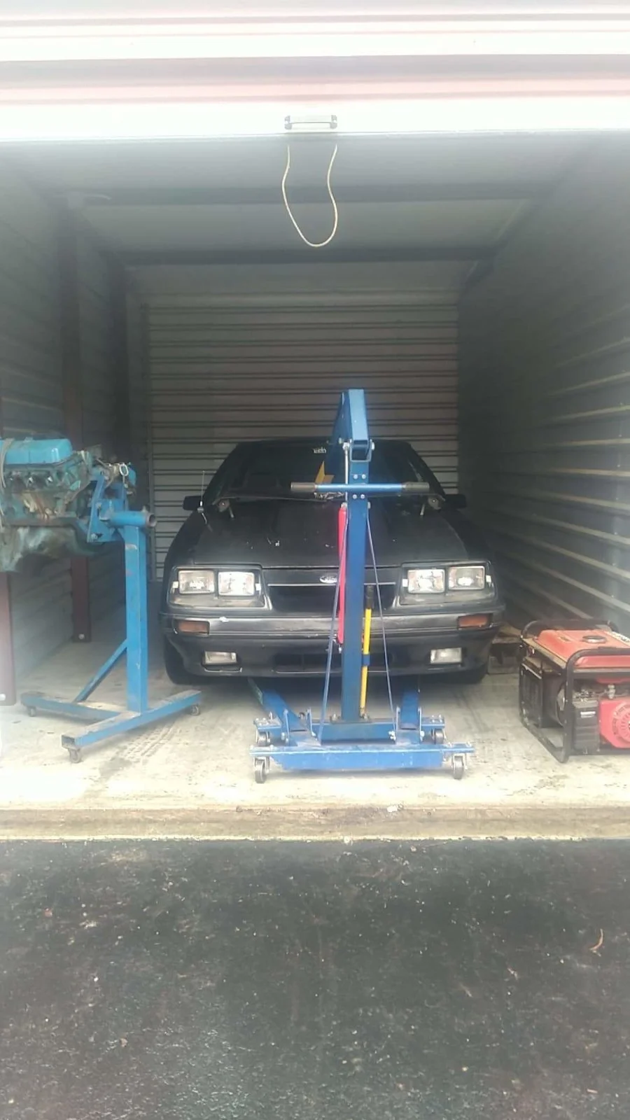

Swapping a 351c into an 85 4 eye
Now im no jabroni with tons of cash, car is garbage and the motor isn't. The hottest in town
I'm not going for maximum power
Not maximum cool factor
Simply putting big motor into small hole
Couple of questions
I'm using the t5 still what do I need to get to match we up to the 351c I've read mixed things
Anyone have a oil pan for the cheap or recommend one. I'm not lowering the k member or anything extra like that.
Also the car is getting turned into a rally car so aif anyone knows what kinda springs/struts I can throw under her to raise her up thatd be cool
Thanks gents
-dumbguy

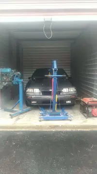

Also neglected to mention since we sold Our shop most cars went to the home garage so I'm doing this swap in a storage unit
Surprised they let you work in the unit. I know when I kept my car in one a few years back they were big on making sure people weren't working on cars that were stored in there. I did it anyway...but small things
