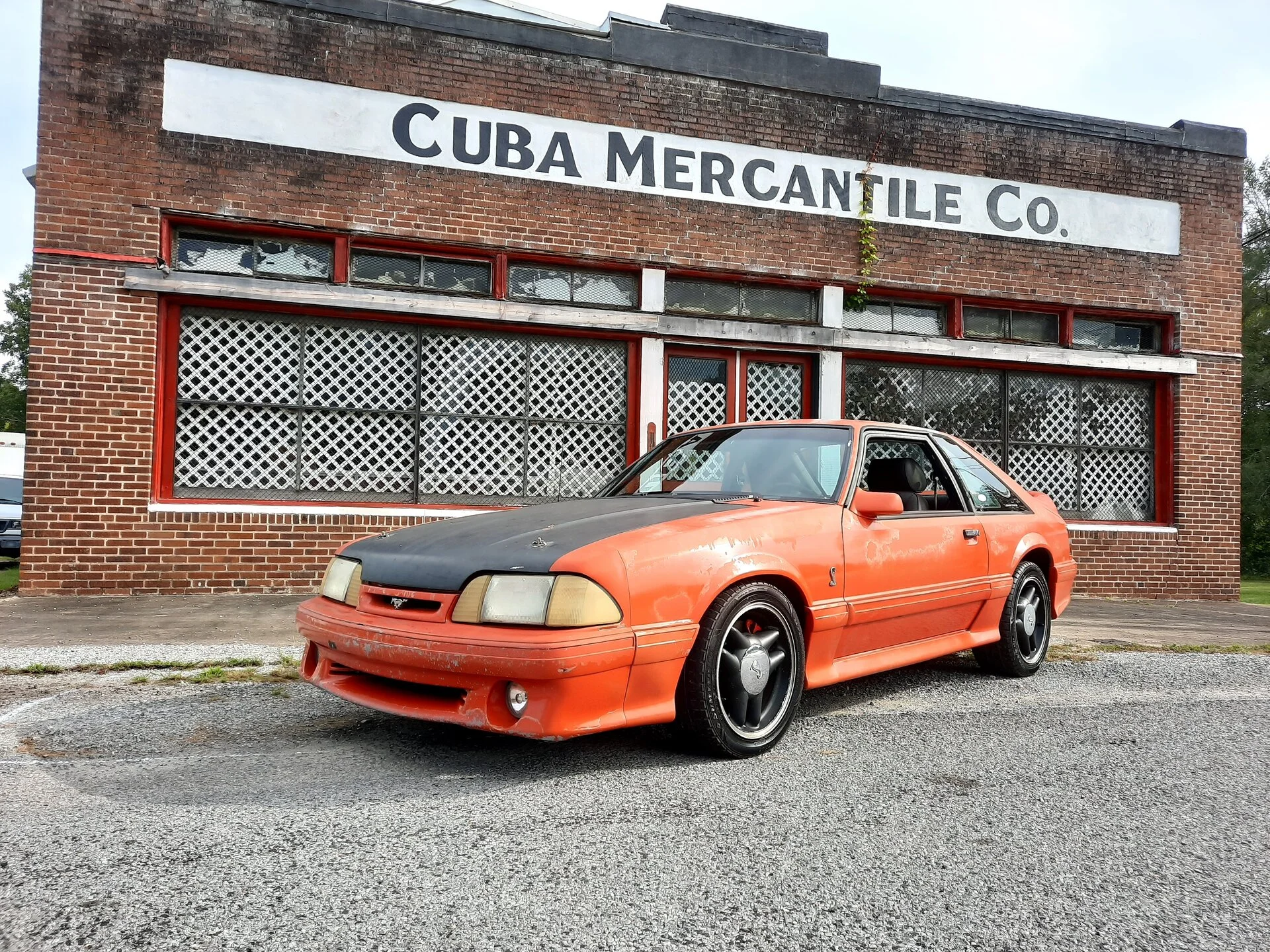

I run the same wheel. I have a brake kit that LMR used to sell but doesn't anymore. It came with the 94/95 spindles and '04 Cobra brakes. My fronts sit almost flush. The rears are another story.
