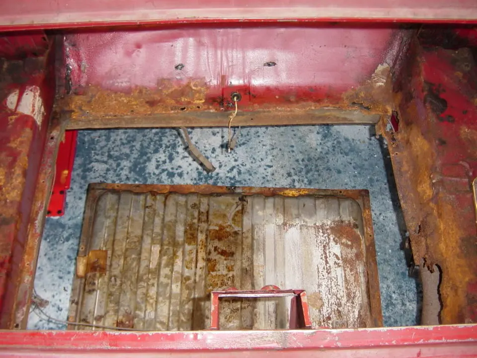

Can anyone provide a location for the fuel gauge wire in the body? This is where it exits the inside of the car drops down to connect to the sending unit. Im assuming the body shop forgot to put it in.
It's up after it transitions to the diagonal. It looks like the picture is showing a crossmember under the car. The lip that should be supporting the tank appears to be rusted off in the pic
