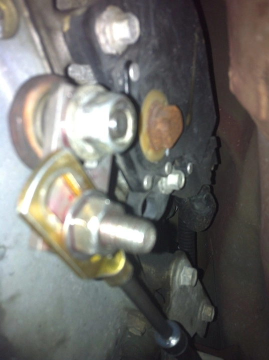

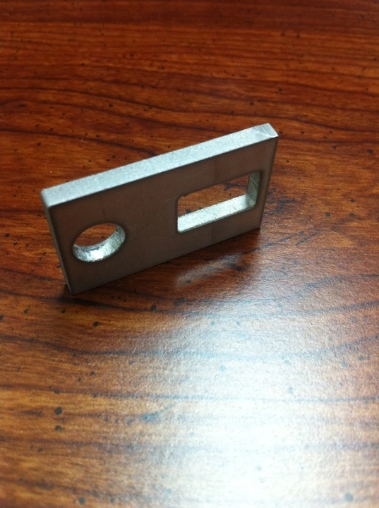

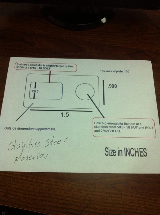

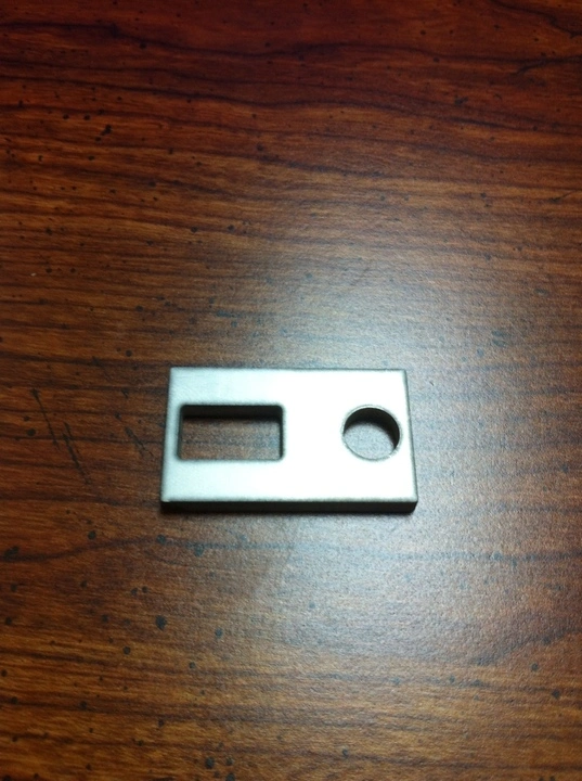

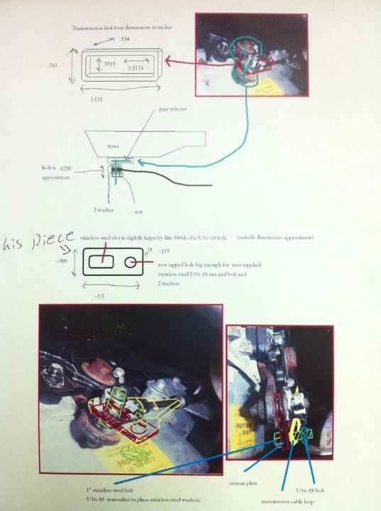

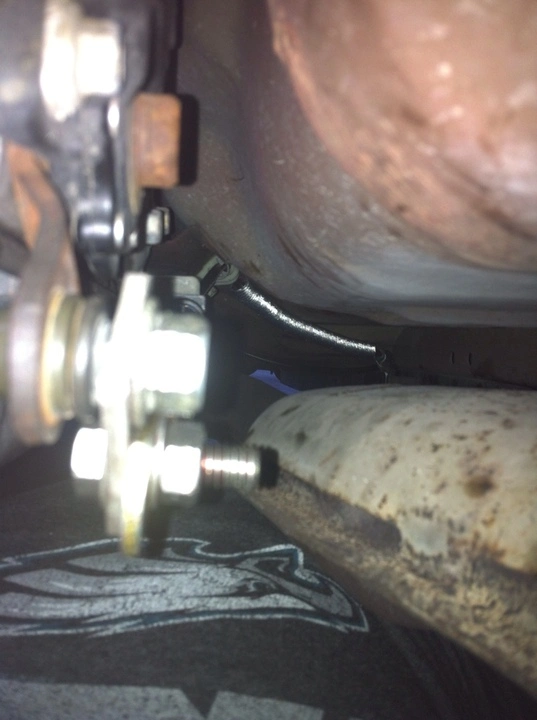

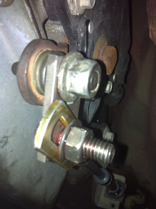

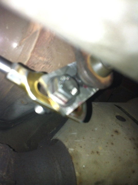

I recently installed B&M hammer shifter on my 01 GT but it will not go into PARK !!!
I've read several things about getting a dremmel and in the shift link loop hole making it bigger.
HAS ANYONE DONE THIS? Any pics will be greatly appreciated.
I've read that it's that the cable is not long enough any steps so that I can make this shifter work 100%
It will be greatly appreciated.
If you have this and you have fixed this issue what did you do? If you can take a pic i will thank you for ever.
THANKS
