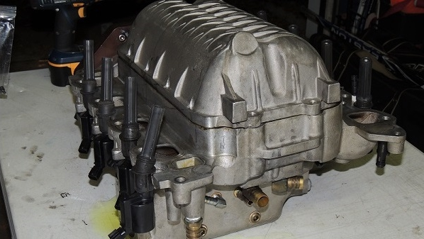

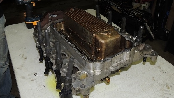

First thing Remove the whole blower and intake
Remove Filthy Intercooler

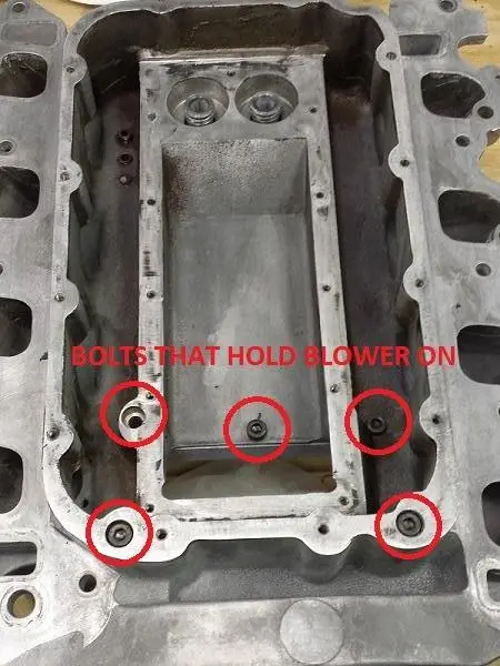

Remove Blower

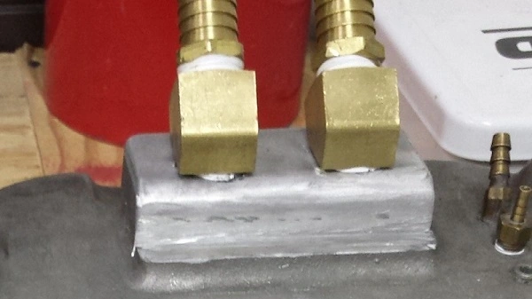

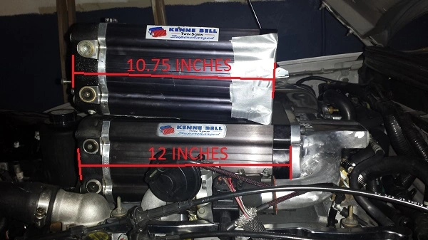

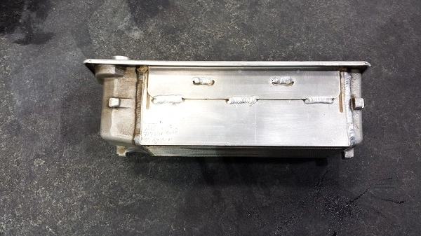

A huge problem with this, is that the 2.2 is 1.25 inches longer than the 1.7. That causes the new cobra inlet to hit the rear intercooler fittings. I swapped out the intercooler fittings that were 90 degree to 45 degree fittings to make more room.
New fittings and I also ground down the front of the block they go into for more clearance

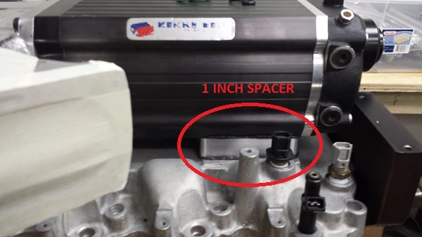

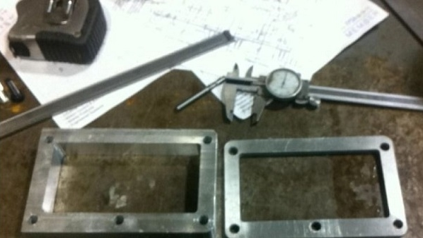

Another HUGE problem is that the 2.2 or 2.6 kit you would buy come with a spacer. That is the reason you have to have a cowl hood. I bought a .25 inch spacer for a template then had my buddy make me a 1 inch spacer. Even with this it BARELY clears the fuel rails.

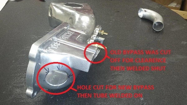

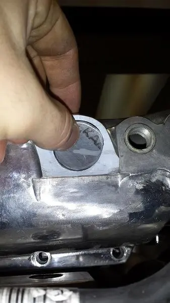

Next up... Inlet - the bypass on the cobra and gt are different, so we had to mod that too
Had to get the cobra bypass welded shut
Pic with spacer installed
Clean intercooler, this thing was disgusting

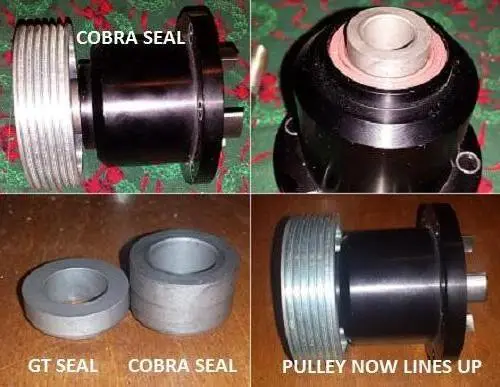

The snout that was on my 2.2 wasent for a gt so i had to order a new seal
Remove Blower
