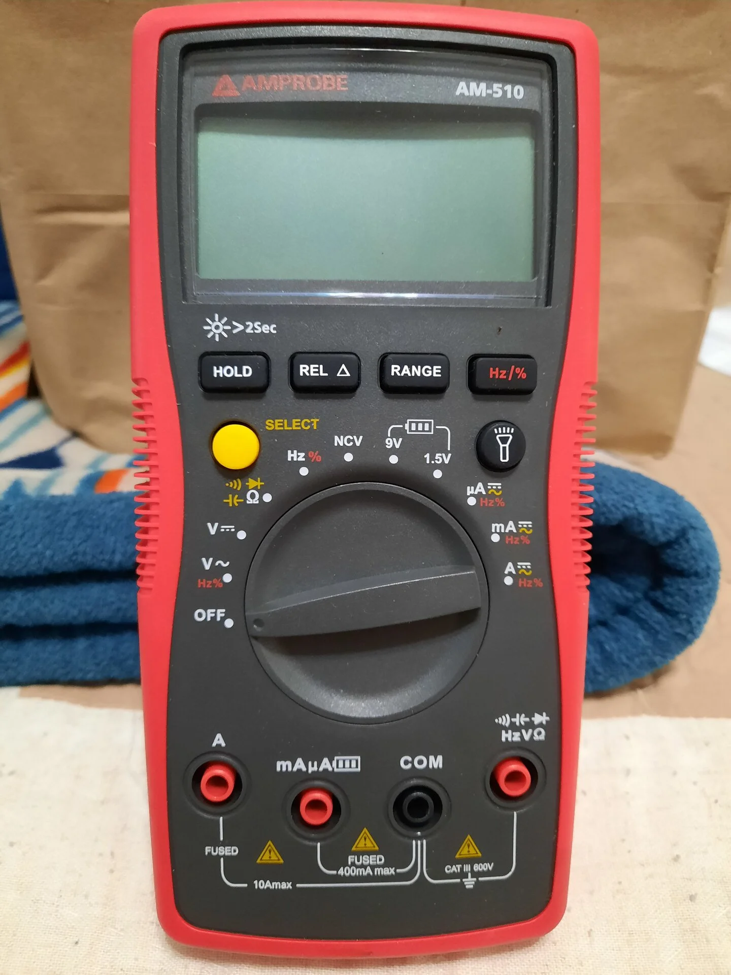

Wayne Waldrep
Before I post a pic, do you have one of yours?
Apr 14, 2003
1,251
688
143
56
Cuba, AL
I have this one and it's great. Very well made. And it's $40.
Reactions: 1 user
