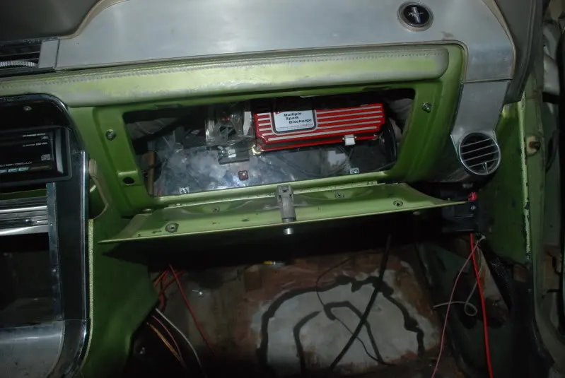

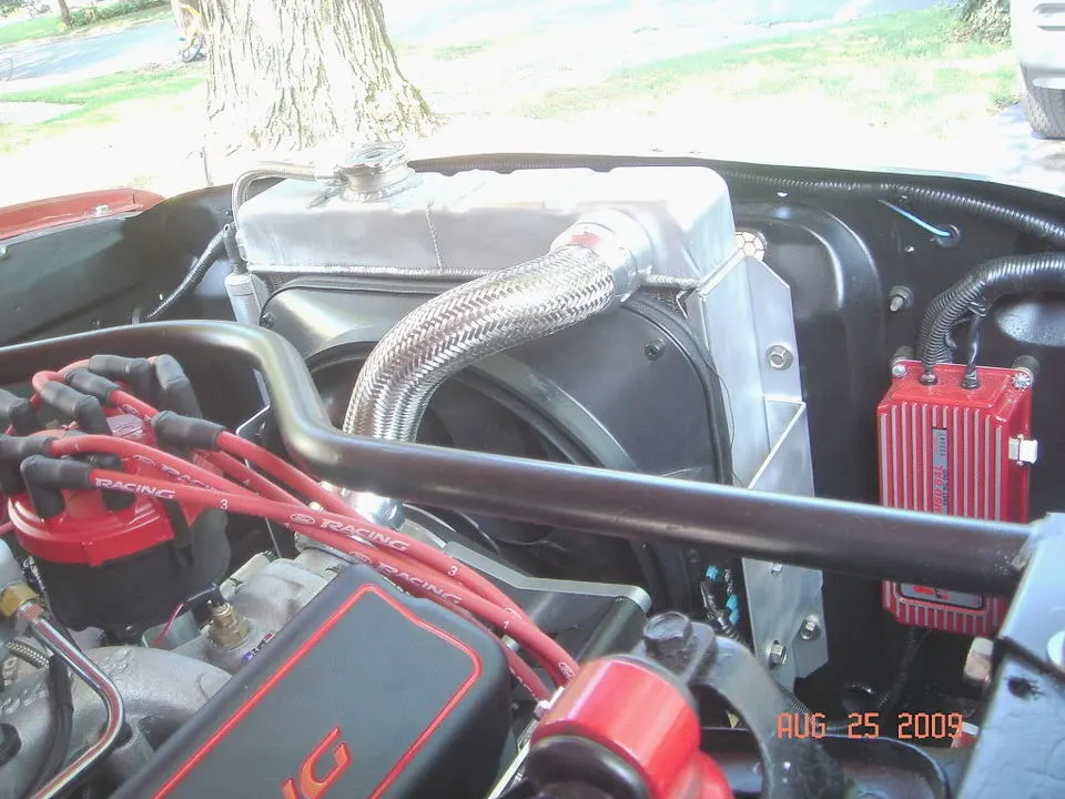

I mounted my MSD where the windshield washer tank was. Ran the battery wires the same way the voltage regulator wires are run, and tied to the M/C bar for the distributor wires.

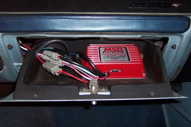

I put my battery in the trunk, mounted MSD and a tach adapter to work with my repro rally pac tachometer in the recess on the fender side of the battery area...

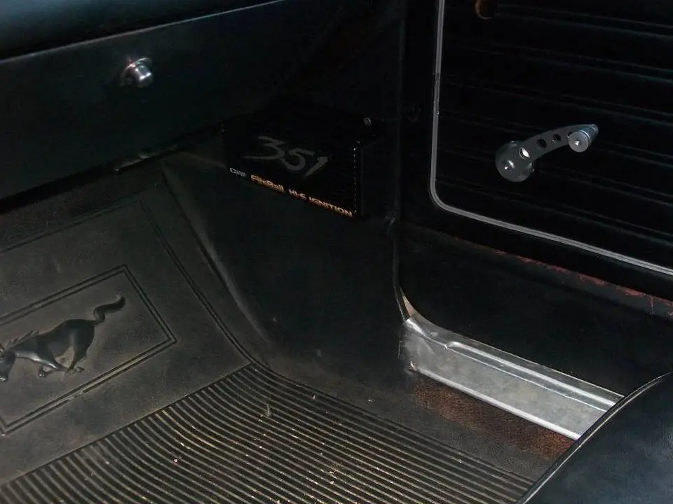

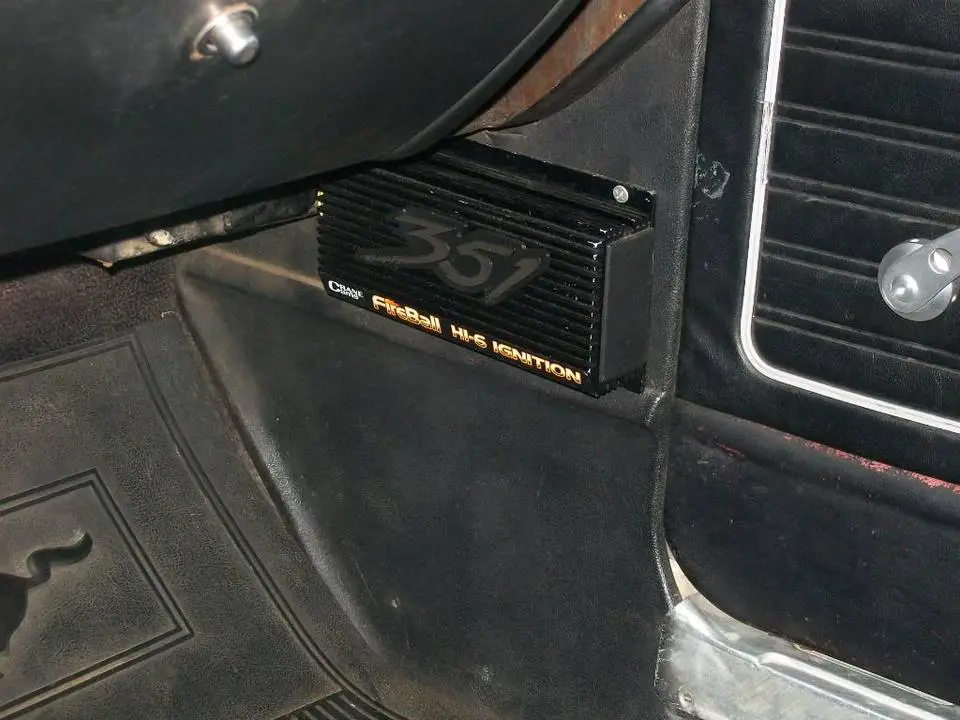

My old one was on a home made bracket in middle of the firewall. I don't think I have a pic handy right now. With a turbo under the hood I moved it here.

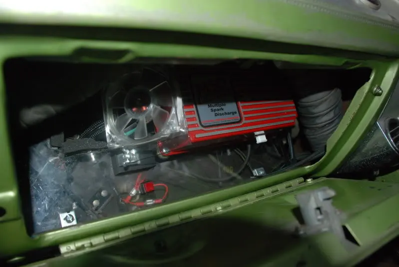

I mainly added the fan because I never got a straight answer as to how well the MSD boxes handle enclosed areas. I spoke with an MSD tech on the phone who said the mounting location would be ok and shouldn't do any harm to the box even though it says in the manual that they do not recommend glovebox mountings. So basically I added it as an extra precaution against overheating. It's just a computer fan.
