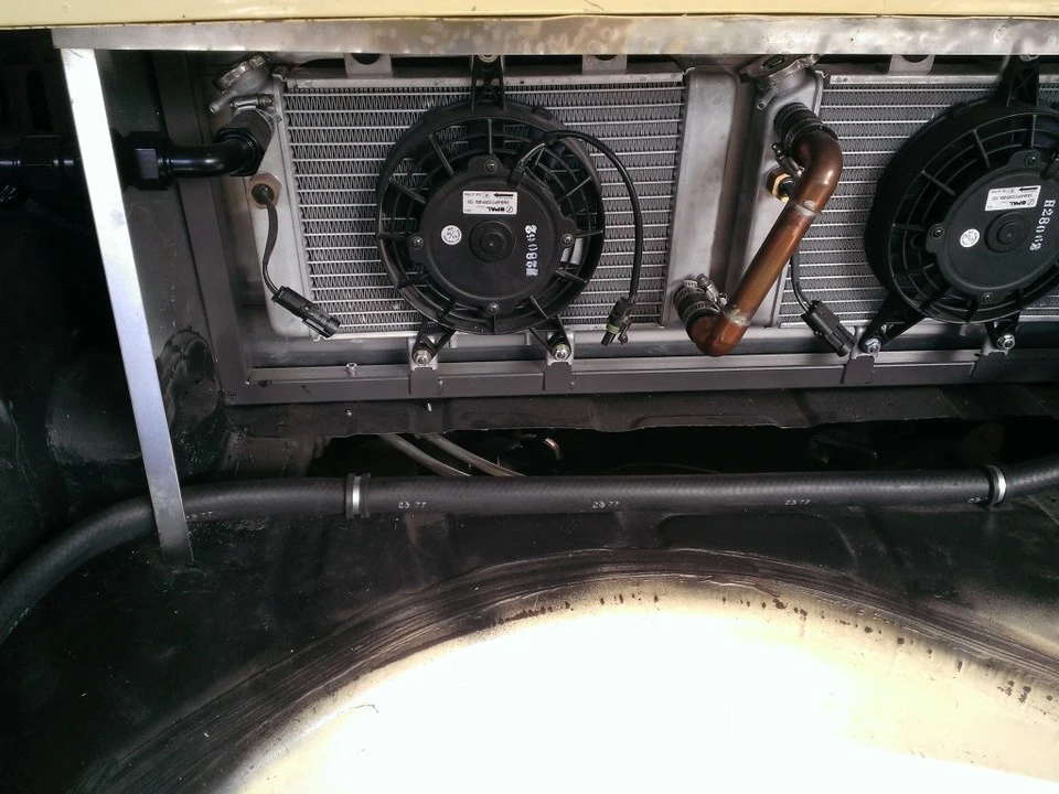

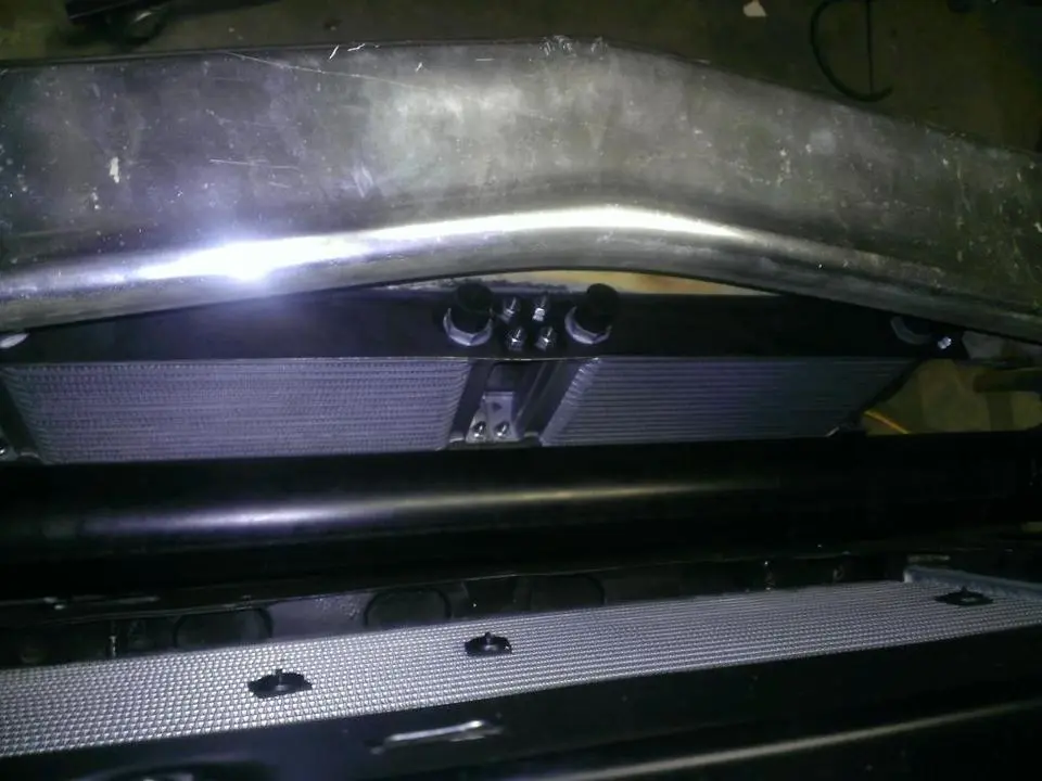

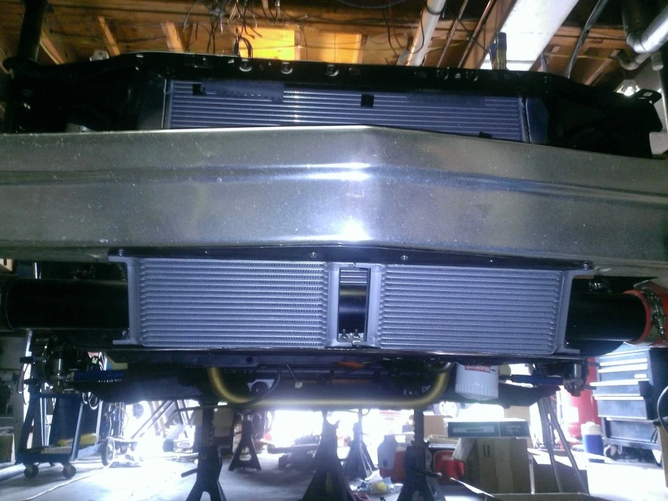

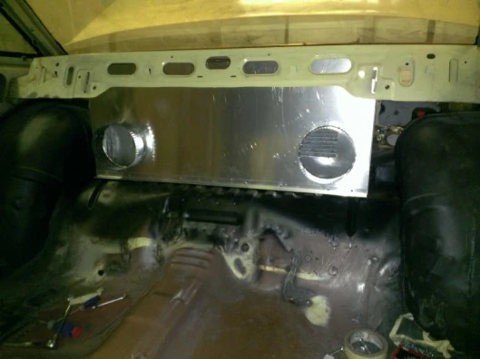

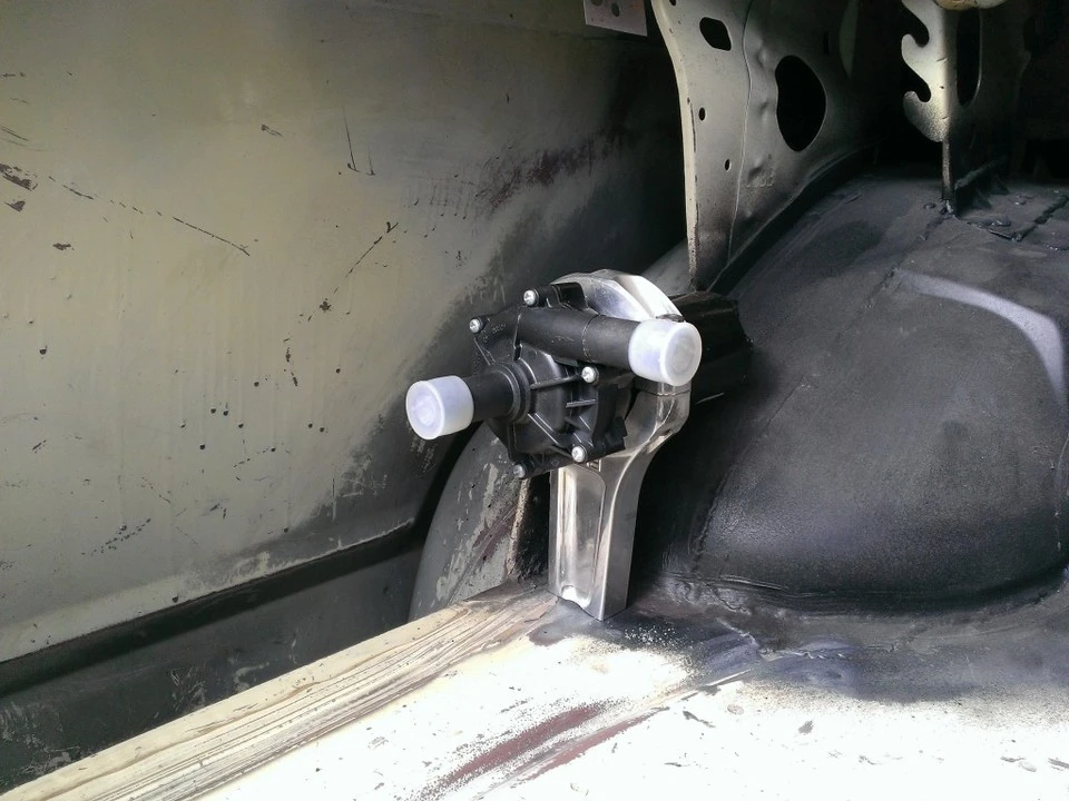

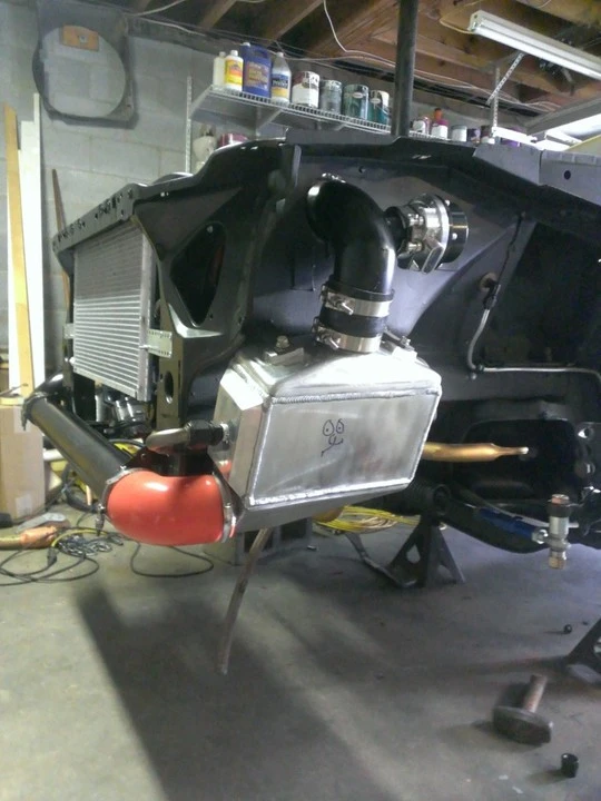

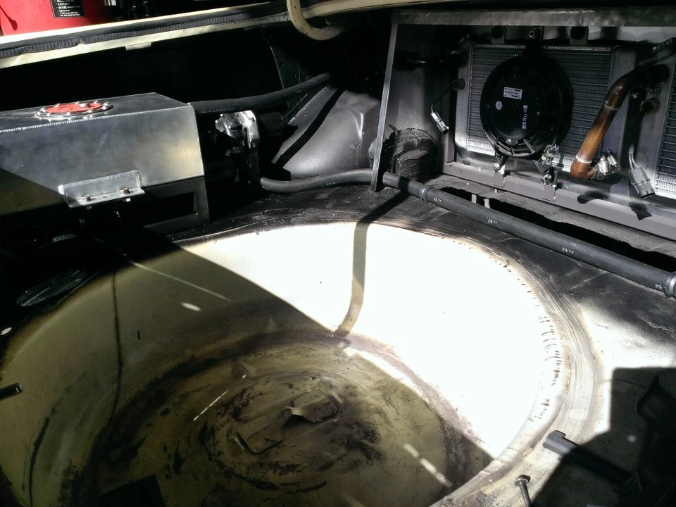

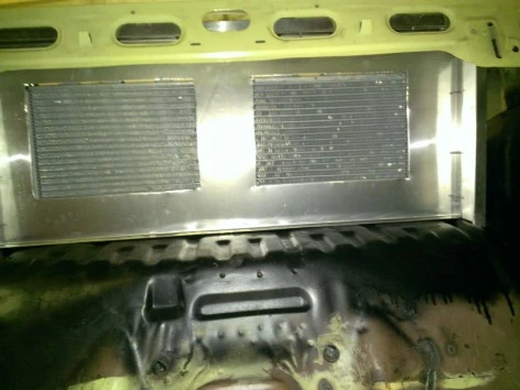

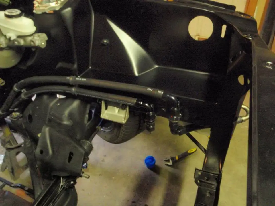

Anybody who has looked in on my build thread knows that I have this elaborate, rear mounted heat exchanger w/ a 3 gal water reservoir, and a Bosch recirc pump running water to a front mounted A2W I/c mounted under the driver side front fender.

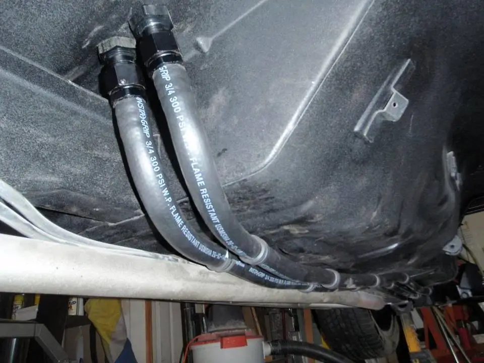

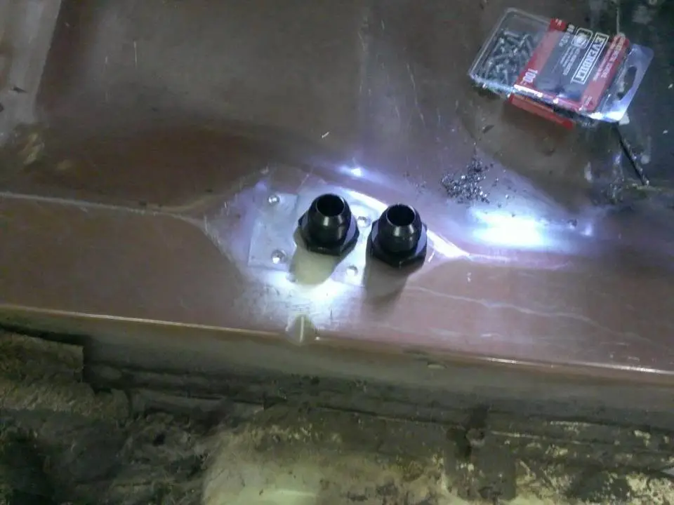

I'm running an inline F/I mallory pump that will feed pump premium through a -6 line, feeding (6) 60 lb EV-1 injectors, then return it back through a -6 return.
I'm concerned that that was not a wise choice, considering I want to drive the snot outta this car.
An A2W I/C in a closed loop system like mine will start to heat soak. Whatever the fans on those rear mount radiators are capable of cooling the water to will be the average temp of the recirculated water. That will be at least ambient, more than likely well north of that after I heat that water up when I put my foot in the throttle and boost starts coming online.

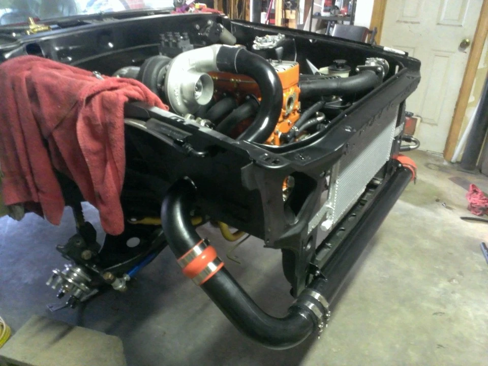

This being a weenie six banger, in order to make the targeted HP/TQ (which is low when compared to V/8 numbers) 400/500 RWHP/TQ, I'm gonna have to make alot of boost comparably speaking......like 16-18 P.S.I.

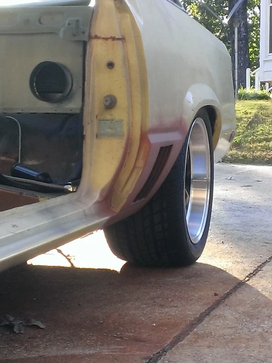

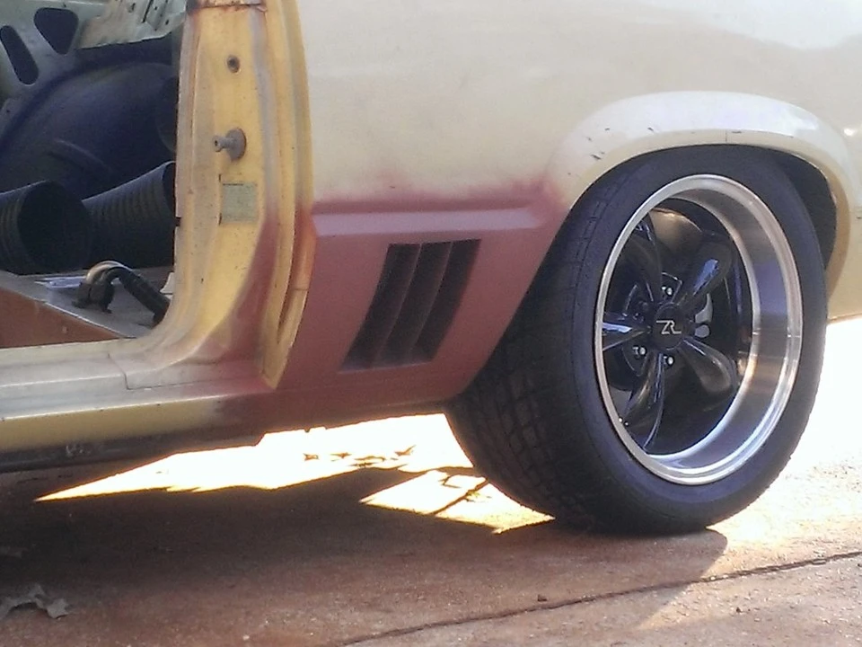

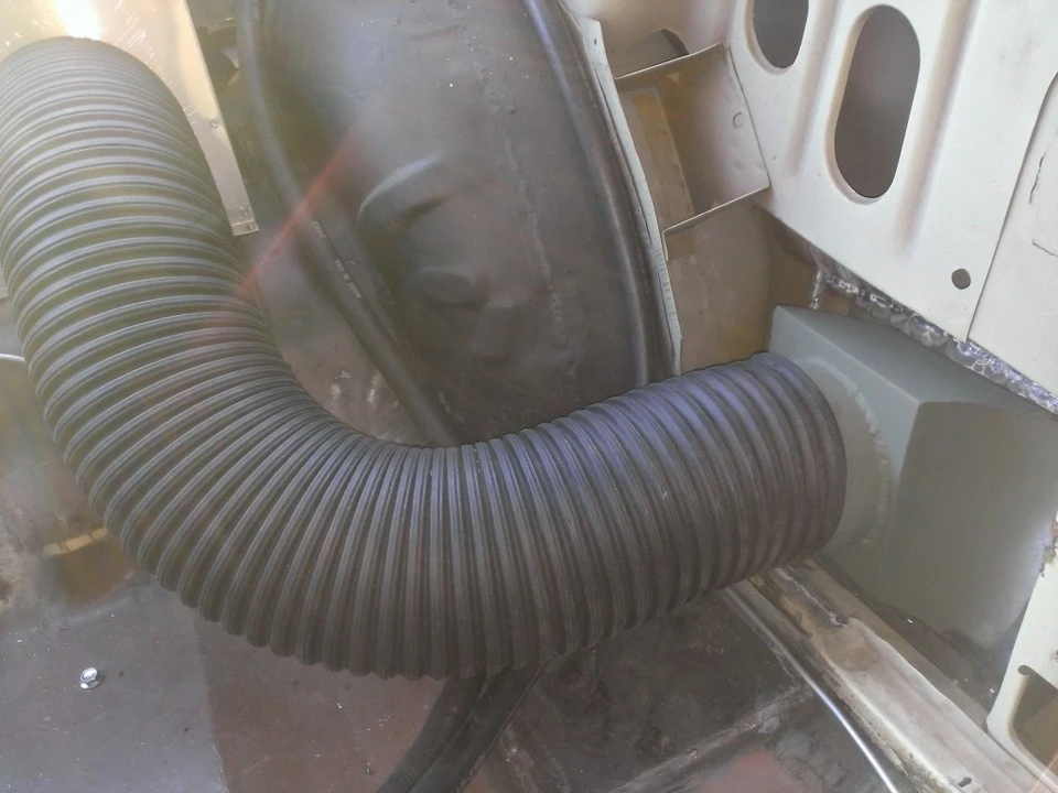

Air compressed to 18 P.S.I is hot, and the I/C may not be able to relieve that much of the heat once the water temp starts to rise in the closed loop. The heat exchangers get their air from "gills" that are molded into the quarter panels infront of the tires. One of these gills is done, the other, still needing to be built.
A2A is not an option. There is ABSOLUTELY no room in front of the radiator, or beneath the bumper to acommodate one of those big assed things.

As a precursor to all of this, the pump I have isn't capable of moving E85, so I gotta buy a new one. Additionally, I gotta increase the delivery line size up from -6, to -8. I don't know about the return line size requirement as of yet.
