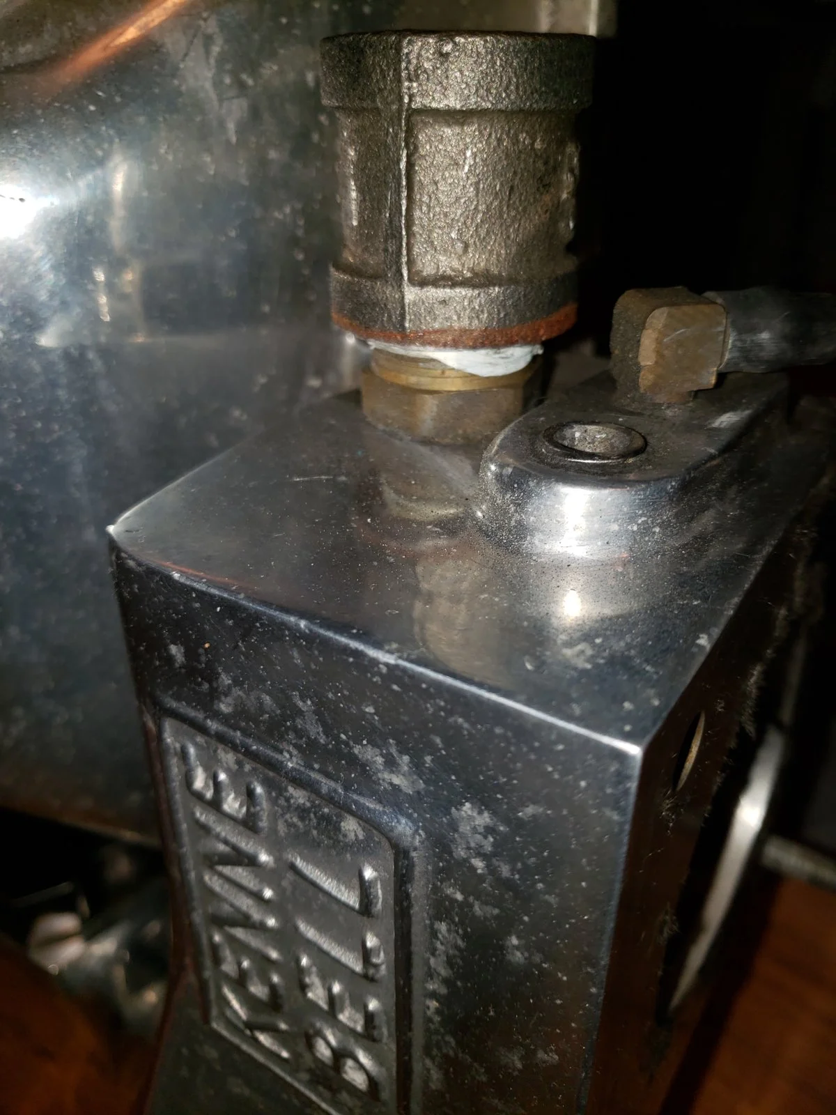

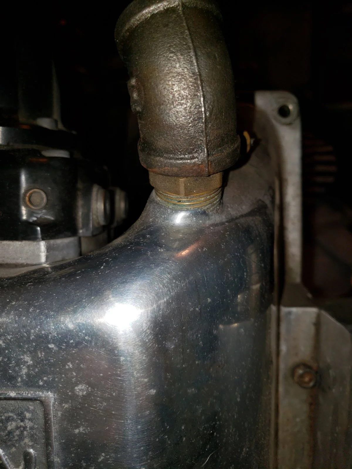

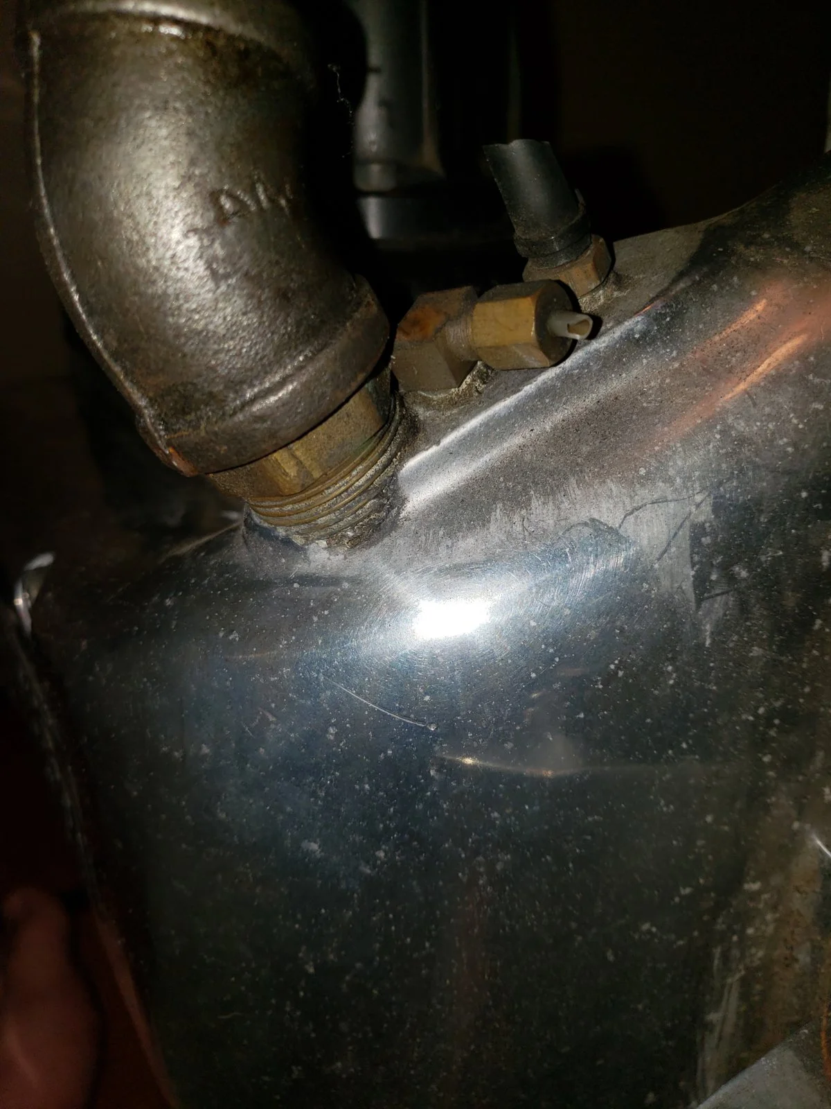

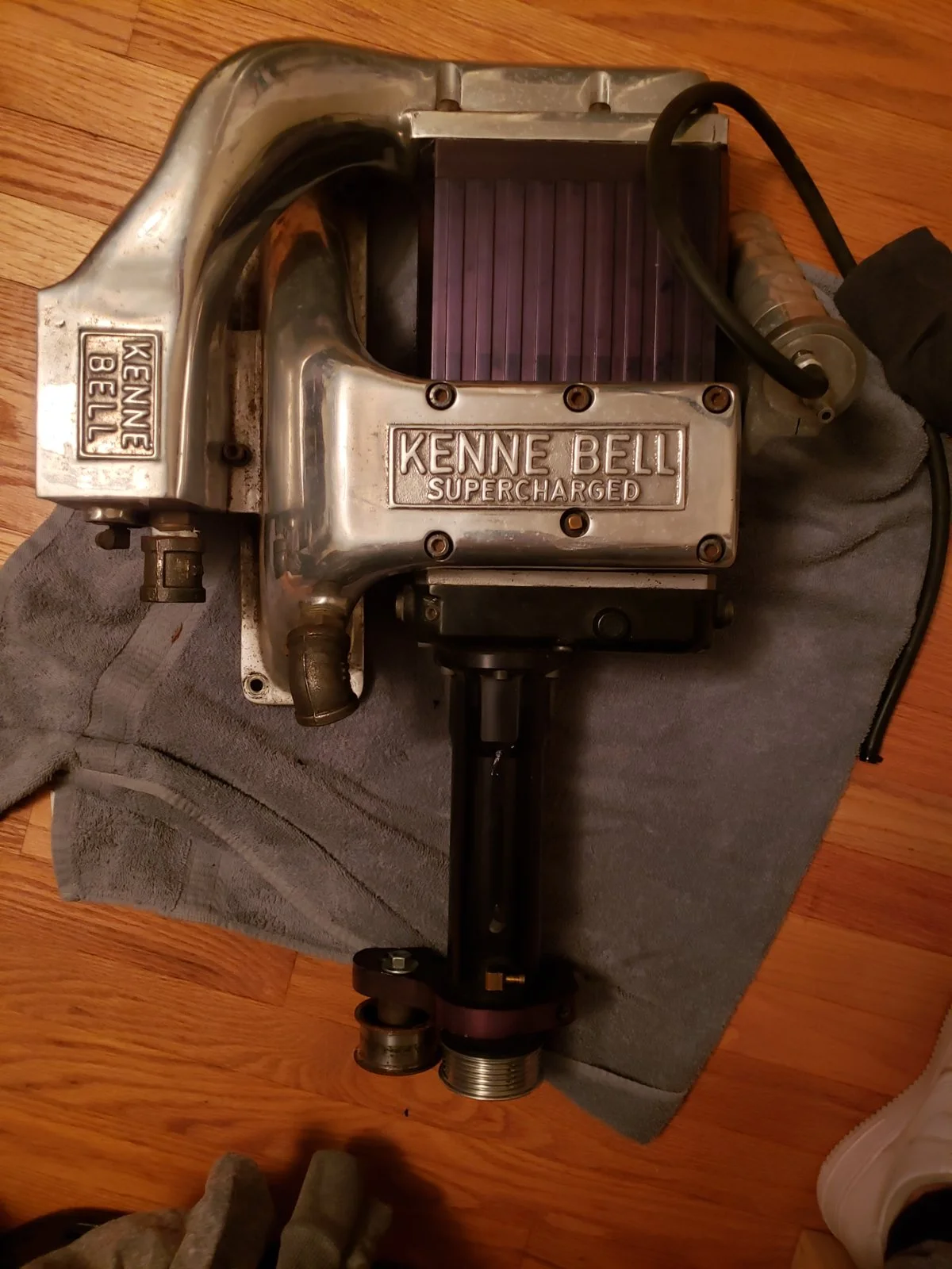

Hey guys. Just bought this KB supercharger for my fox. The seller said it was a 2.1 but I noticed the 1.5 and 2.1 look very similar. Anyone have some knowledge about these blowers? thanks.
Those manifolds are from a 2.1L blower. The manifolds for the 1.5L did not have the bosses for the internal bypass.
Your internal bypass is missing by the way. Looks like you're missing a couple of other items as well. Of course, none of those fittings came with the blower kit.

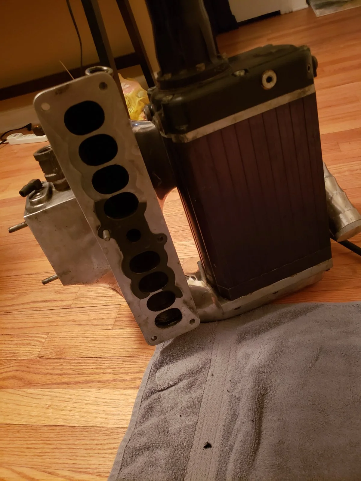

If you flip that thing over, the pressurized manifold should be setup to mate with a GT-40 lower.

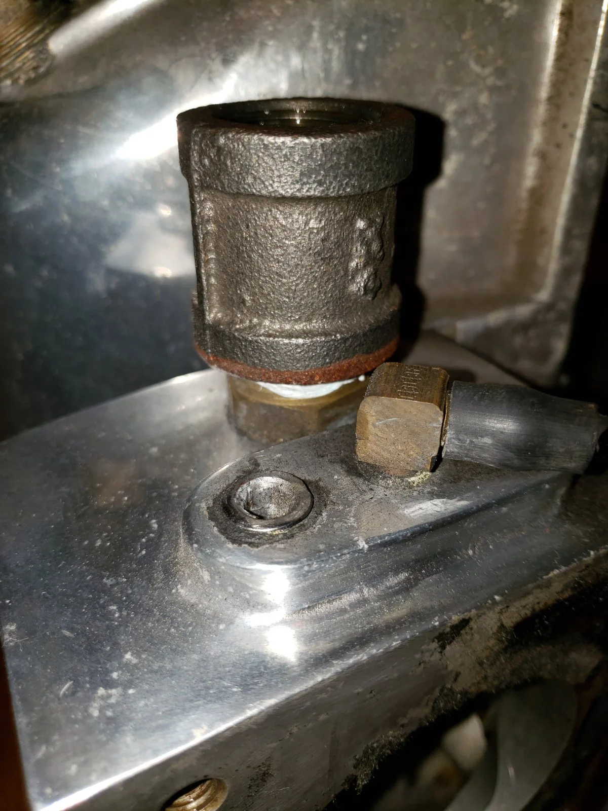

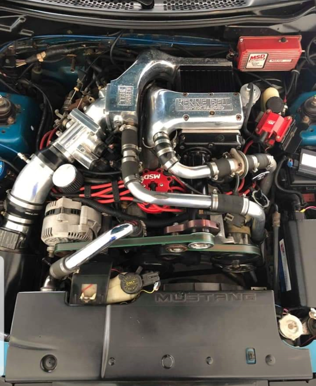

WTF is that? LOL
Looks like they rigged one up. That 'valve' just behind and inboard of the power steering fill cap, looks like a bypass that they rigged in.
Scared me when I saw your image was not GT-40 but your explanation makes sense. All of my hands-on with these blowers are the Fox versions. I don't know what all the changes were for the SN kits other than snout length.
so even though its rigged in like that, it would still work? and even without the gt40 lower youre sure its a 2.1? Its also intercooled

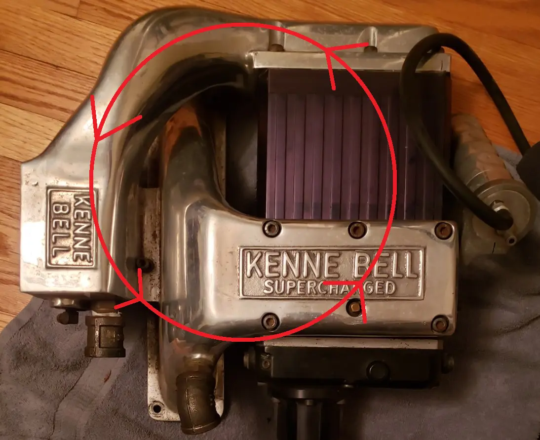

When the bypass in open in these, the air normally circulates between the two manifolds until the bypass closes.
Some folks as a result, think it's necessary (or maybe just want to experiment) with cooling the bypass air.
Normally, the bypass fits right between these two manifolds.

Still have the 94-95 snout by chance? Looking to put a fox setup onto my 94 and would need to swap the snout.Well I guess now I can breathe a sigh of relief that it's a 2.1. Maybe I'll buy some nicer fittings for it. Sorry if this is a stupid question too, I'm still new with this stuff, what's the internal bypass and what does it look like. Maybe the guy gave it to me separate. Also I flipped it over and it doesnt have the gt40 setup. I will note this came off of a 94 sn95
