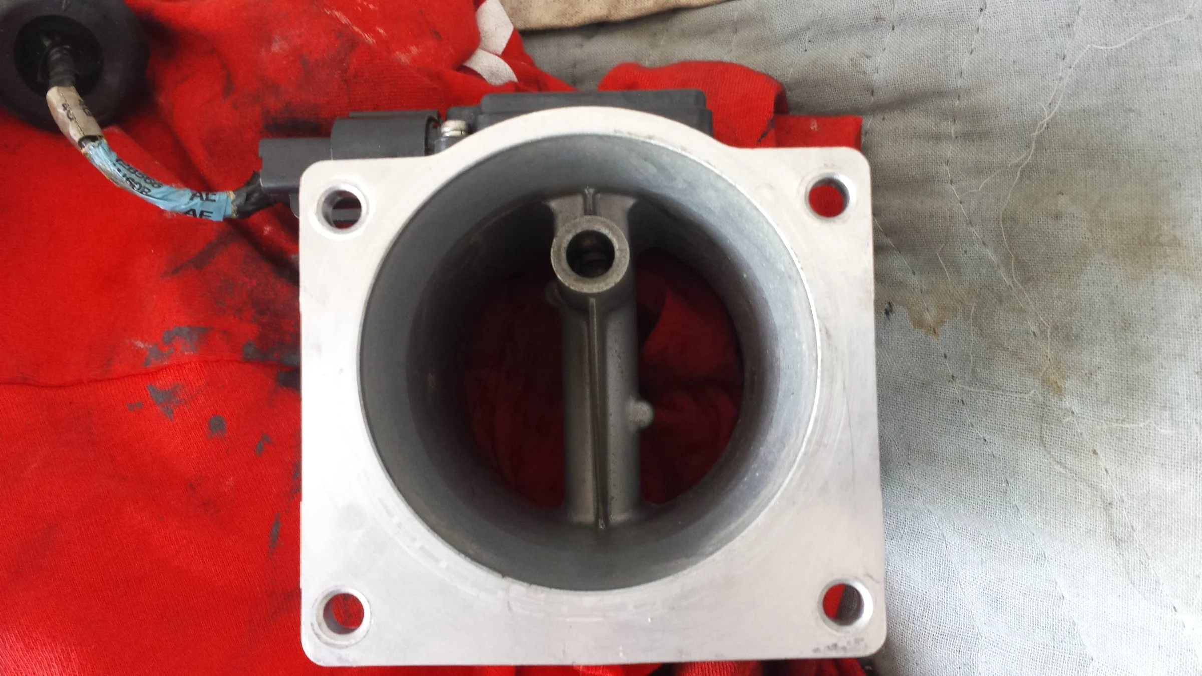

Hi, want to change my maf sensor for a bigger one the one I have is stock and I think is 55mm.
I read on some forms that the maf from a thunderbird will fit and that is a direct bolt on.
So I went and got one dron the junk yard today.
I got one dron a 97 thunderbird and I need to know if this will work with my Foxbody 93 with 19 lb injectors and if is a bolt on, I need to know if it worked fine and if I will have any problems?
Is my first time posting something here so just learning.
I really need your help .
Thanks.

I've never heard of a '97 Thunderbird one being a direct bolt on (doesn't mean is isn't) as those cars were 4.6L and I think all the 4.6Ls had 80mm MAF. However, the 94-95 GT meter is 70mm and is a direct bolt on.

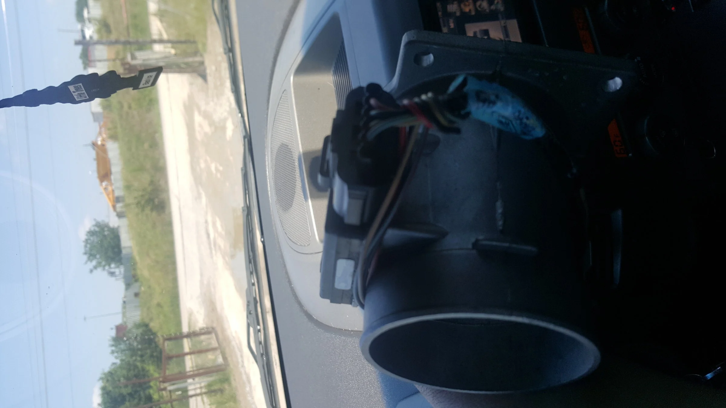

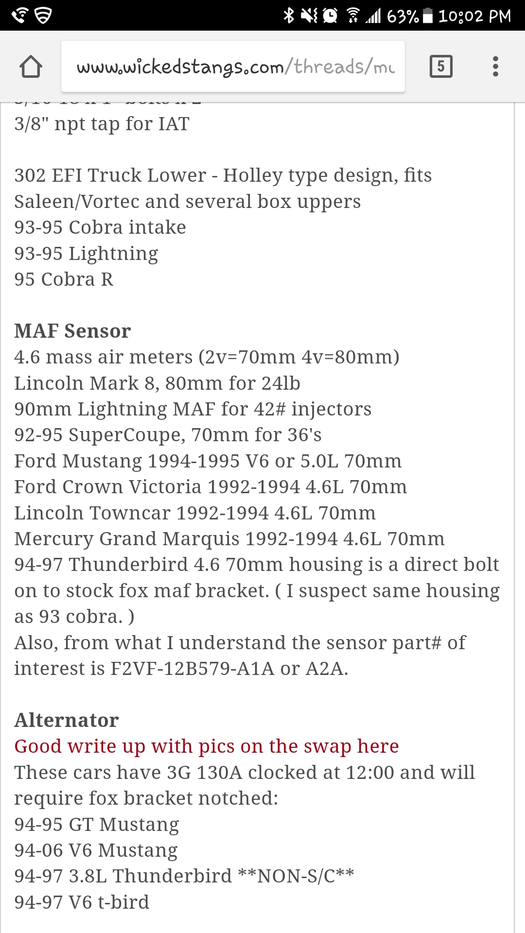

Here's what fits and I know that it works...
94-95 Mustang GT MAF - $40-$100. It is 70 MM instead of the stock 55 MM on regular stangs built prior to 94. This is a direct one for one swap that does not require any tuning or programming, It uses a slip on duct on the side that goes to the throttle body and a 4 bolt flange on the other. You need a flange adapter to fit the stock slip on air ducting that goes to the air box. Wiring plugs right in with no changes. *1 *2

Very interesting. The only thing I know about that from experience is that the '96-98 4.6L GTs and the '96-98 4V 4.6L Cobras both used 80MM MAF. Not the 70MM for the 2V and 80MM for the 4V like they state in that write up. I had a 96 GT and my friend had a '97 Cobra and both had the same meter.
Got anything you can measure the Thunderbird meter with?

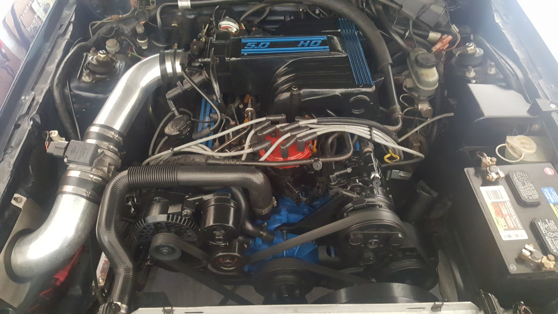

This is what I have done to the car so far ..
Gt40 heads, gt40 upper and lower intake, 65 mm throttle body and egr spacer, 19 lbs injectors from explorer, cold air intake, E-303 cam, exedy stage 2 clutch, underdrive pulleys, smoke pump deleted, long tube bbk headers, dual electrical fans, 130amp alternator,
I don't know how many hp I'm making right now I haven't dyno my car .
I don't wanna have a race car because I want to drive it on The street .. but I do want to have some power under that hood on my 5.0 .
So any suggestions on some other mods to get hp with out going wild I appreciate your help.
Thanks.

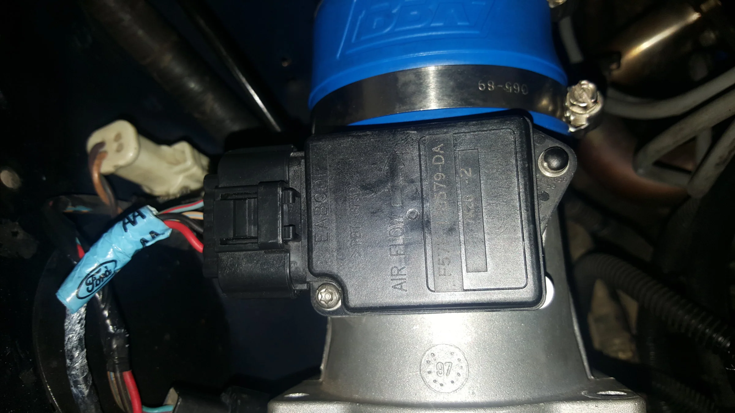

Jrichker.

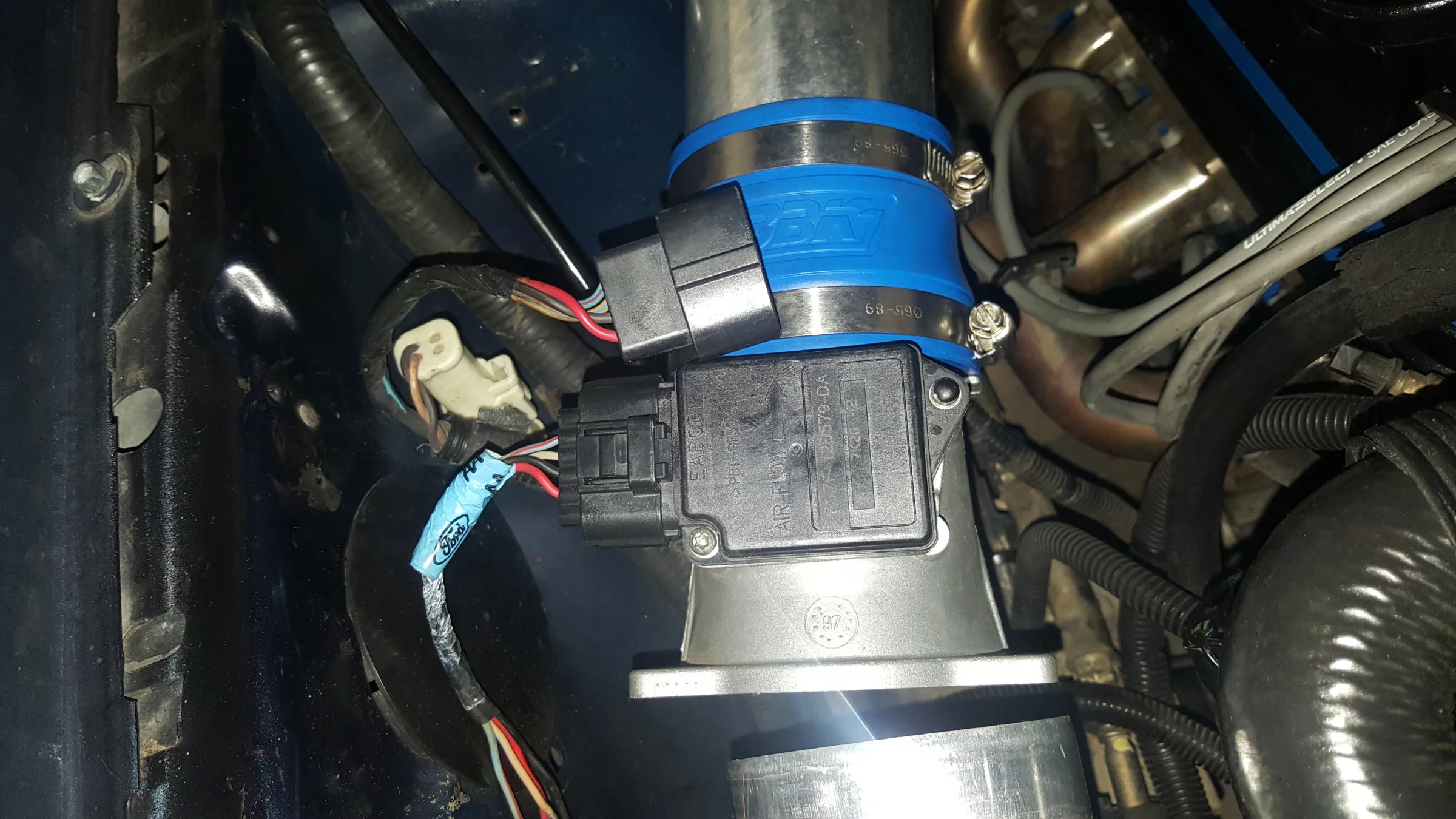

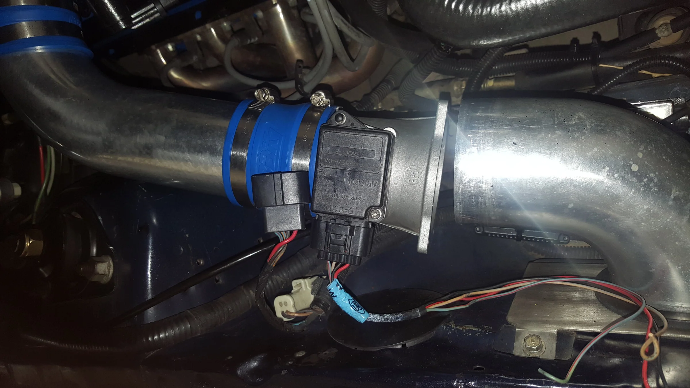

I just got the maf air sensor from a 94 Mustang GT or a V6 supposed to be 70 mm. And I still need to get the adapter for the fox body .
But the plug on the sensor is different than the Foxbody do I need to splice the wires and put this new plug . Or it should be the same plug connector?
Jun 18, 2017
21
37
#16
I hope that you already have a matching 70 MM housing; the housing and the sensor are designed to work together as unit.
Jrichker.
View attachment 583983 But the plug on the sensor is different than the Foxbody do I need to splice the wires and put this new plug . Or it should be the same plug connector? View attachment 583982

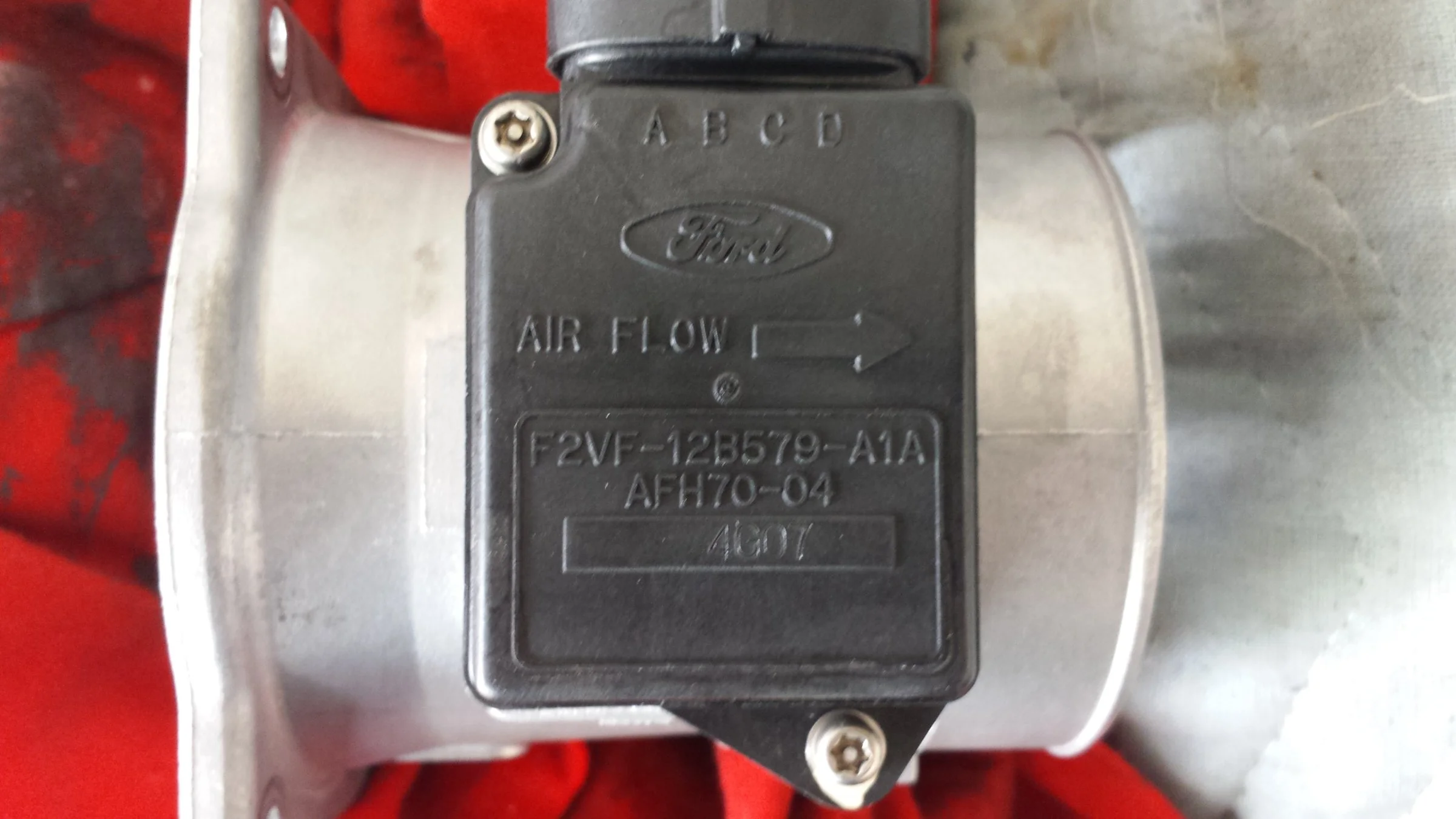

#19
Do the numbers look the same on your MAF sensor and the one I posted is correct?
If not then there's your answer
