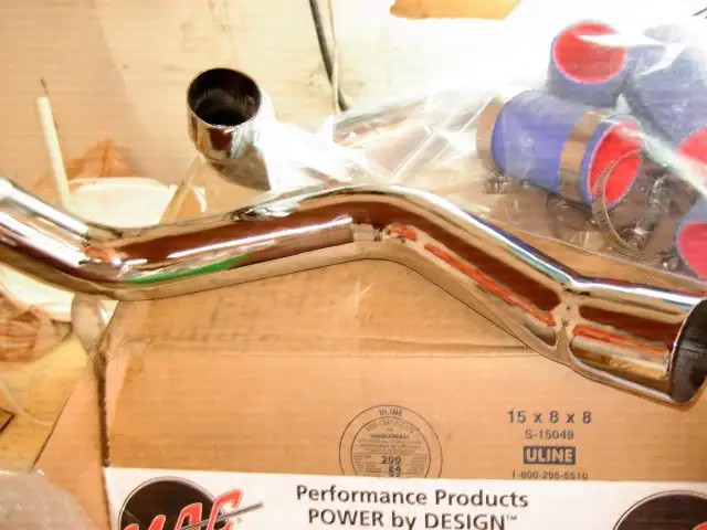

The metal hoses have rubber couplings at the ends. So, vibration isn't a problem.
MAC products have a so-so/poor rep for quailty. With that said, I went with a MAC back SS system a few years ago, and it still looks very good. I have wetlands behind my house. So,
everything in my cars have a tendency to rust and quickly. So, for me, and that one specific cat-cat system on my car, I've been impressed by how good the MAC quailty is. But, as I said, you can read about plenty of people complaining about MAC quailty.
So....
Giving the above, *I* would worry about the MAC chrome hose/pipes having internal/inside flaking and having that clog up the radiator. At least for my MAC
exhaust, if it did have bad quailty, it would look rusty, and just require replacement sooner. So, it was only a risk in terms of money and parts life expectancy. That's very different that "betting" my engine on MAC quailty.

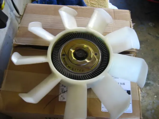

As for the clutch, I hope you got a
thermal clutch. Much of the PURE BS that you read about "How F***ING AWESOME electric fans are in their power savings" is based on a
NON-STOCK GT engine cooling setup - a fixed fan, or flex fan, or a simple clutch fan.
The
STOCK thermal clutch setup has very little power loss in REAL LIFE driving - I'm not talking about some BS dyno run!
However, the real problem with the stock fan setup is that many 5.0's really need MORE air flow at idle in some weather. That's why Ford has a special Police thermal clutch that has even less slip at idle and full-speed.

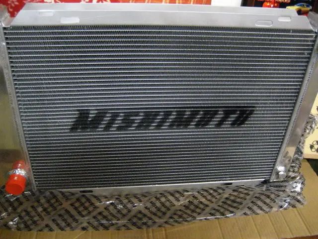

FWIW: With the massive FRPP aluminum radiator and stock thermal clutch setup, and 195 high flow thermostat, unless it's ~50F-60F, may car can't get near operating temperature. The cooling is just too much, and all car systems have
some amount of bypass past the thermostat. The bypass amount and design is one reason why thermostats are "universal".

And, yes, the above also relates to my concern about using MAC chrome coolant pipe/hoses.
