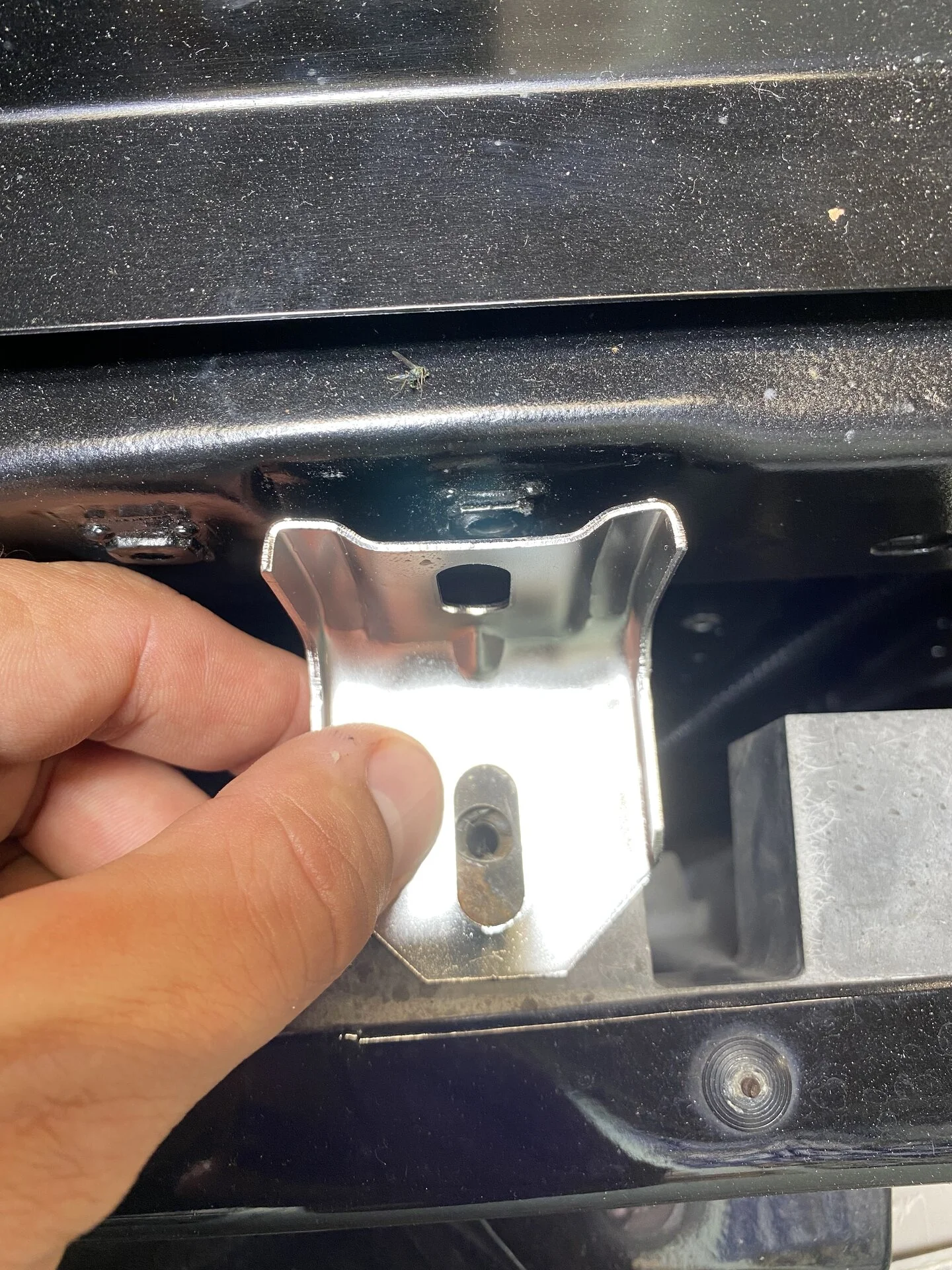

I still need ot install the hood latch and safety catch. I took that off so i can align the fenders and not have to drop the hood to get it to catch to see the fit. So no cruises down the road yet given nothing holding my hood closed.
