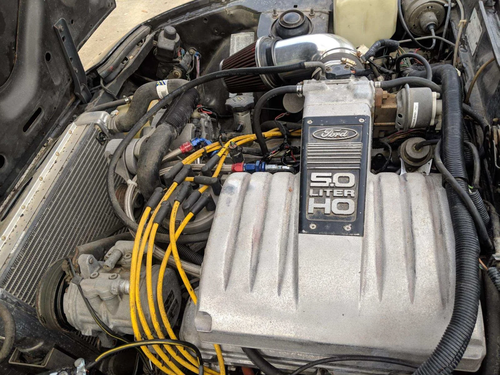

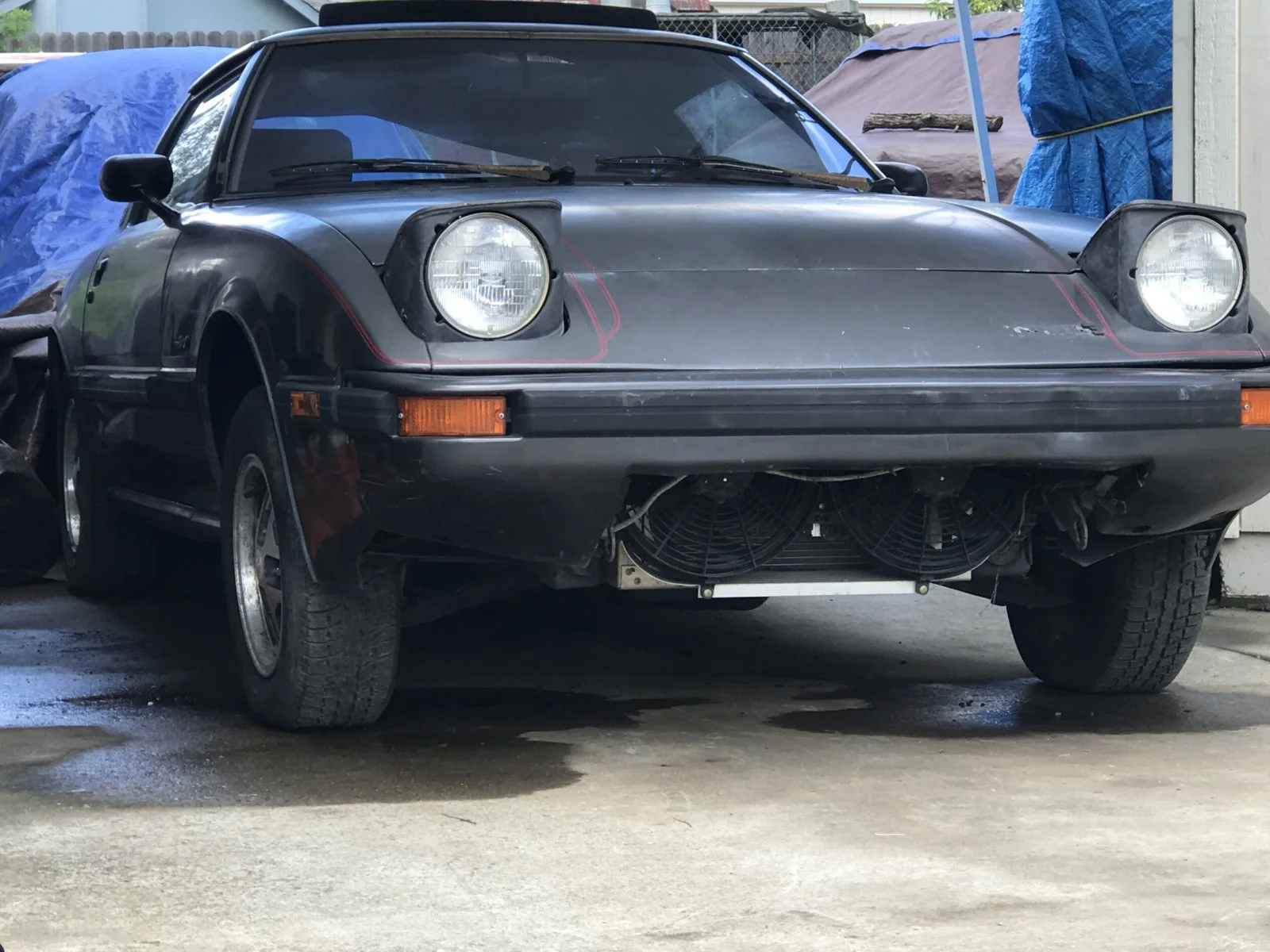

How bout a shot of the car, engine pics too, see if we can poke fun, I mean, help you spot any other troublesome issues.
Well see I went to the auto parts store and asked how many Lph and the dude came back with 94 psi and I was like what but I don’t think I have a return line I might I will check but i don’t know yet we will see

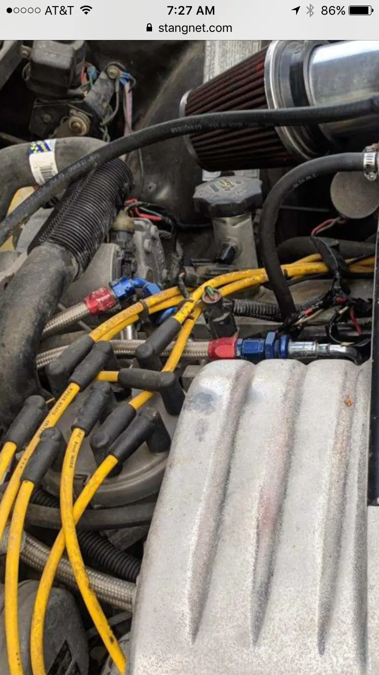

Where cause I’m still having problems I don’t know still but today I’m going to be taking off the hole intake and stuff so I can clean sup and look for vacuum leaks and stuff but I personally don’t see the return line
These two stainless lines connect to the fuel rail. One is primary other is return.
Take a better pic of the area. Should be a schrader valve in that area to hook a fuel pressure guage up and measure pressure. Should be 39 psi vacuum off regulator
