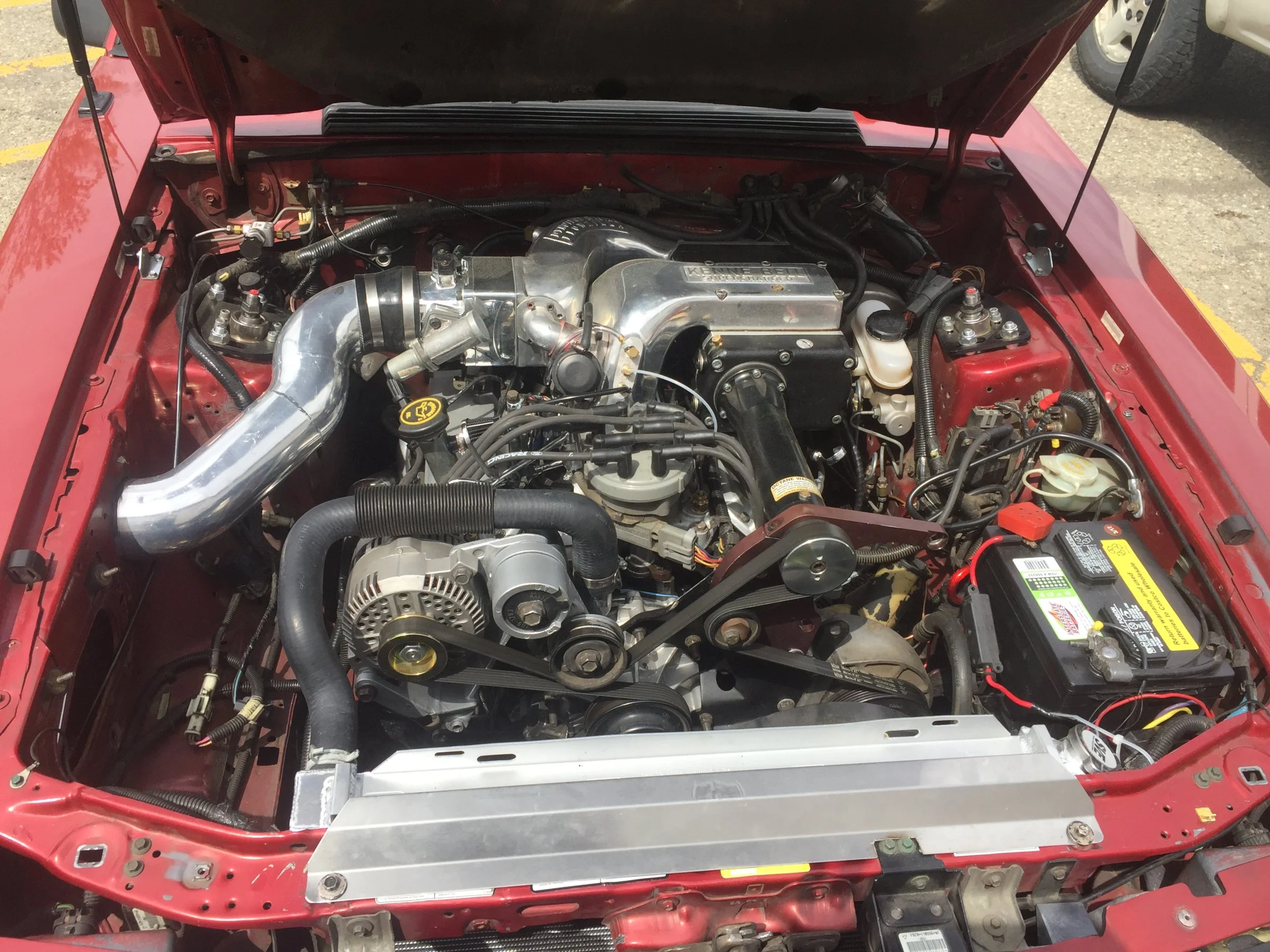

Progress Thread My Kenne Bell Twin Screw'd Foxbody thread, (new addition to the family)
I need to get a shorter serp belt asap
You had to give up ac?
I didn't have to but I did not want to cut and modify my AC lines until I knew that the KB install was going to be successful and run well. Most likely I'll reinstall it this winter but I may not do it at all because honestly I don't ever use it. I have kept most everything for the car to make it stock again just in case I feel the need to someday.
Congrats! Car looks great and I'm sure runs like a beast!
Thanks bro! The car feels good in boost but it's rich and I'm sure would pull harder once it gets leaned out to just the right amount. We are taking a little out each time but I'm too much of a poosy to go WOT and achieve full boost to get a well informed data log. I wanted to yesterday on the way home but it started raining on my commute home :nono:
I never heard back from Devilsown injection but AlkyControl answered the phone the first time I called them and I got mixed feelings from Julio that gave me a lot of info. Firstly he thinks meth on less than 10# of boost isn't really needed. Secondly he's not much of a fan of adding meth to engines without knock sensors because tuning is more of a guessing game. He also prefers to inject via MAF function with positive displacement superchargers. The reason being is that it's possible when activating meth based on boost only that I could inject too much at high boost and low rpms (like mashing the pedal in 4th gear at 2k rpms). He also wants me to inject 100% meth, no mixing water. He suggested VP M1 fuel.

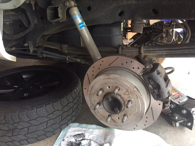

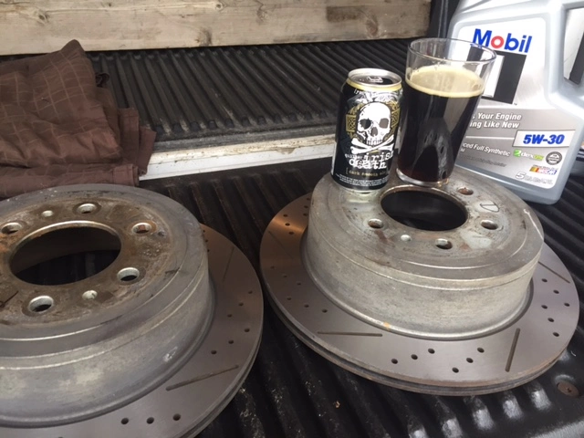

Got some of the maintenance done this past weekend like oil change, brakes, coolant flush, etc.
I am injecting mine based on tps and rpm.
When I'm in wot (90% tps or greater) and above 3500rpm I want the meth to kick on. The only purpose is to lower intake temps.
Trust me with pd blowers the intake temps can get crazy high quickly. On a 90* day 9psi makes 180*+ intake temps. The general rule is 10* per psi temp rise. On a hot day I saw 220* intake temps at 12psi.
I immediately installed a fmic
