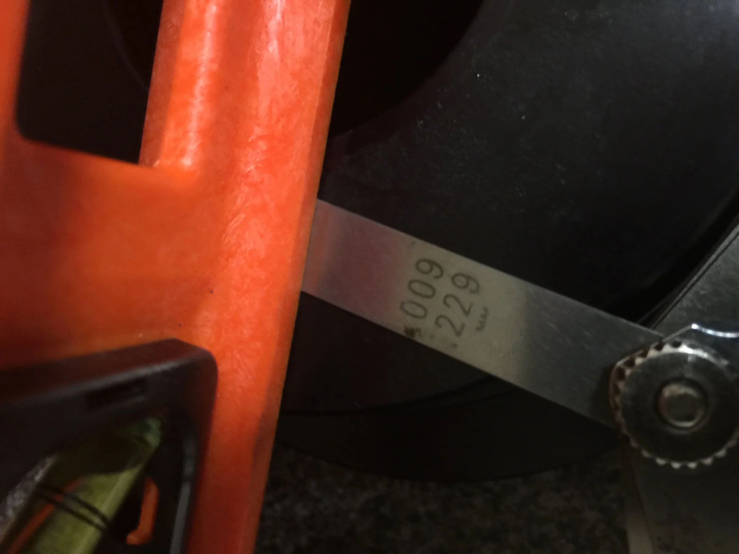

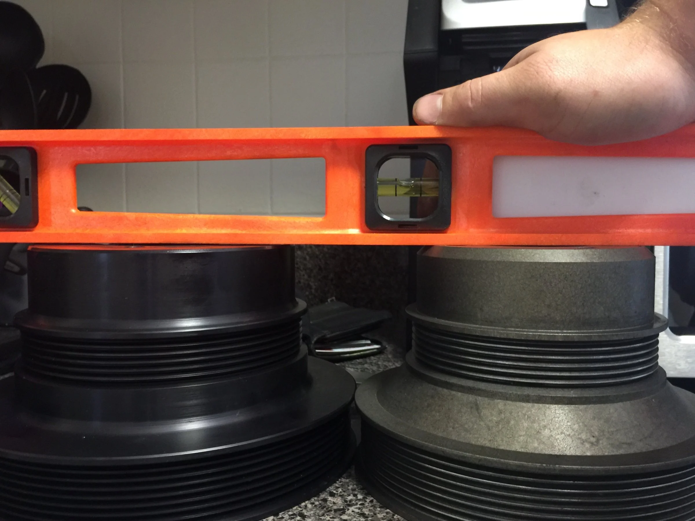

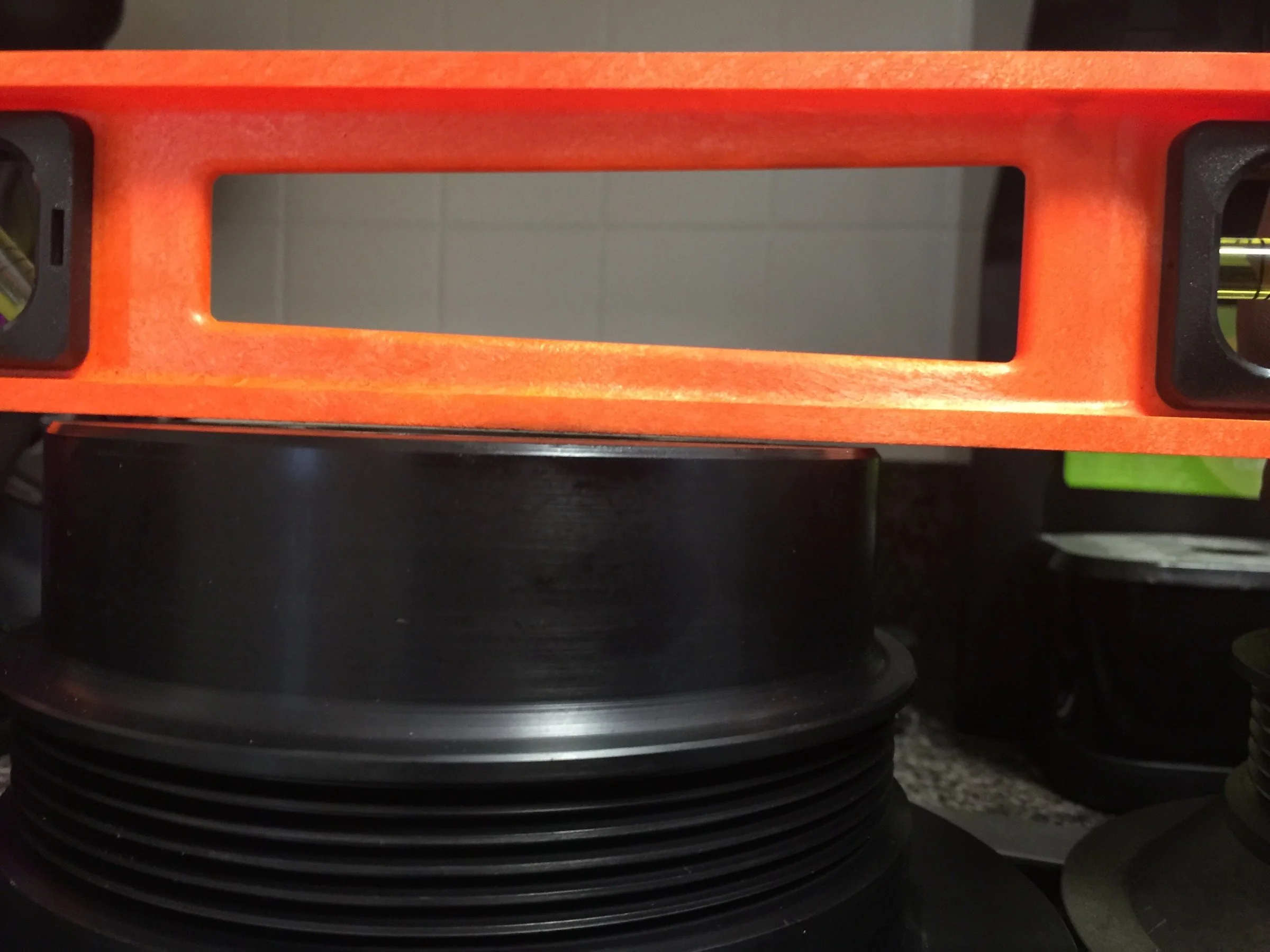

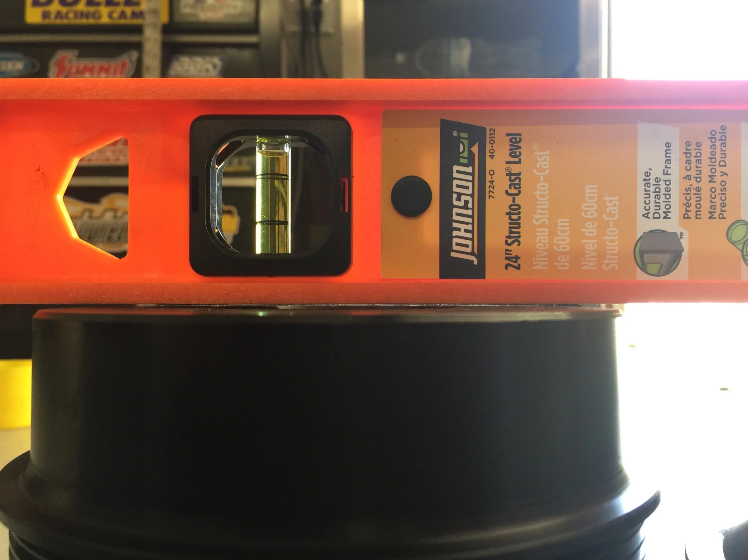

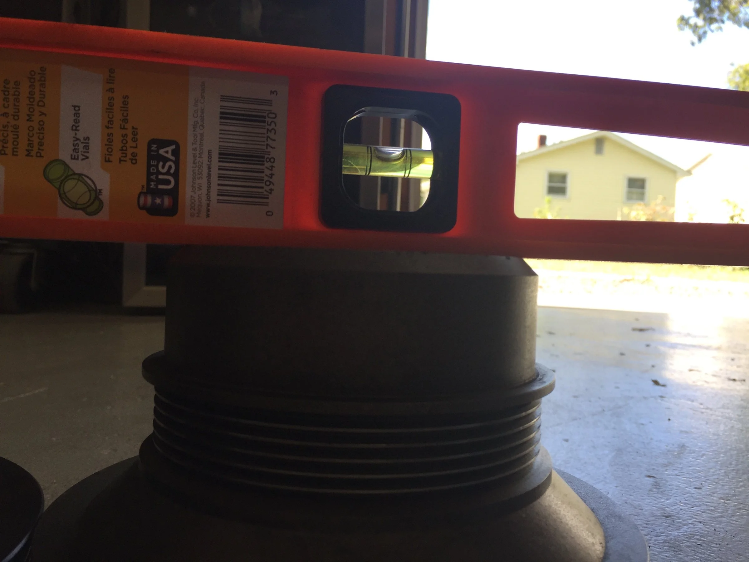

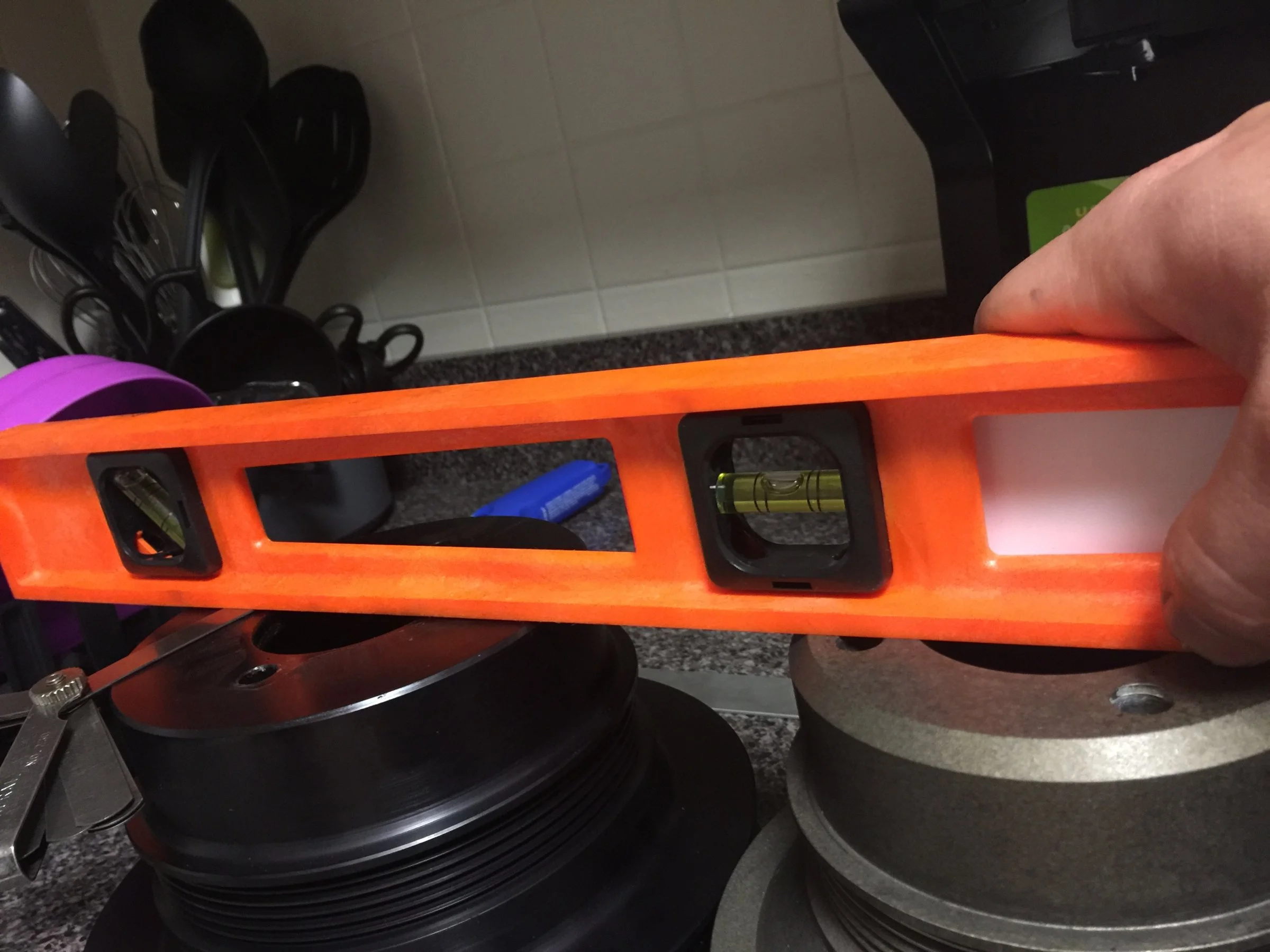

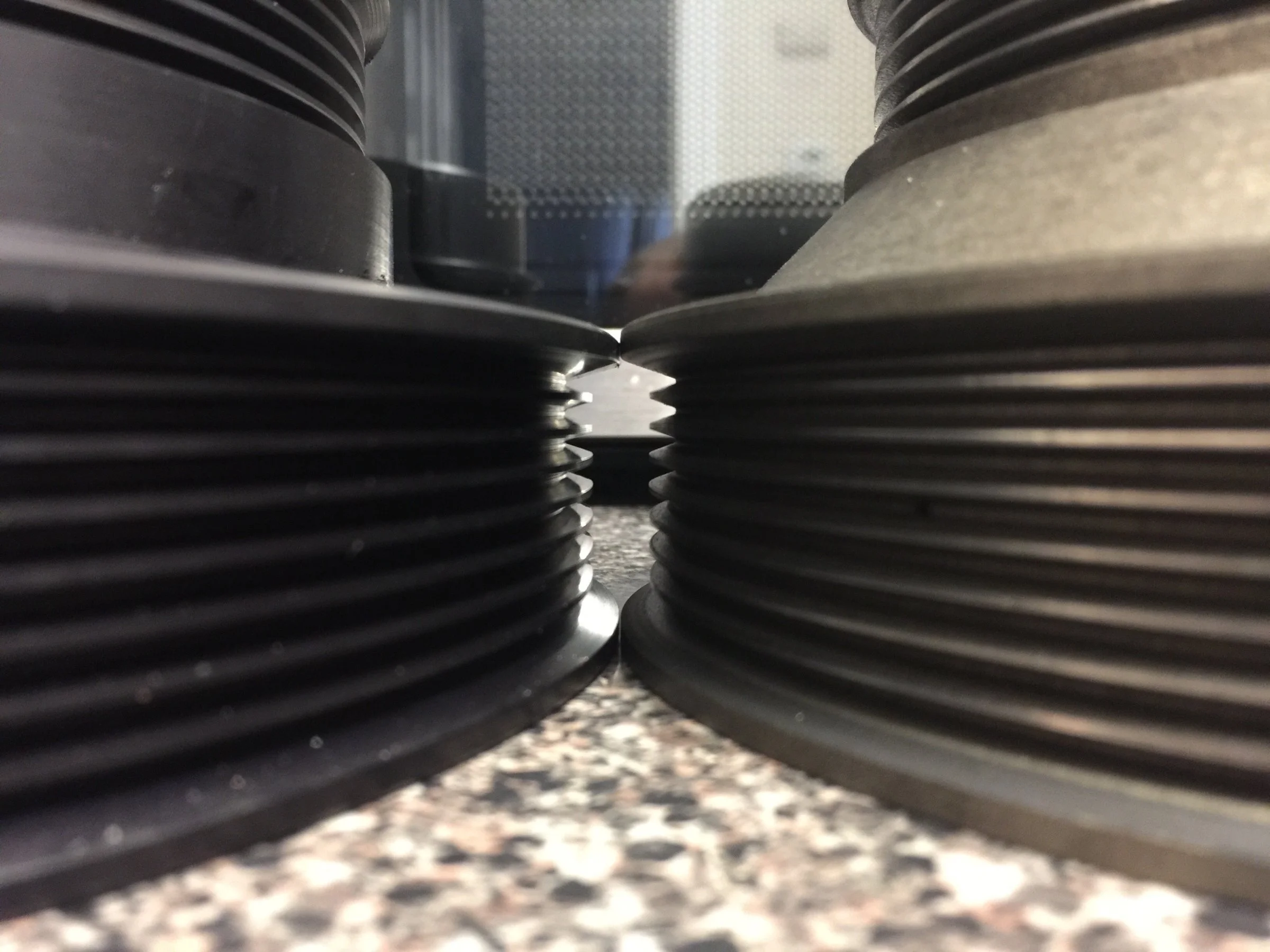

They should replace the pulley and the consumed belts if the new pulley ends up fixing it.
