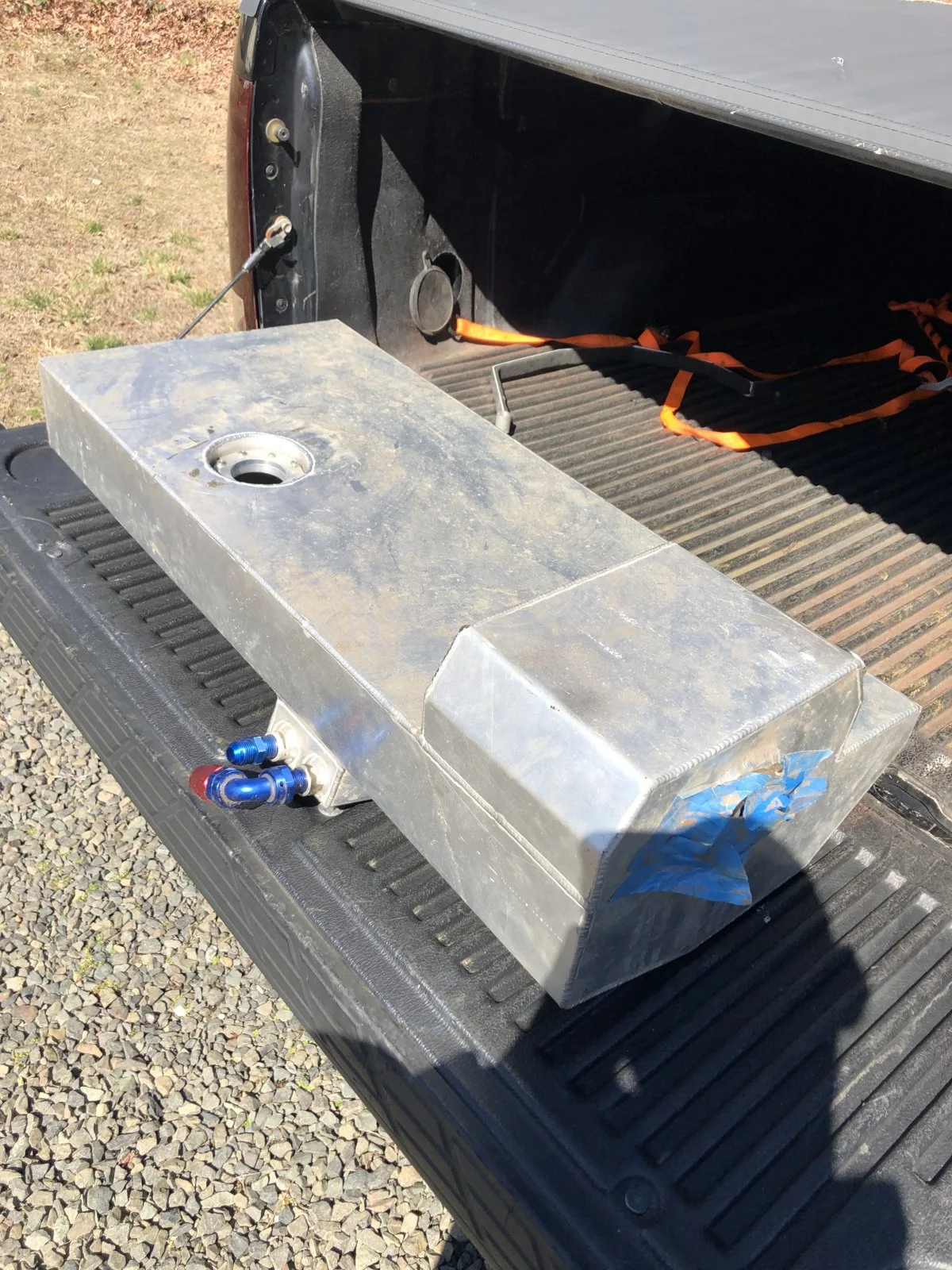

Picked this up this weekend . BBRC stock style tank . Going to this and a Weldon 1100a pump at the recommendation of Freezy and me not being a fan of my current Glenn’s sleeper setup . Going to have stands welded on the tank to bolt the pump up front . Then have it PC satin black .
this is new . Been sitting inthe dudes garage . Paid 425 they are588 plus shipping

Why do you not link the Glenn's setup?
I was looking at one of there 03-04 cobra tanks that they sell, but almost thought of just getting a 99-04 tank and welding in the baffles myself.
TOOLOW91
7,297
7,101
S.I.NY
The 03/04 style is fine . The front feed sleeper I have is what I think cooked the motor last go round .

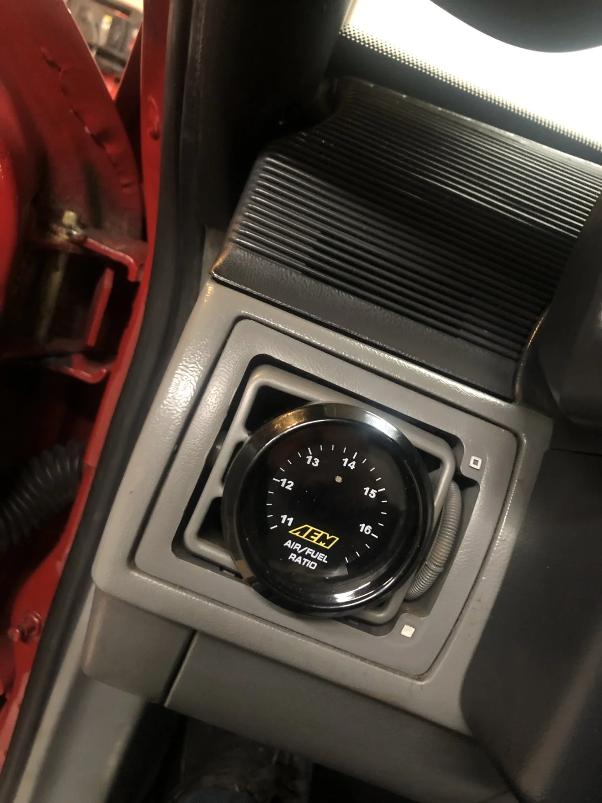

I never get tired of seeing pictures of this car, you need to get some safeties in place for the system.. I monitor fuel pressure and AFR and if either go out of my allowable range it shuts it down to avoid damage.

It’s all monitored . It’s setup now to pull timing if inlet temperature is too hot etc . I haven’t gotten I to boost really at all . I am going through all the things that need to be addressed before we re dyno again
