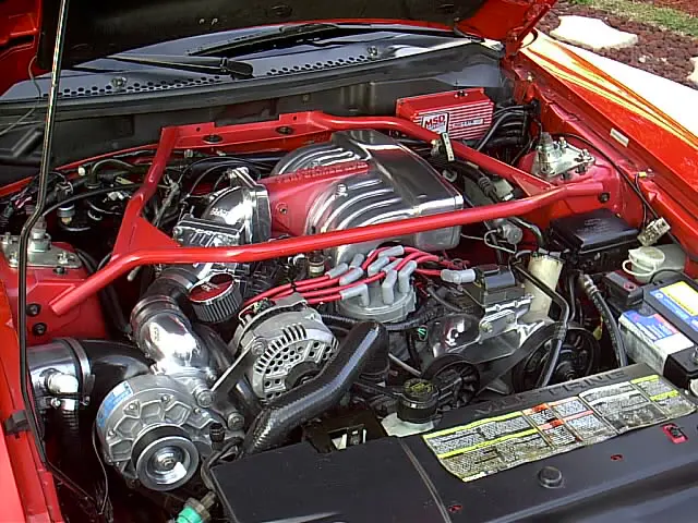

If it's N/A a breather on the passenger side valve cover is enough vent. If you go this route I would think capping the PCV is fine.
Now if you're forced induction a catch can is ideal. Although I did have to do a catch can on my 347 Stroker. Had oil in the throttle body area and catch can solved that issue.
Looking at pics of my old setups both stock 302 with blower and 347. Had a breather on the blower setup but was also running PCV if I remember correctly. The 347 also had a breather and PCV with catch can.
Untitled by jpjr50, on Flickr
