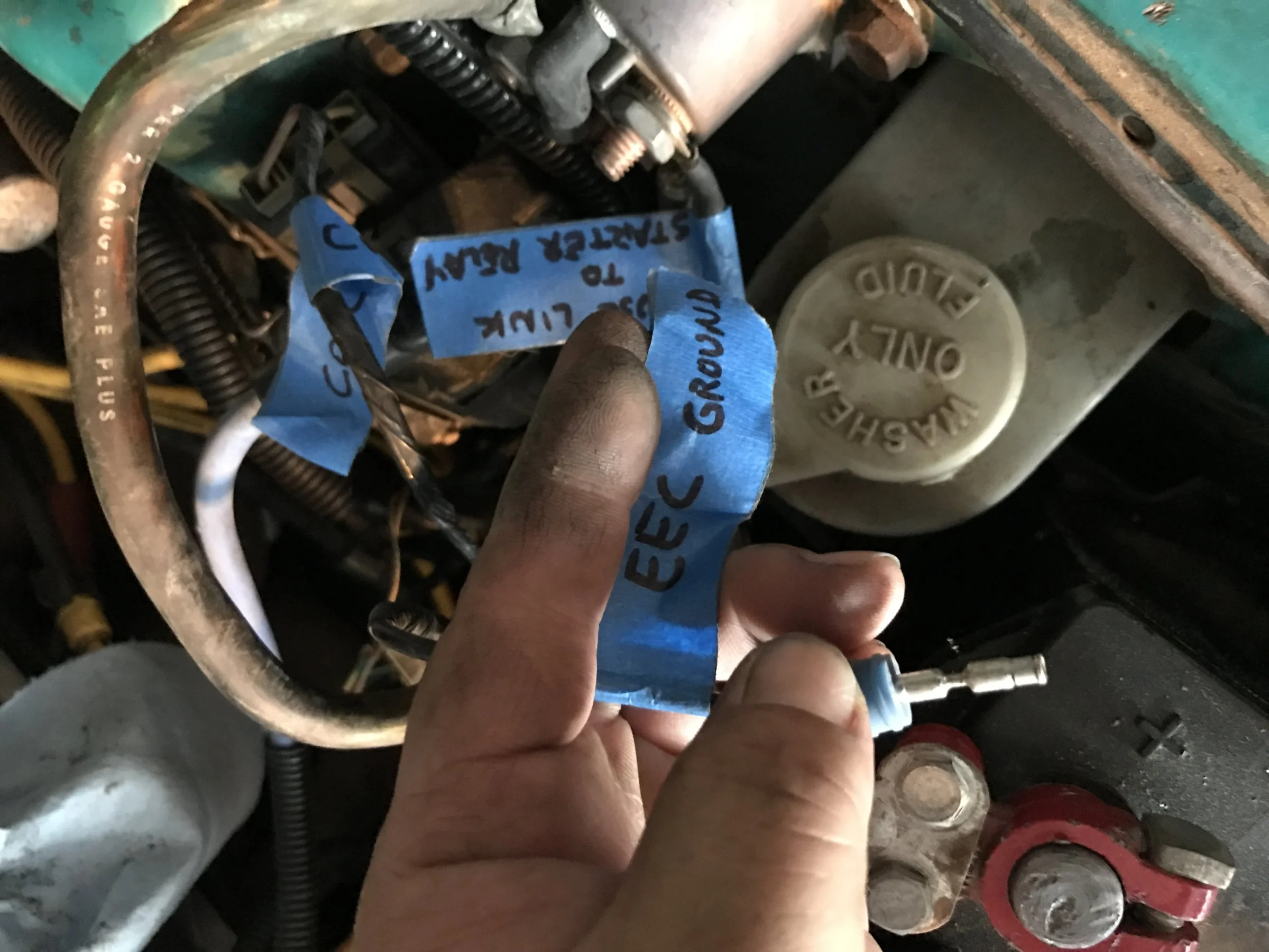

That EEC ground wire is the most important one. It usually grounds on the inner fender on the drivers side right by the corner of the battery...between strut tower and battery.

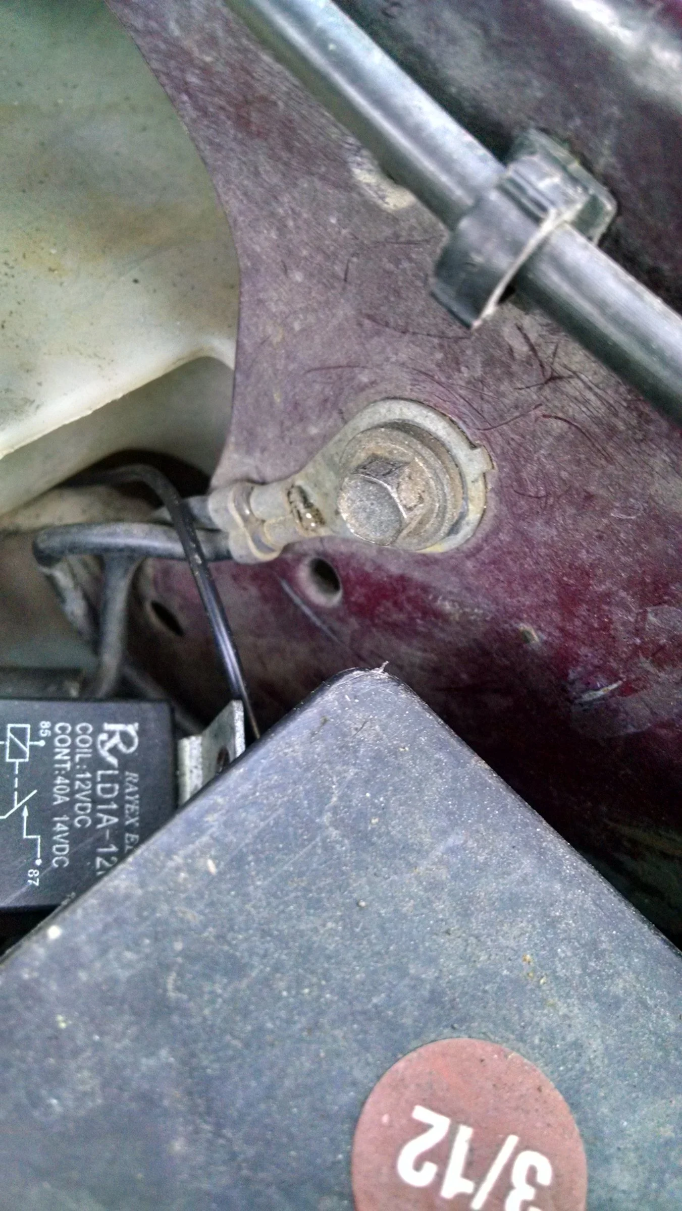

That's it...someone took the black round connector off. It should bolt to the area shown in the pic I posted...between the battery and the washer fluid bottle.
You could cut that end off and use a crimp connector with an eyelet. It should be the yellow ones. Use one for that wire and run another one from the ground side of the battery to the bolt. Ground them in the same spot. Make sure it's a good clean grounding spot.
Without that ground the computer won't fire the injectors....so you won't get any fuel to the engine.
