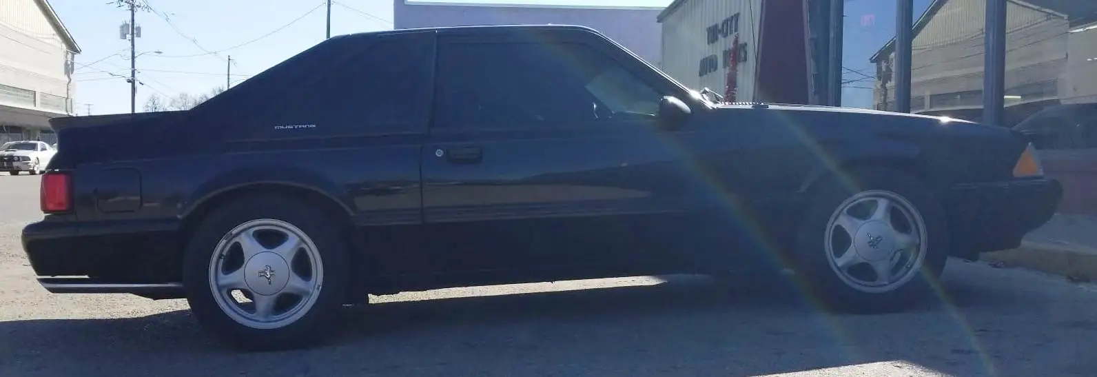

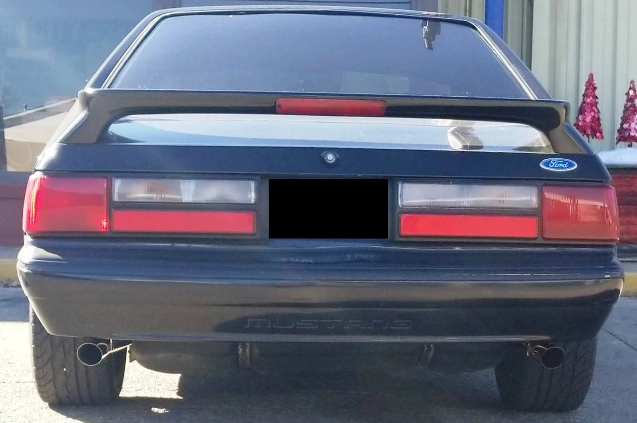

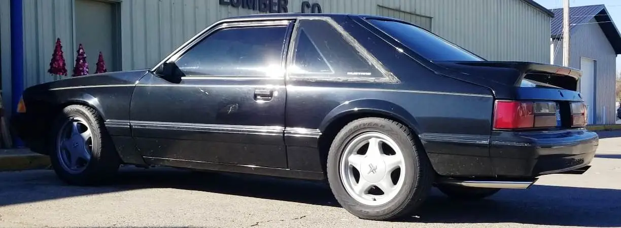

@Mustang5L5 We talked about this a while back and I finally had the opportunity to get to a shop with a good welder & pipe bending machine so that they could be done right. The car is dirty and the lighting is terrible for pics, but whatever... at least you can see the angle.

I may have mentioned this earlier, but as can be seen in the first pic, the quarter window trim cover from the last guy blew off on one of my high-speed jaunts and it looks like hell. I'll get to that eventually.

The Dynomax 2.5” SS tail pipes fit my Coupe perfectly with the MM panhard bar and torque arm. I did have to drop the rear end to get them installed in one piece. If they have to come back out they will be cut on the back side of the rear end up and over and get some kind of flange kit installed. I’m not dropping the rear end out/down again when there is an easier solution.
Not sure Dynomax makes them anymore but I have heard the Flowmaster units are really good as well and they are still made. I’m pretty sure Walker used to make them as well but I don’t see them in their catalog.
If you do not have the panhard bar a driveway install is a Sat afternoon and a couple cold drinks. A buddy helps to hold the tail pipe while you tighten up the clamps.

Maybe I just do things the hard way. I like 'em welded up. On both sets, this car and Kandi's, that required adjustment to the positioning of the mufflers, one of which hung too low, removing the front hangars, and for some reason, slightly rotating the passenger side pipe counter clockwise a bit to get the tip oriented correctly. So, the pipe over the axle leans in towards the UCA and makes it a tight fit. Will take pics next time I'm under the car.
