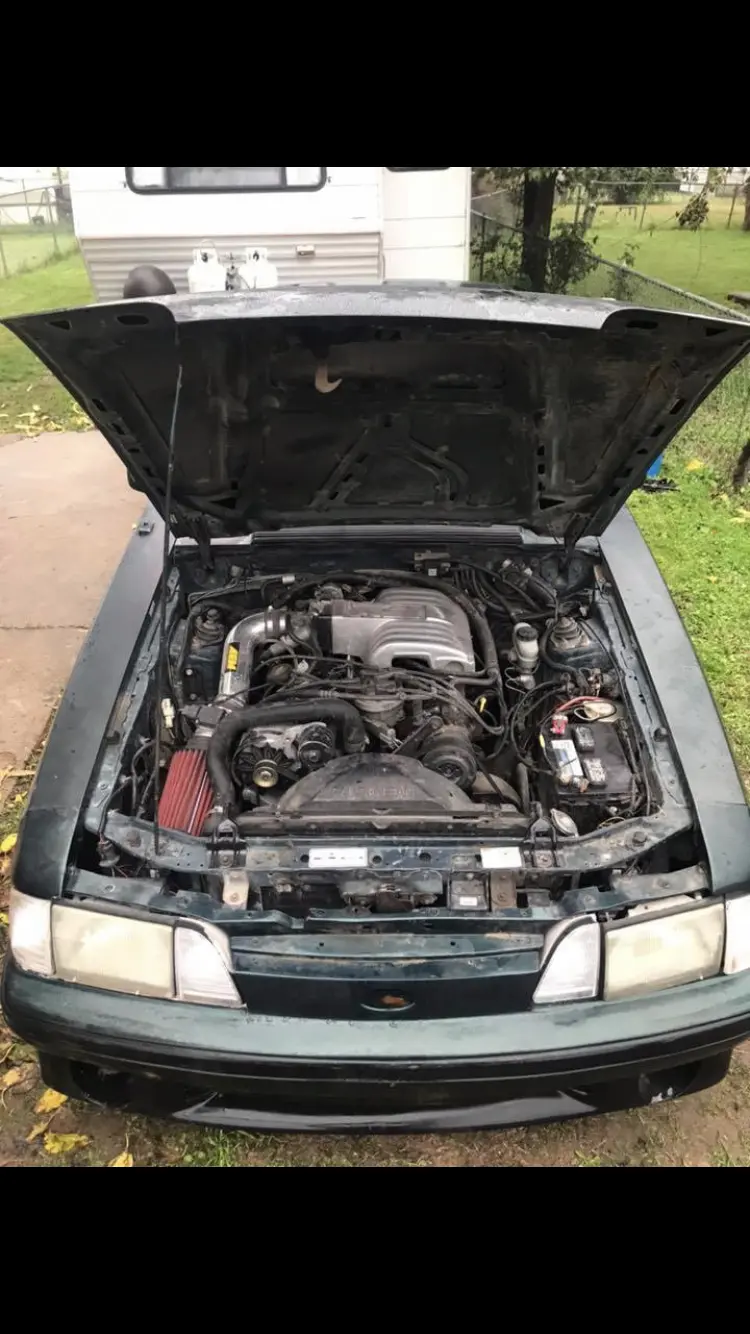

Hey guys picking up a 91 gt tomorrow. Can’t wait to dig into it. Plans so far are gt40 heads/intake and exhaust. What would you guys do first?

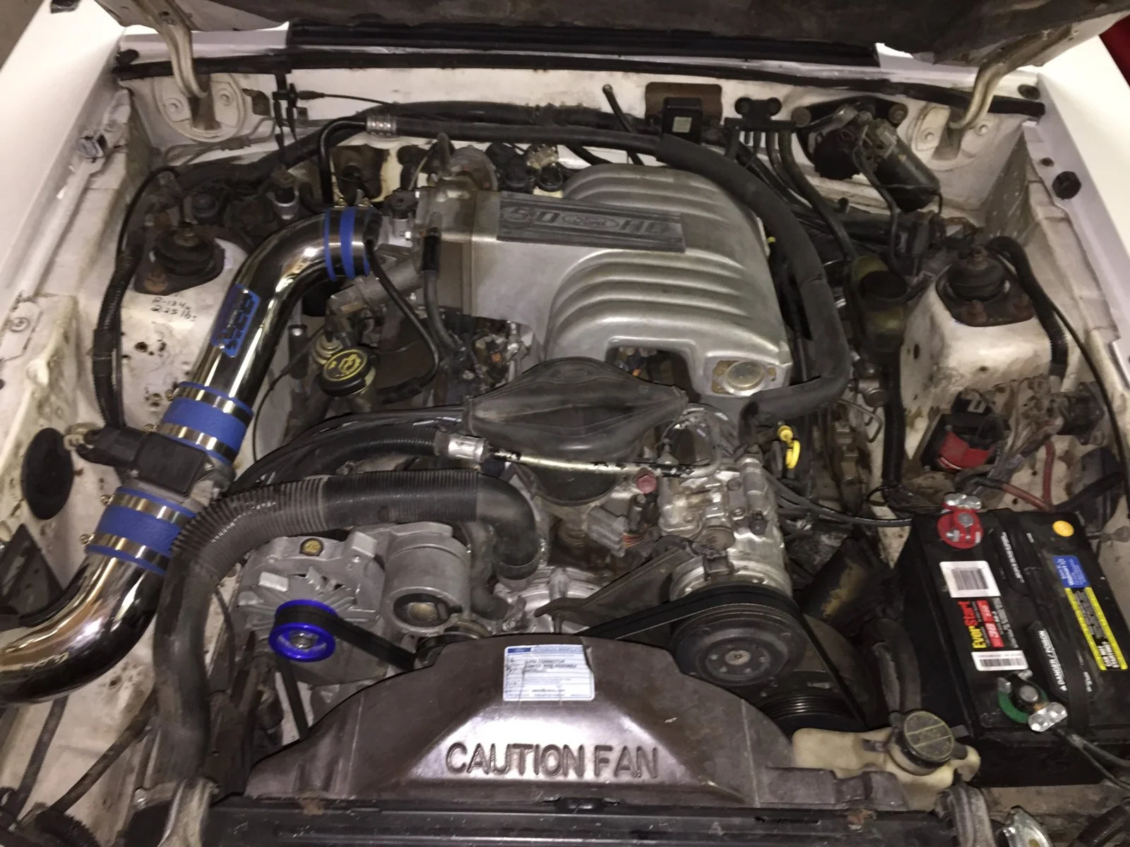

I agree. I tune up for sure. Has it been sitting for a while? I would probably do a fuel pump and filter as well. And change out that intake to a oem or fenderwell mounted one. I have one for sale if interested.:cool: I do like the green. Will the black come off the lower part of the car easily?

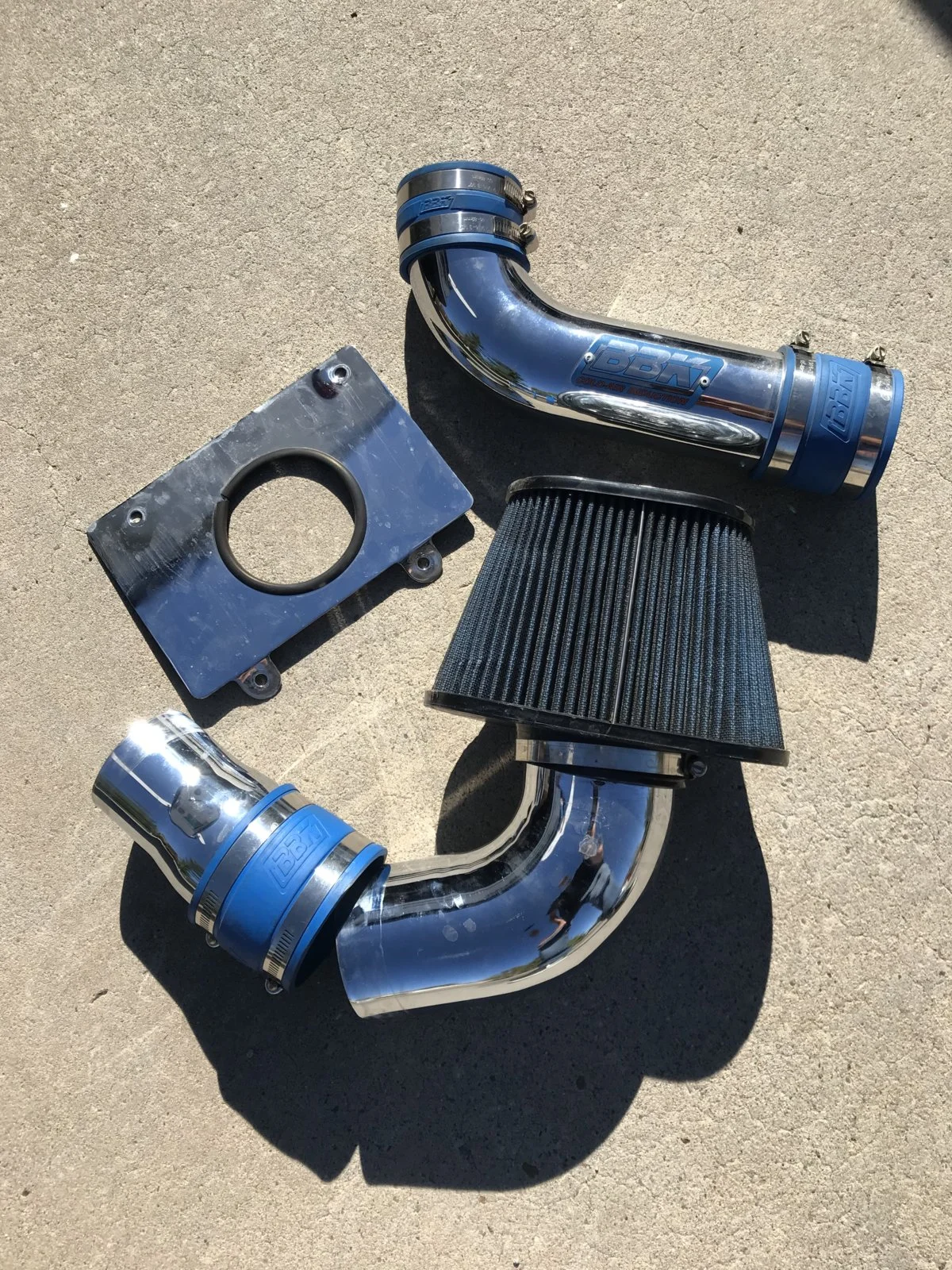

They are faded black. I’m planning on going with the fr500 in bronze or a staggered deep dish 5 spoke and painting the car a black cherry red. I have big plans! But it needs a good amount of body work. Also thinking about a wrap! My I ask why that cold air set up is bad?
Sucks more hot air in from the engine compartment. I have this one for sale. It mounts inside the fender. That’s off my old car.

First thing is to completely check for rust. Strut towers... rear frame rails above rear... floors...d door hinges... cowl area. I'd focus my attention there first. Electrical assessment, ignition switch connector, fog light switch, headlight switch, multifunction switch, radio harness... anything that may have been hacked by previous owner. Brakes would be next with subframe connectors.
GT's have their own set of known electrical issues. Melted turn signal switch plugs, melted ignition switches. There's a modification which takes the load of the fog lights off of the fog light switch and ignition switch. It involves writing in a relay so the fog light switch triggers a relay and the relay carries the load.
That's a good looking color combo. Green on black looks good. I understand the want for a color change though.
Good luck with this car. Glad someone is saving it.
