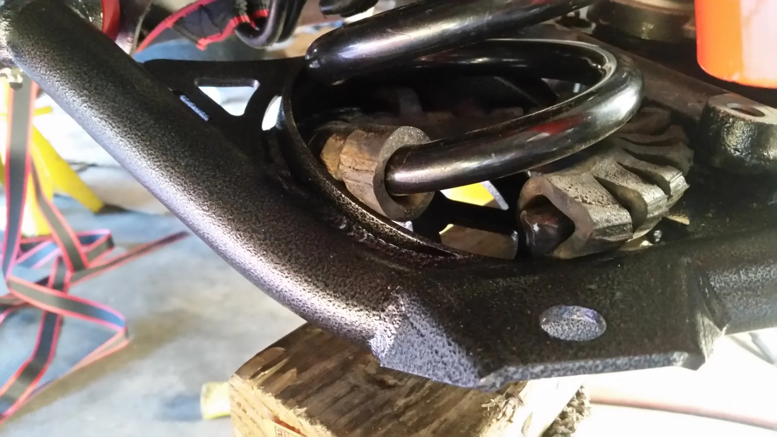

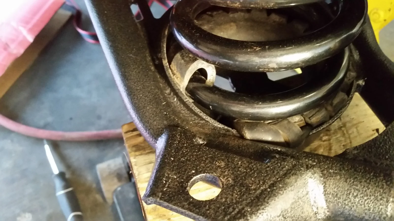

Here is a pic of the wonky angle BMR puts the spring perch at on the front
control arms. With full weight on the wheels the spring perch still has a lot of positive camber vs the ground making the spring continue to back bend. Why they wouldnt make it parallel to the ground at ride height (still giving it positive camber from the K member perch) is beyond me. Made for very difficult install.
