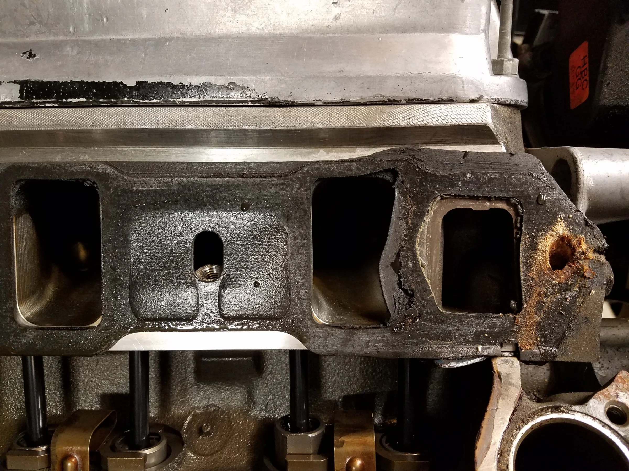

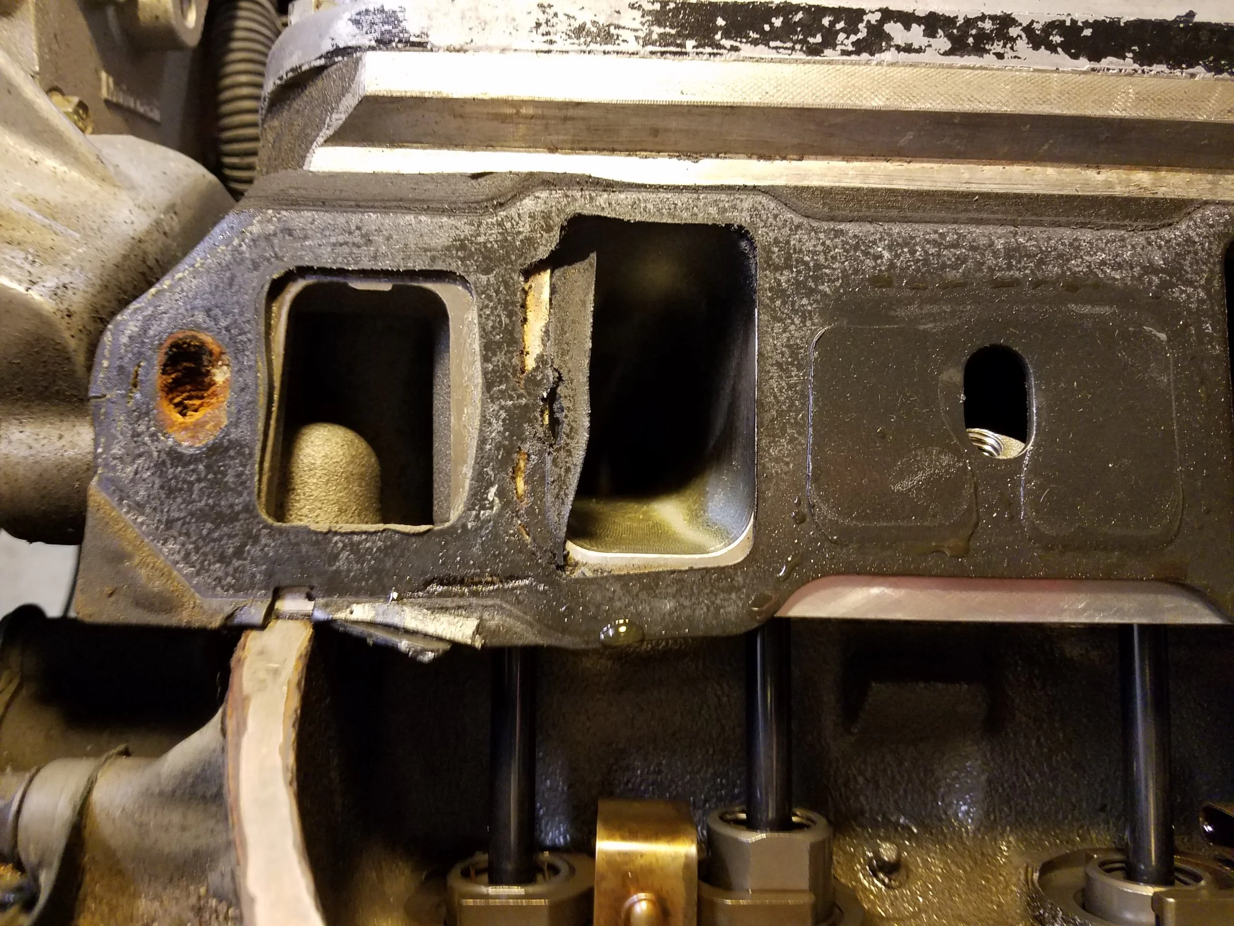

Proof that I drive my junk. This thing is grody.
So this is why I tore it apart... The engine was about to munch on intake gasket salad. Glad I saw it when i did. This is after 6 years and maybe 15-20k miles since the engine build.
Anybody got suggestions to keep this from happening again? What kind of gasket glue do you guys like?

A little rtv around the water jackets and a dab in the corners where the head meets the block and a 1/4 inch trail on the front and back walls, stick a couple dowels or threaded rod to guide the lower on straight, wait 5 minutes or so and slam that sucker together then I go have a cup of coffee, you may reward yourself with a beer or three if you like.
Then I remember I forgot to put the gasket on.
On a troublesome gasket I'll use a thin coat of permatex super high tack " yellow snot ". I used to use it on the old Chrysler K cars cork gaskets. The stuff is hard to get off after it sets up but it holds well. I use Right Stuff around the water jackets and the valley.
I've had intake gaskets rip in half during disassembly. Only a light coat...its sticky as hell.
I always use right stuff around the water ports, i am guessing that is a 1262r gasket, those things always were tough for me, they looked like garbage after minimal time on mine. Ed curtis had cometic make up a intake gasket that matches the 1262r but isnt made out of such a weak material...
