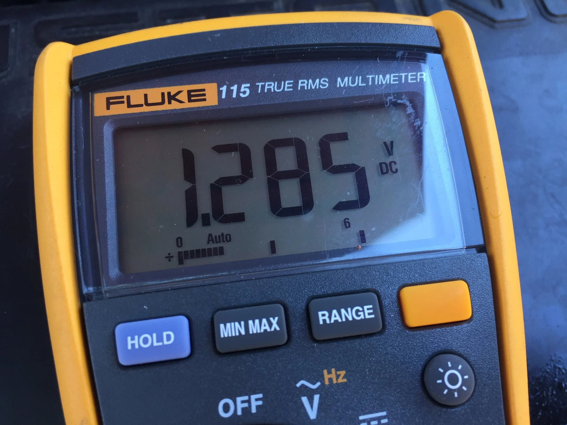

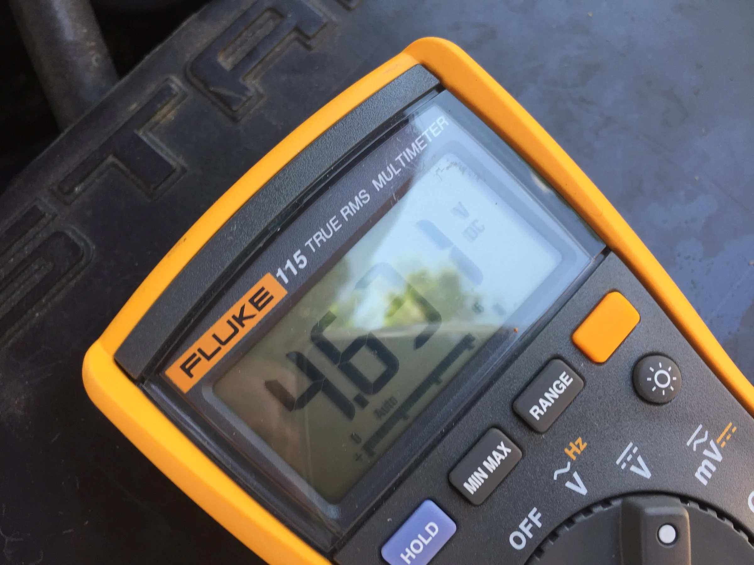

What's weird is that it'll idle at like 1500-2000rpm as long as the car is moving, even in neutral. Soon as I come to a complete stop it'll drop back down to 900rpm. The TPS doesn't read within spec on my meter though, so it's likely the culprit, unless these cars are supposed to do that? Is that deliberate for some 1995 emission control or something? It's pretty annoying with the loud exhaust on this car. Makes me look like I don't know how to dive a clutch. Ha!
