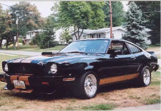

Damn, those are nice shots, got to download them.
At that time I was using a Weiand Stealth and have since dropped to an Edlbrock Performer to lower the unit. Performer also gives me a tad more torque to match the streetwise cam.
I also dumped the air cleaner which I had modified to center the shaker. I went back to a stock air cleaner base and modified the intermediate plate to center the scoop instead. Much cleaner install and better air flow, not that I need a whole lot more with dual snorkel inlets.
