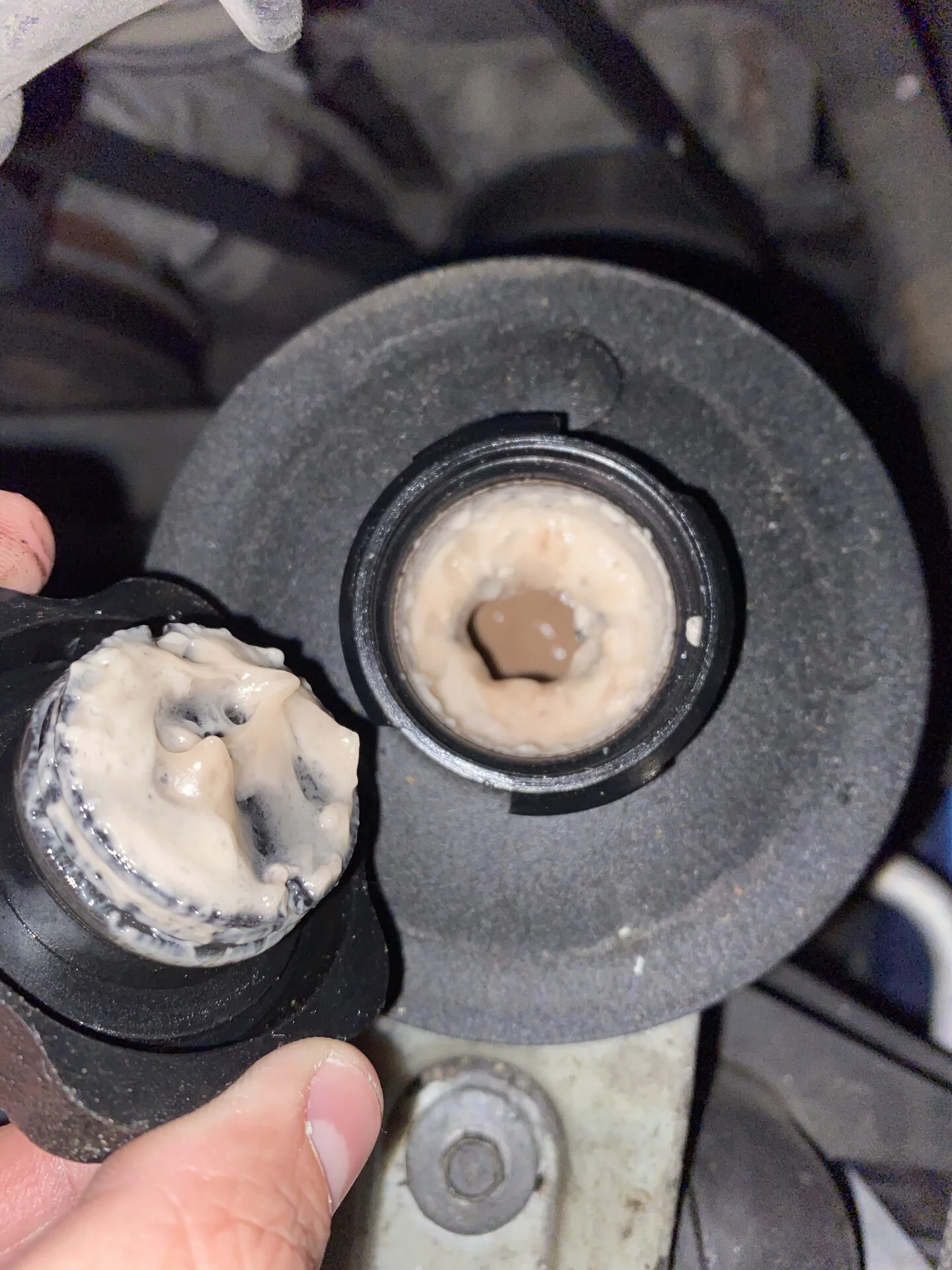

If that was an oil filler cap, it would be “milkshake” like foam from water or water condensation in the oil. I’ve never seen it in a power steering system, but I bet it’s the same thing. Time to flush the PS fluid. Does this car have a liquid cooler for the PS fluid?
