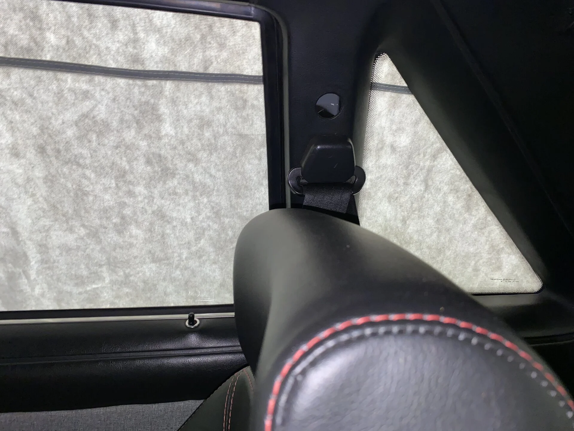

Hey guys, I wanted to thank you for confirming a suspicion of mine regarding the front upper seat belt boss location differences. I recently realized this issue when I tried to install a Corbeau harness bar in my 88 but it came up about 2.5" too short. I've always suspected that the bosses were moved slightly upward on the airbag cars, but Corbeau insists their bar fits all 79-93 cars.
Mustang5L5, is there any chance you can post a pic of your upper seat belt mount that shows how far it is away from the old hole that you plugged? I'm trying to get Corbeau to realize they have an issue that needs to be addressed. I really wanted this bar to work in my car but I just can't come up with a way to safely adapt it to my 88.
Looks like I misread what you said. You didn't have to plug the hole in your quarter plastics because they came from a 90, and the location didn't change until 91. You were just saying it could be done.
location changed in 1990.
I drilled a 1” hole in the ‘90 plastics to mount the belts in the originsl ‘88 locstion. There is a difference in belt height of the 87-89 and 90-93 cars
