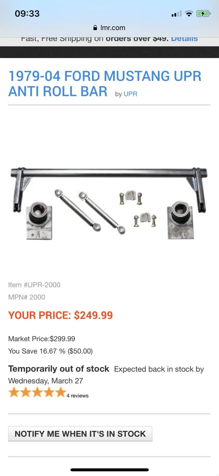

With a A.R.B. no need for a rear sway bar. But if your car is sub 500 H/P no way would I run one on the street.
I use a A.R.B. spool,solid uppers/lowers on my street car,but that's not for everyone.
