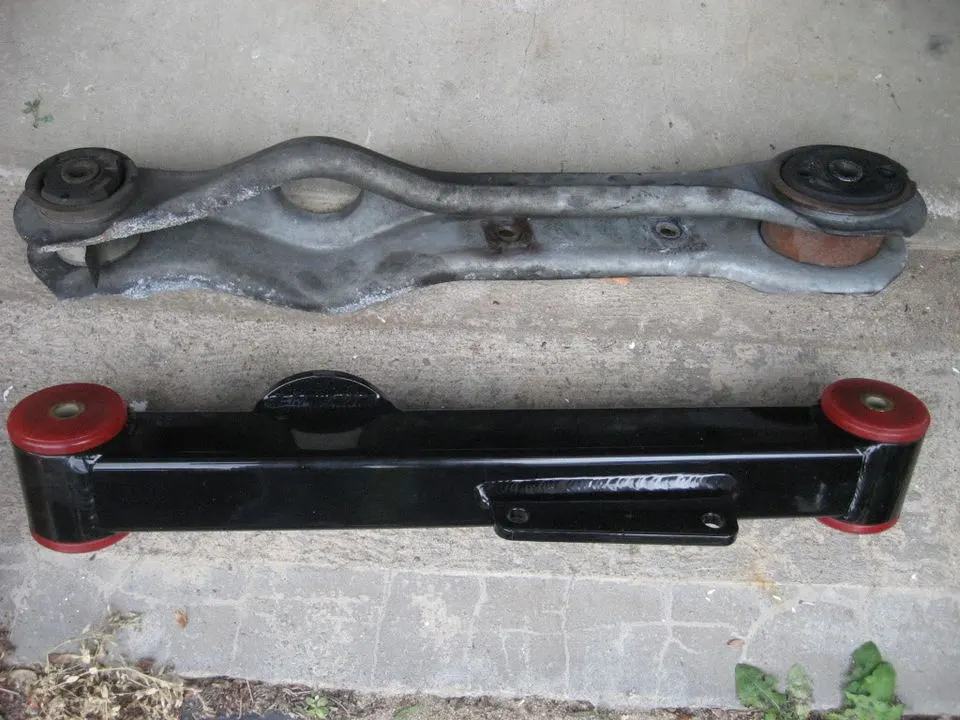

my UPR lowers had ALL the bushings fail in under 1200 miles.
i now have MM solid LCA's and wish i would have gone with the good stuff from the start
Do yourself a favor, & pickup a set of MM LCA's. They are the best designed & strongest on the market. As far as uppers, stick with your stock 1's unless your bushings are blown. If they are, pickup a set of FRPP stock type from MM, or steeda boxed uppers. Other aftermarket uppers will only increase suspension bind & will only benefit you if your car is a strictly drag car.
When you installed your solid MM lowers, did you weld up or reinforce the torque boxes?
