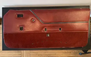

Front of driver side door panel. (Note the large window switch hole for convertibles. I've already removed the metal frame hardware in order to soak it in some CLR to clean it up a bit.)

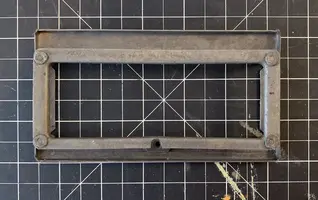

Cleaned up pretty nice. You can even make out the Ford branding, part number, and location reference (TOP) again.

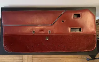

Front of passenger side door panel

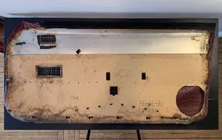

Back of driver side door panel. Obvious warping due to water damage.

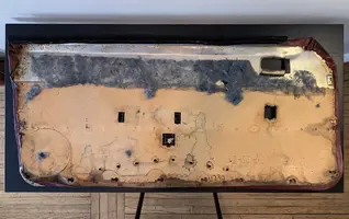

Back of passenger side door panel. Same issues with water damage. (Note the remnants of factory sound deadener. I'll also need to find a new solution for sound deadener when I'm done with these panels. The original stuff ain't cutting it and I'm not putting it back in there with these new panels.)
