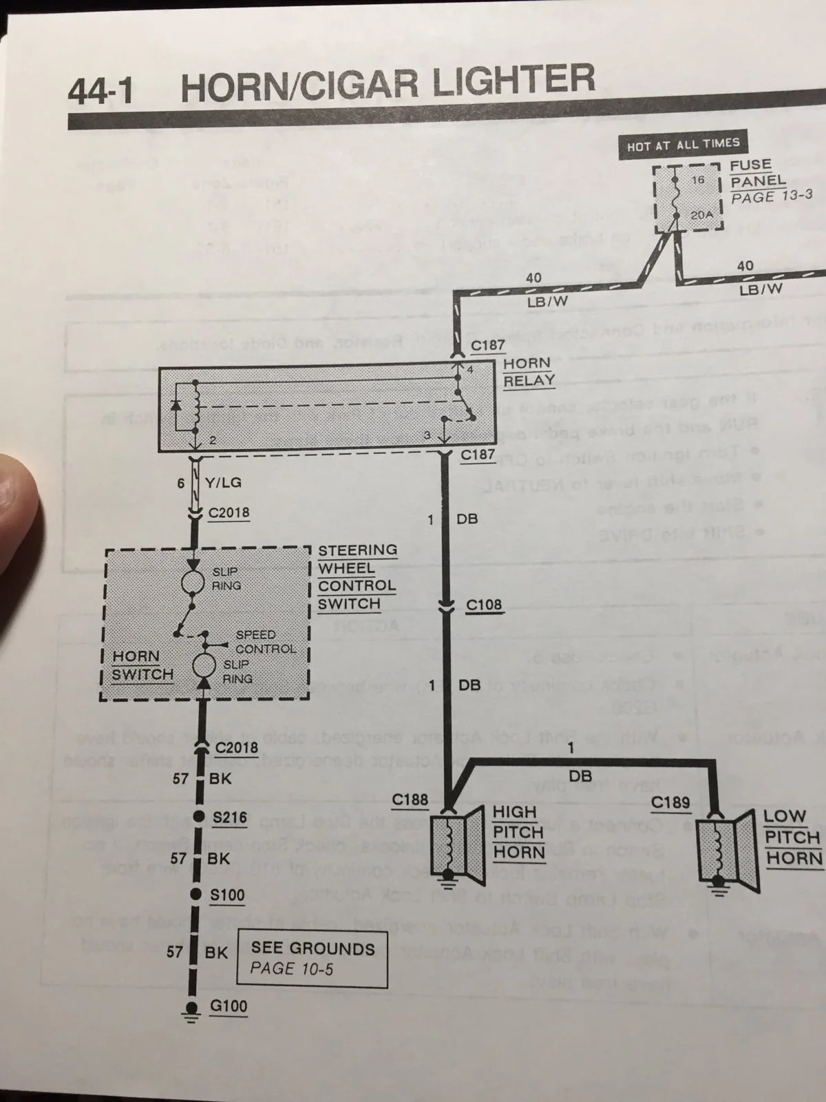

I am looking into wiring my right horn button to a different circuit, but I need help finding the wire. I can’t find any diagrams online for this, but I only want to change the routing of the right button so that the left one still works normally. I want to take the right horn button wire, cut it from the circuit, and use it elsewhere. Does anyone know where/what color the wire is for this? Any help is appreciated, thanks.
