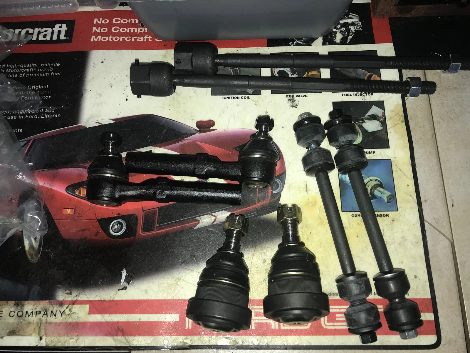

I also got the OEM front suspension parts.
*Sway Bar Bushings - Prothane
*Sway Bar End Links
*Ball Joints - I am so not looking forward to this one. I'll need to rent the tool, ugh.
*Outer Tie Rods
*Inner Tie Rods - Not going to install them until needed.

Front end parts.

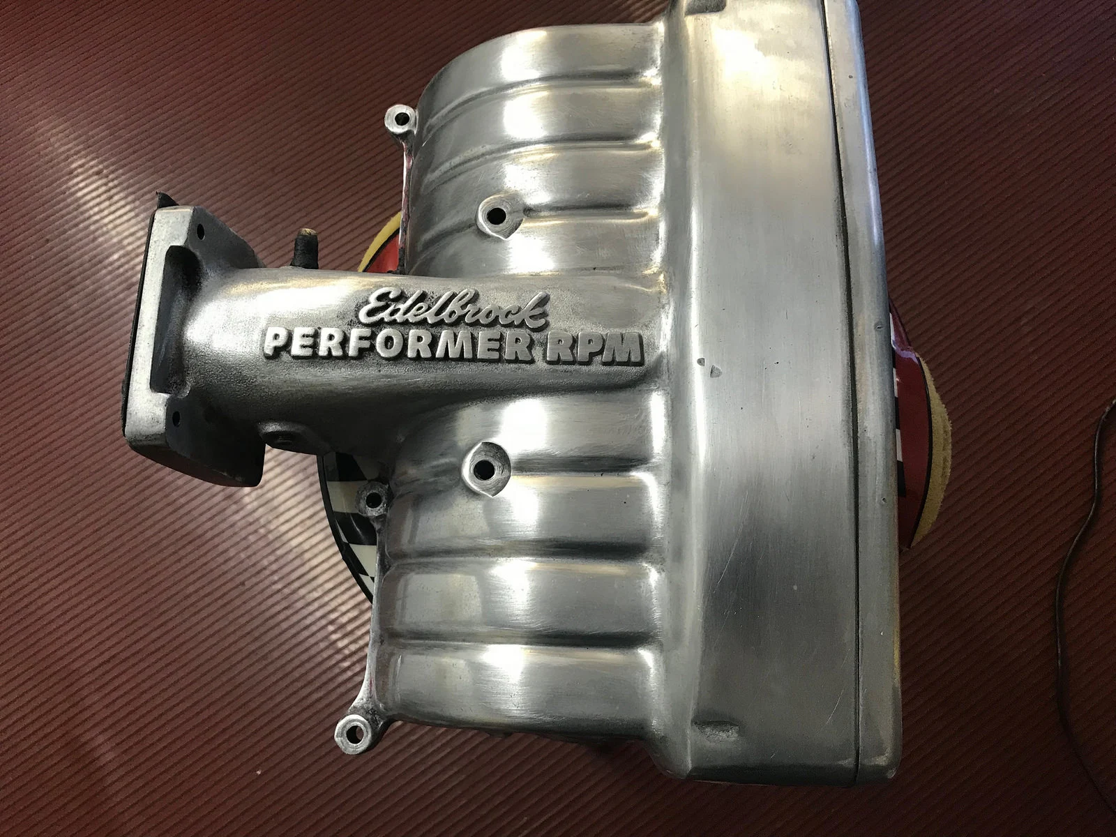

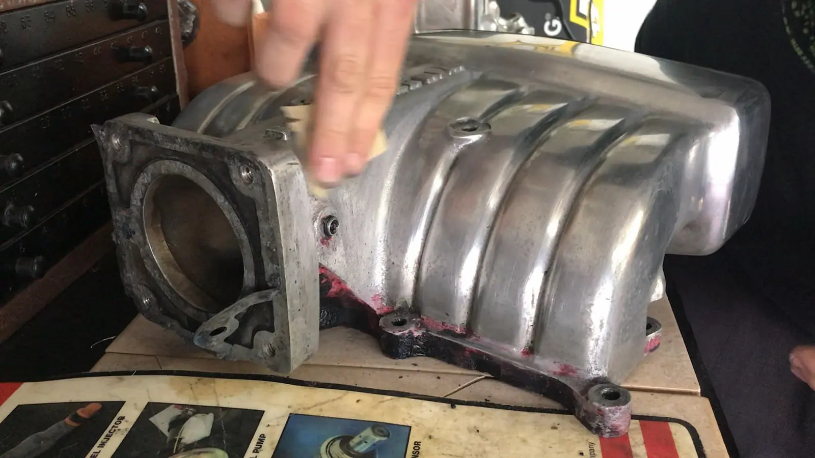

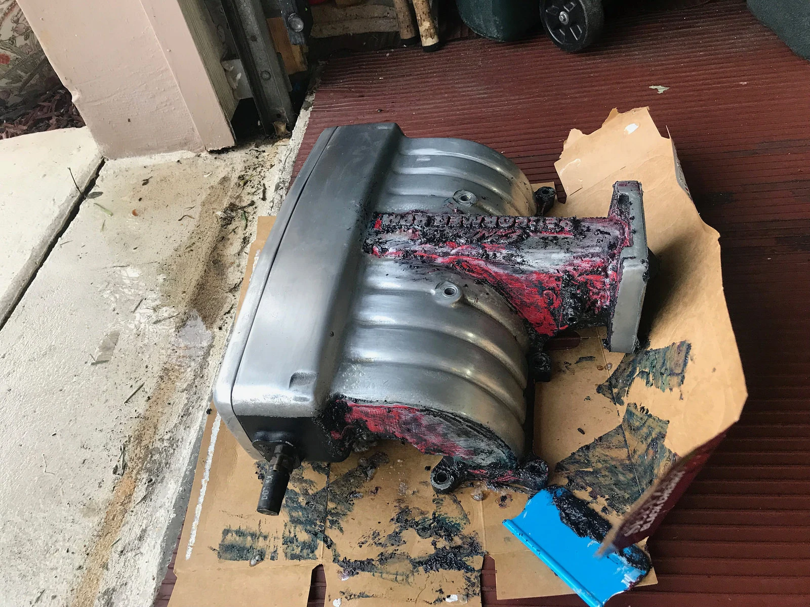

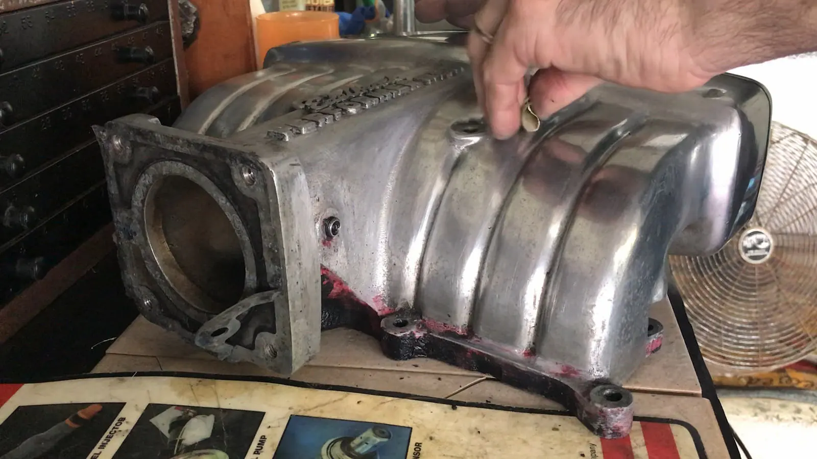

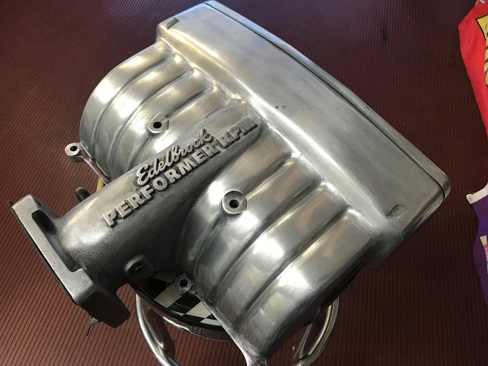

What I've been doing is working on the intake. Had to get the crap black paint off of it and of course my red paint was underneath (I painted the red back in 2002).
I have video of a few things for the next episode.
Removing the paint with stripper.
Untitled by https://www.flickr.com/photos/[email protected]/, on Flickr
Still not done, just called it quits for the night.

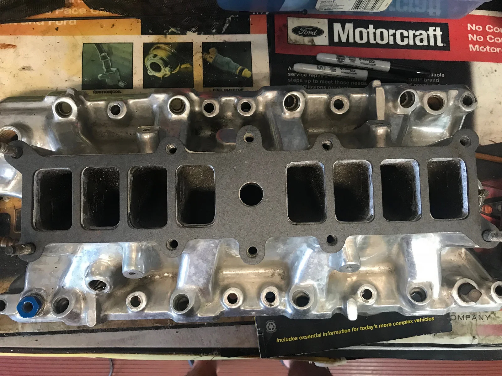

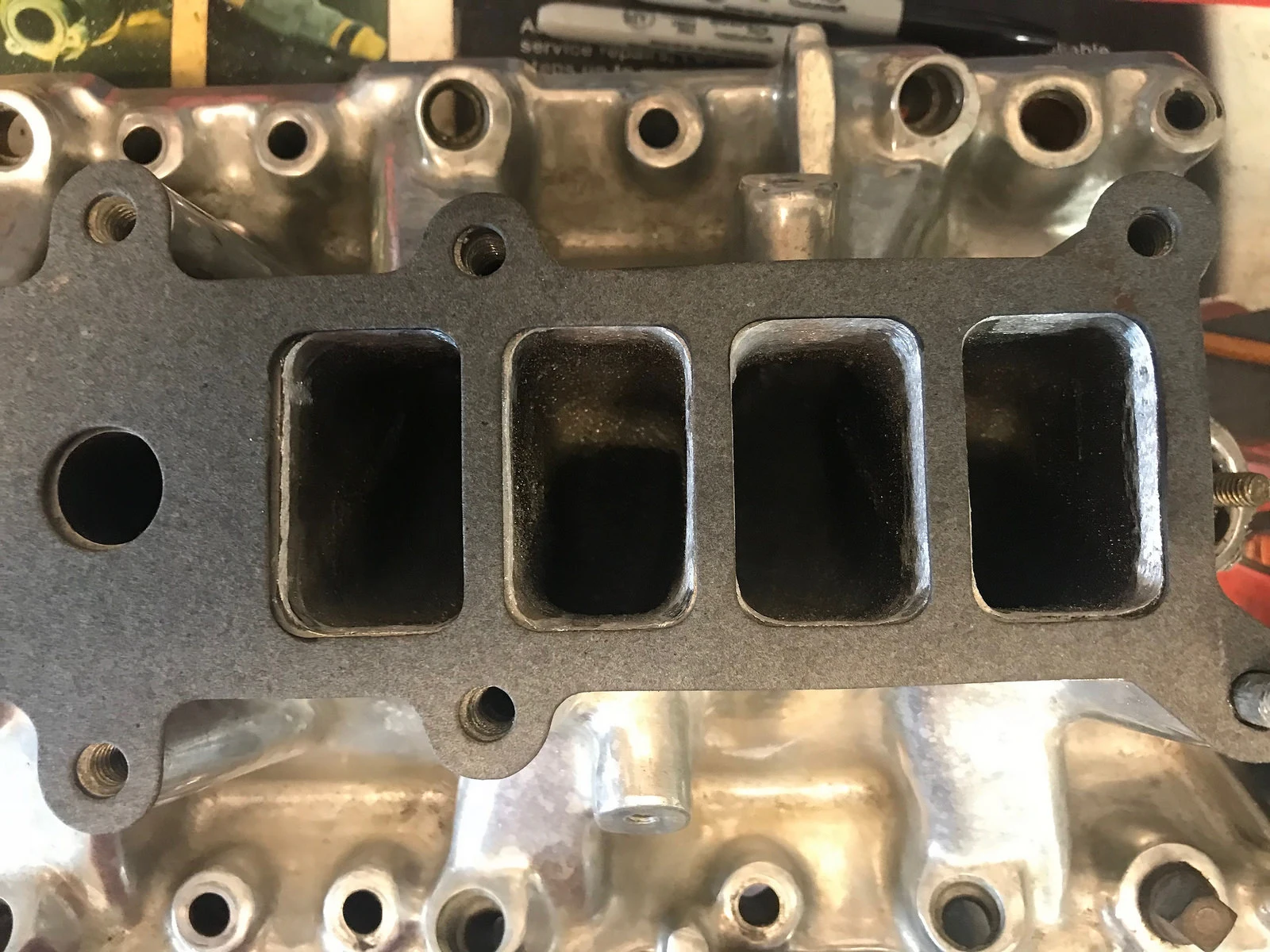

Found a new issue with the intake, this time the lower. I've been working on the upper so much I never even looked at the bottom portion.
So the lower is not from Edelbrock, it's the Professional Products Made in China knockoff.

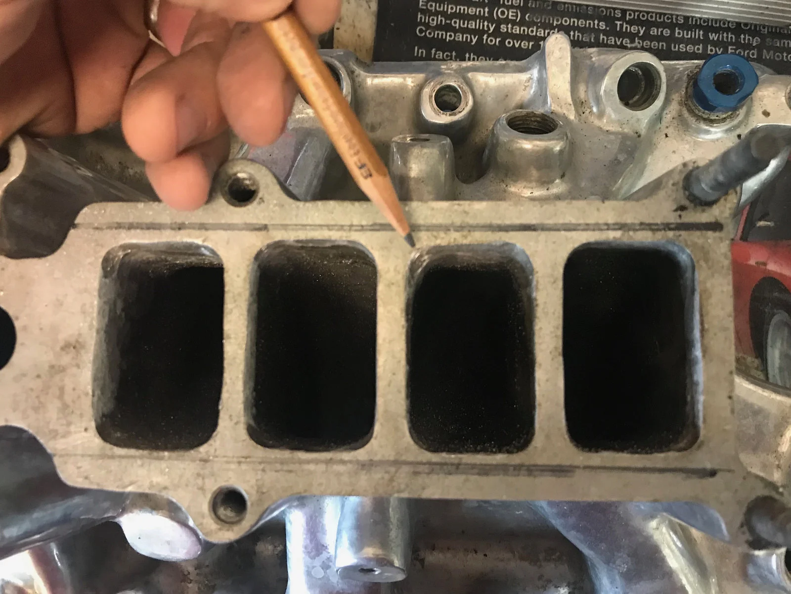

I put the new upper gasket on and noticed lots of metal showing. The ports were so small, they were uneven and not one was the same all the way down the line.
So I a straight line down in Sharpie to see if my eyes were playing tricks on me, nope all uneven. I then put the gasket on and started porting the chambers.
Here is the line. As you can see, all of them aren't the same shape.
Untitled by Joe Pisciotta, on Flickr

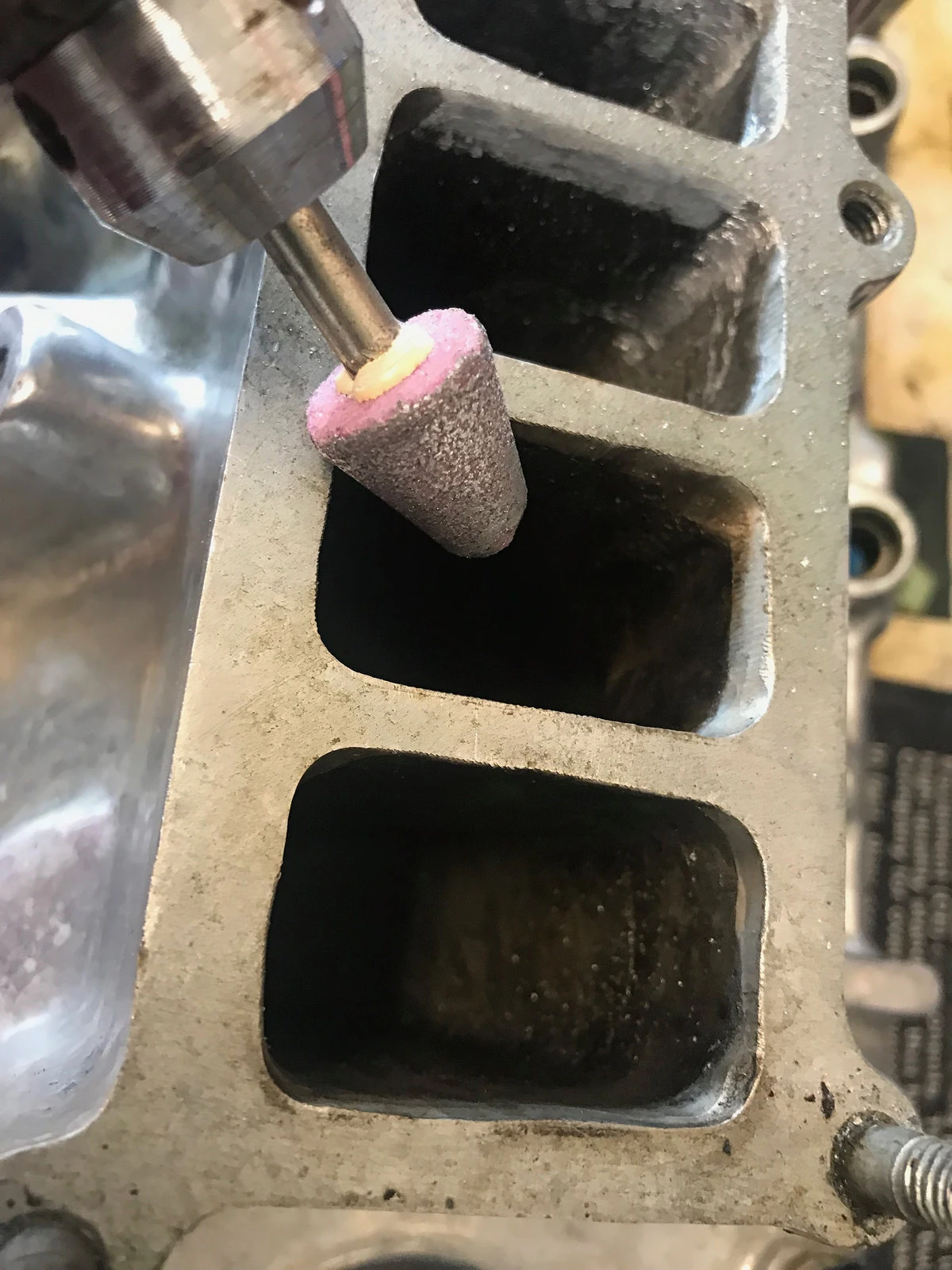

Started shaping the chambers.
I still have more shaping to do.
Had to stop, my hands were vibrating so much I couldn't feel them. I'll continue tonight.

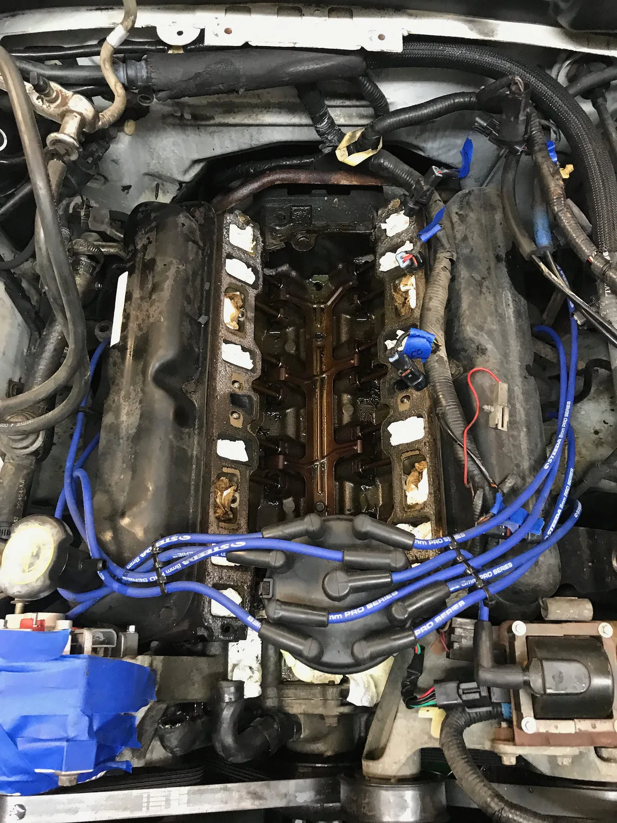

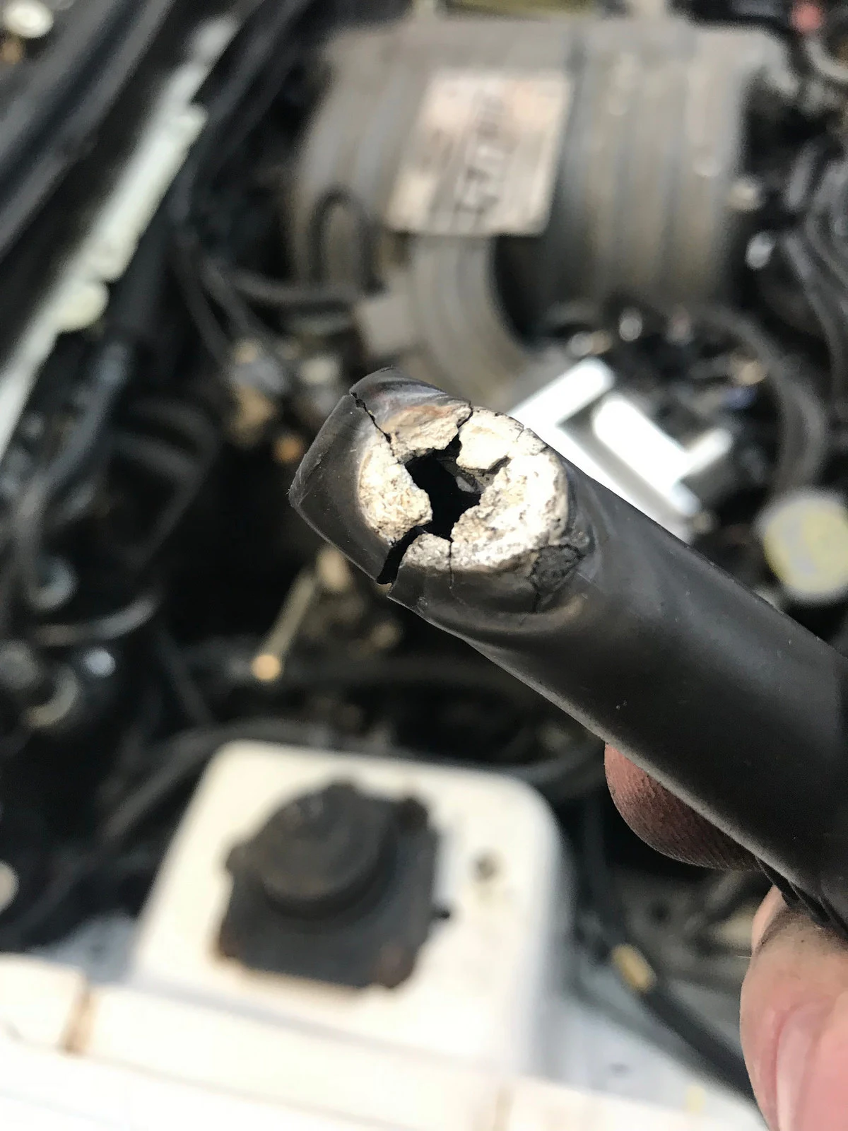

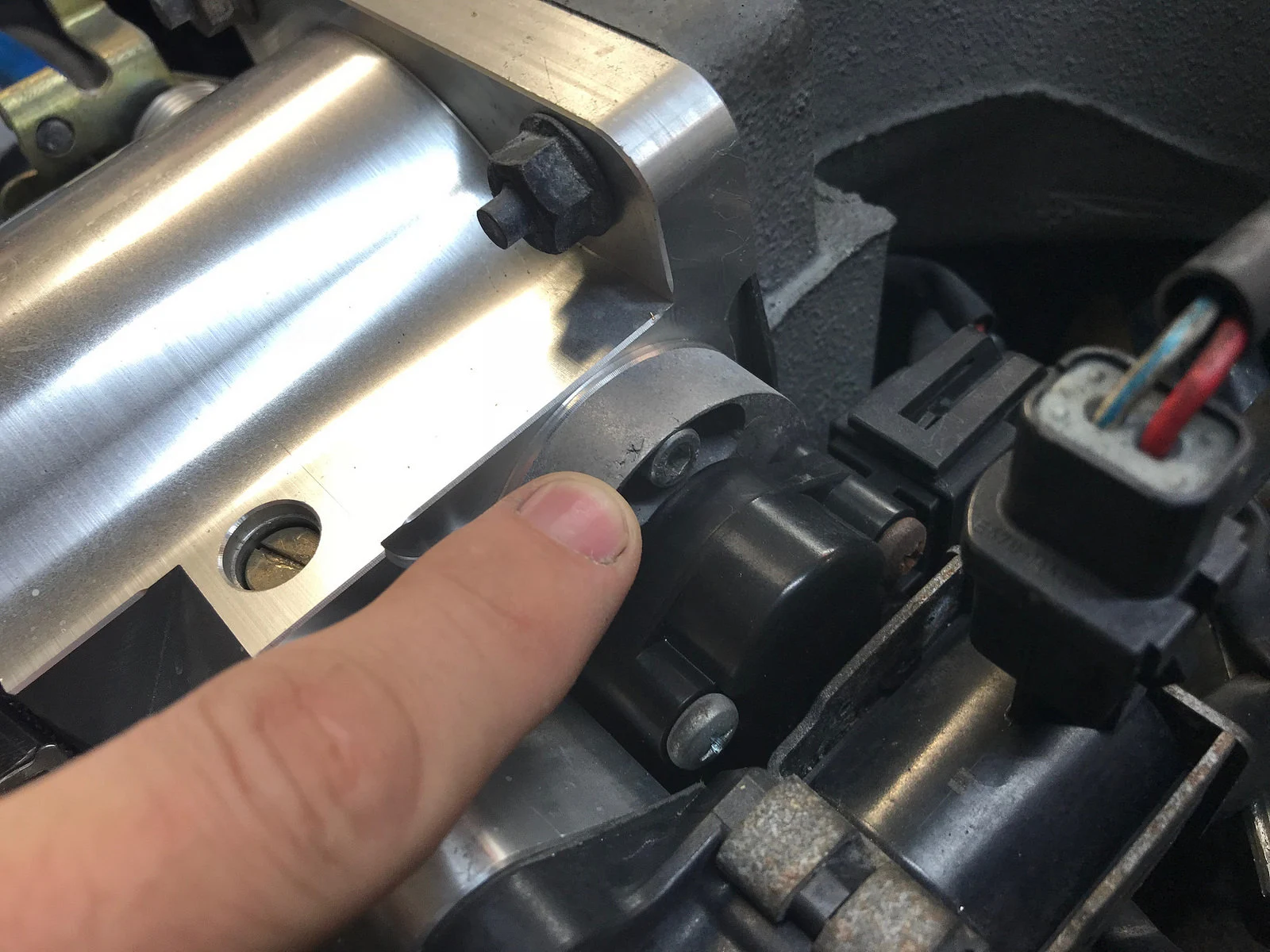

"The Onion" has really been kicking my ass lately which is why Episode 8 hasn't been released.

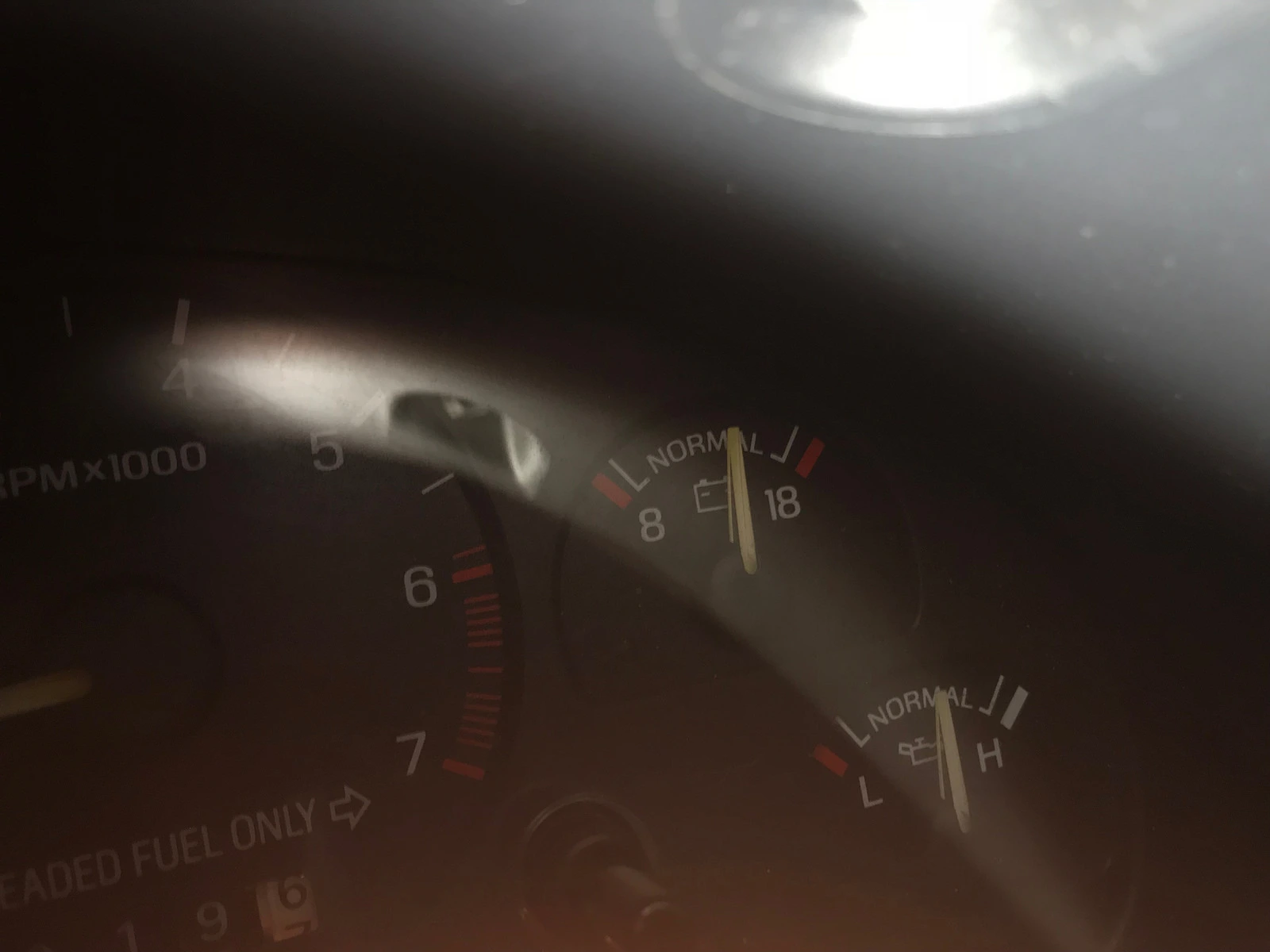

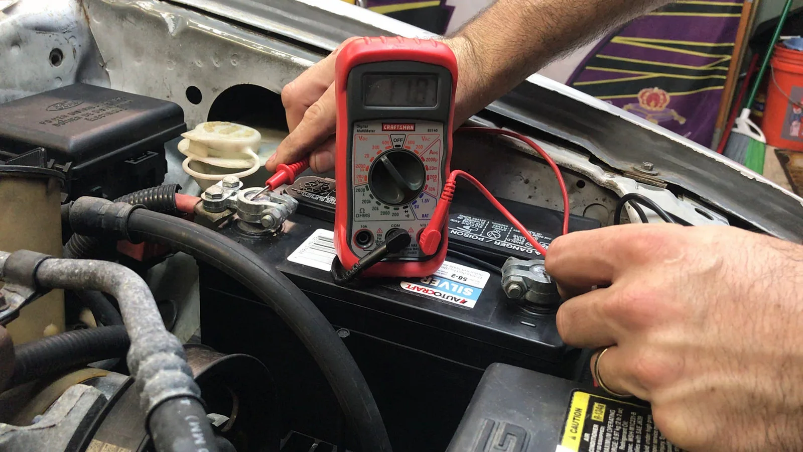

I've been having charging issues since day 1 and last night I finally....finally had the break through I needed. The car was stuck at 12.0V, while running then wouldn't start again (it will be in the next episode). I changed the Alternator and it only brought me up to 12.4v but after idling the volts decline. Last night I decided to chase every ground on the car and I found the issue. A few grounds were cut and dead, I found chaffed ground wires under the battery tray that go to the power box. After I repaired everything the car is now making 14.7v while idling. That's a Victory! The voltage gauge in the car isn't sitting a tad past 8 anymore, it's far the right now.

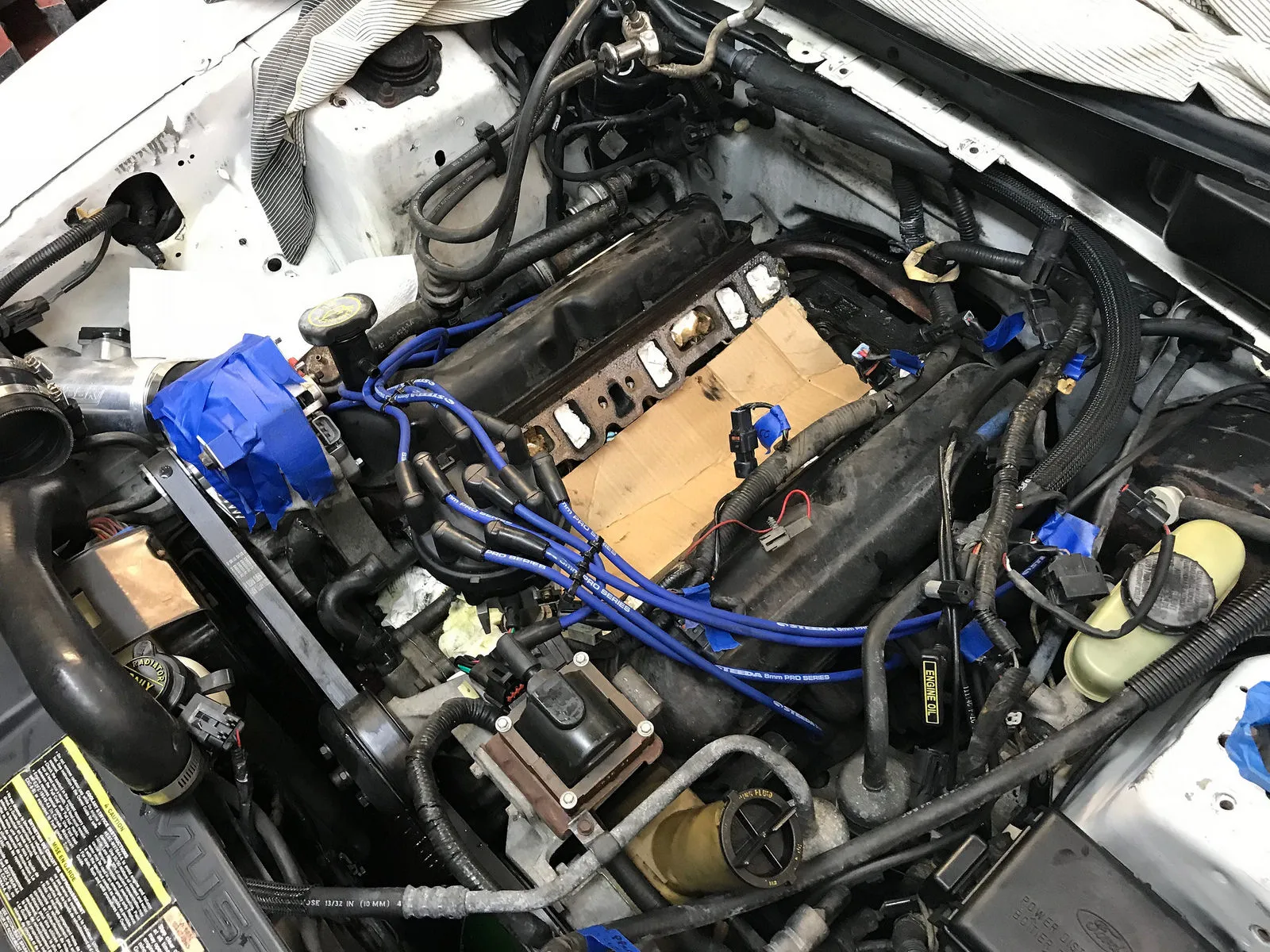

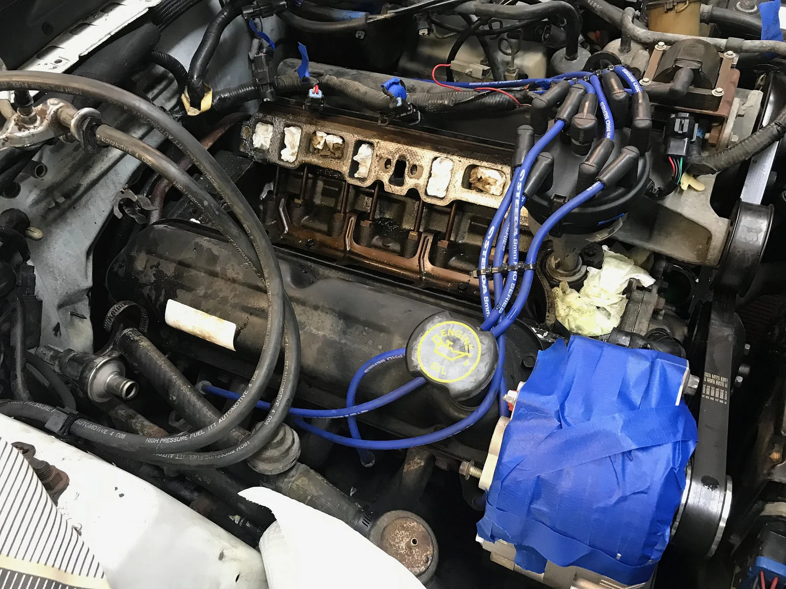

Then "The Onion" struck again! One thing this car is good at and that's idling. Well I heard a weird ticking on the passenger side and the idle is stumbling, wants to stall. I look down by the passenger header and I see some smoke, smells electrical. The plug wire is sitting on the header and put a hole in the boot. The ticking was the spark zapping the header through that hole. Placed an order to Steeda for 94-95 Specific plug wires, these were stock anyway which needed to go.

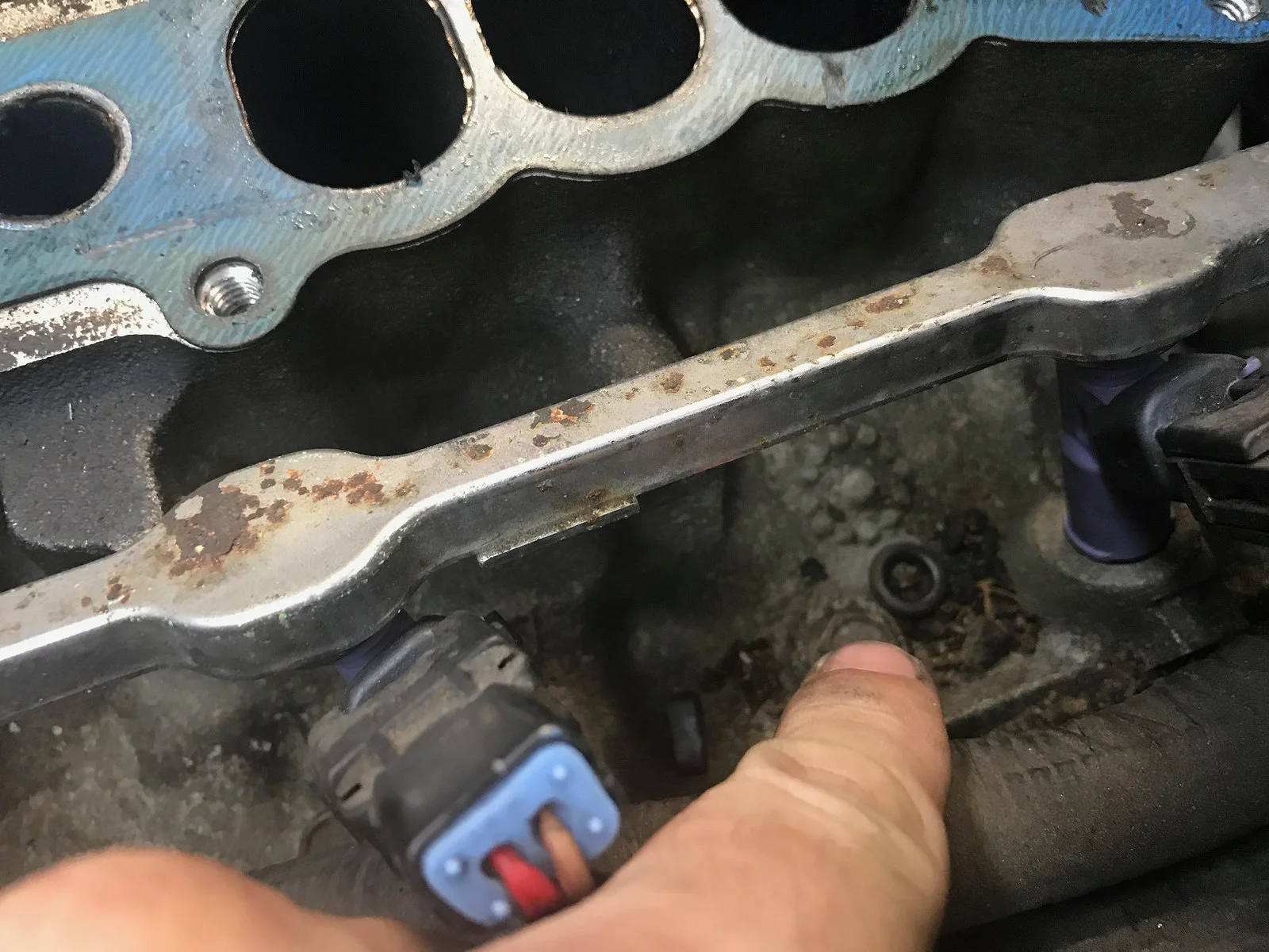

I also found some injector o-rings laying around. Hopefully all of these injectors do have the o-rings and there from the 19's. Don't know why the dude upgraded to 24 pound injectors.

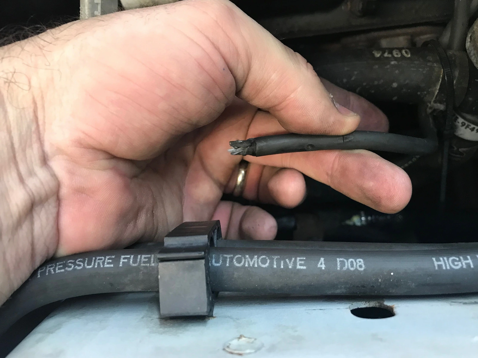

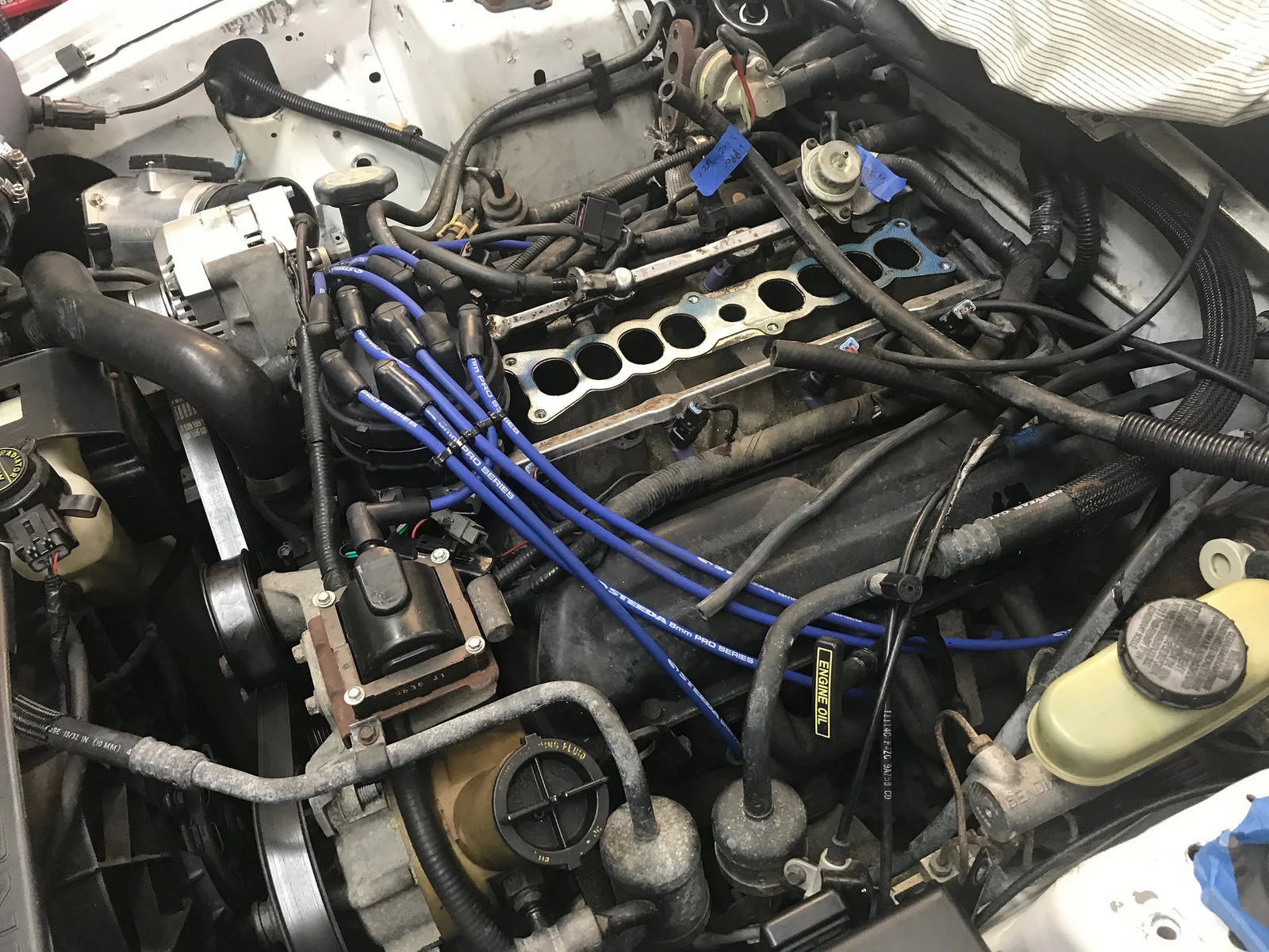

More work went down last night.
More bootlip stuff found, ever connector tab is either broken or has none. People don't know how to remove a Ford connector or what?

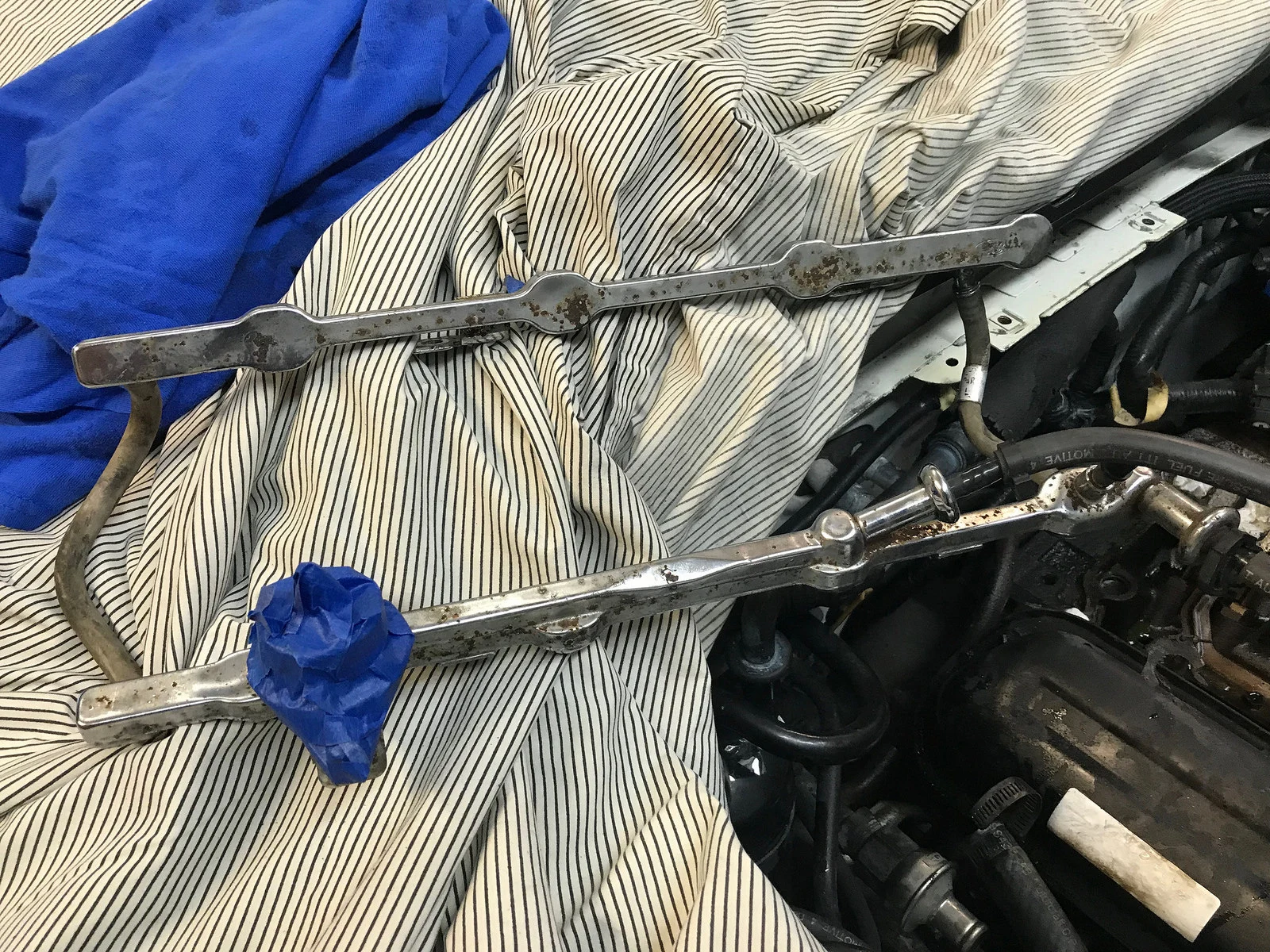

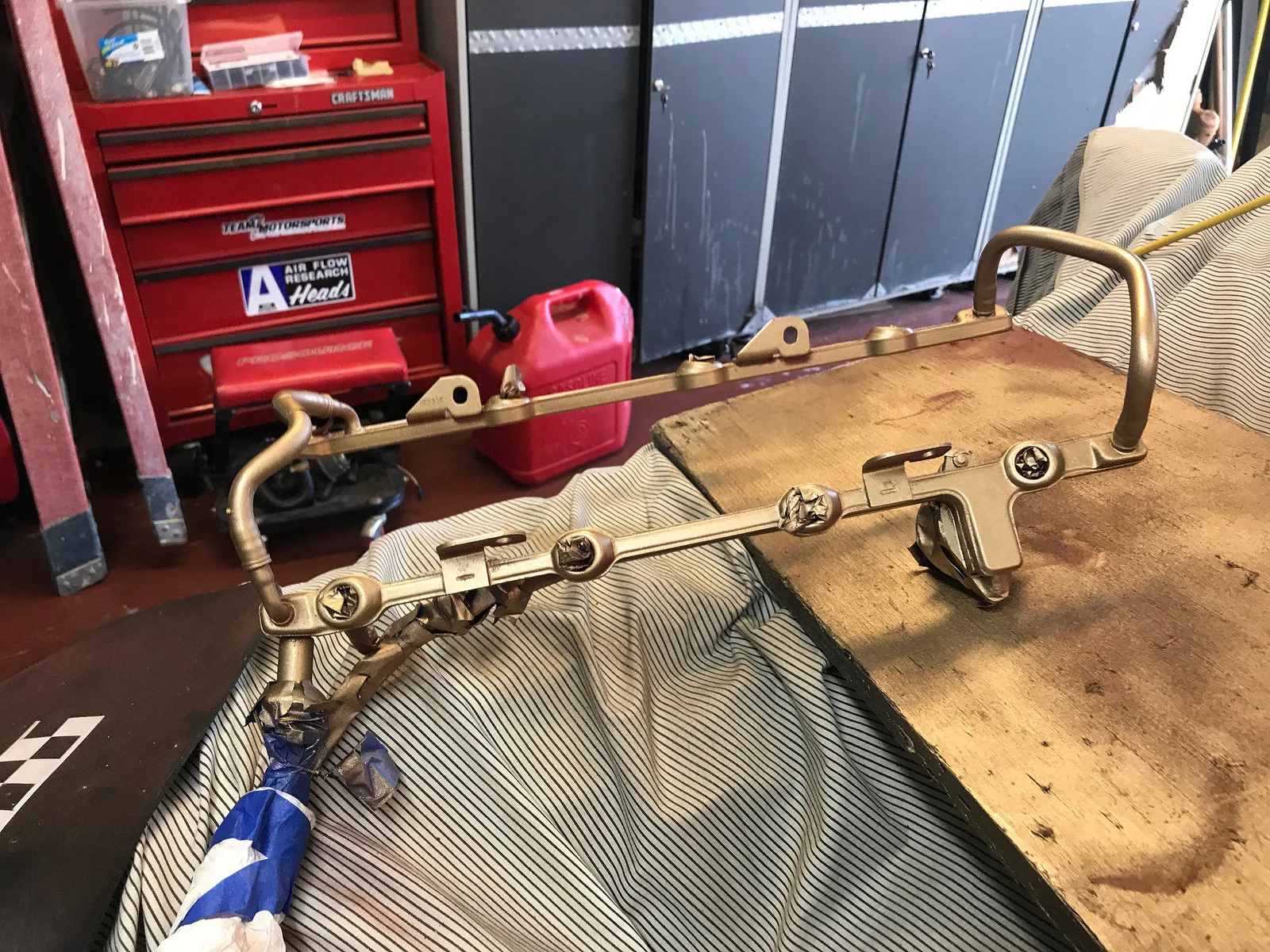

Anyway, it's down to the block. Going to paint the fuel rails, they are rusty and dirty. Want to paint the valve covers too.

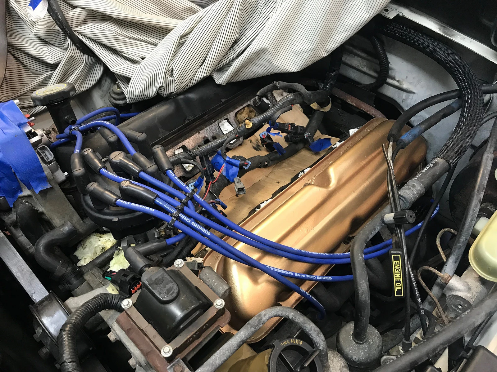

More work last night.

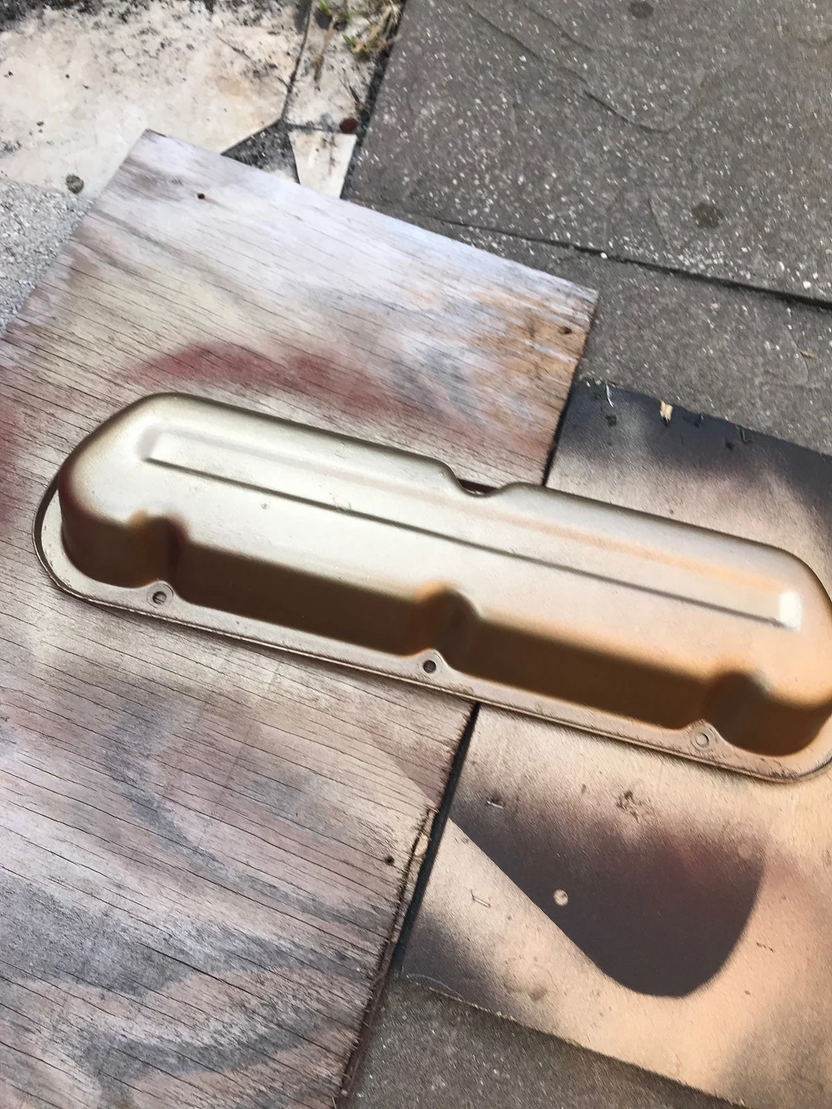

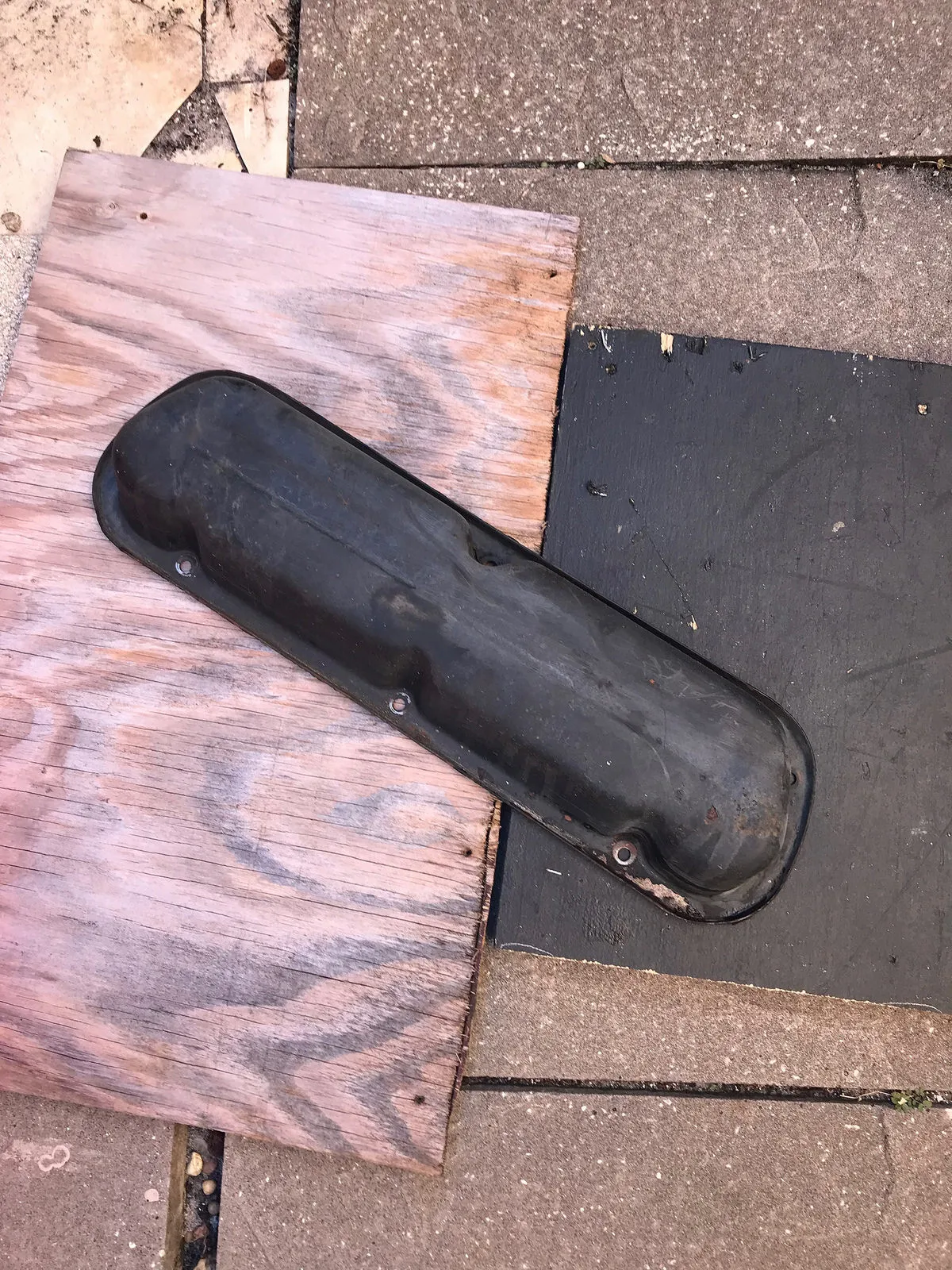

The dirty dingy valve covers were bothering me so I popped them and painted them bronze. Did the same with the fuel rail.

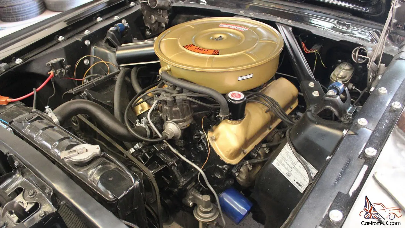

Nice! Going for the 289 HiPo look?
Don't even know what that is. I assume they used a bronze color.
I just thought I'd mix it up instead of black, grey or silver. Although those color do hide the imperfections and this bronze brings them out clearly.
After I"m done and it doesn't look right I'll change it. For now I'm digging it.
It was technically gold, but the look is very much the same. I think it's a nice touch. This is a picture of a 1965 with a 260, but the 289 HiPo was dressed the same way.

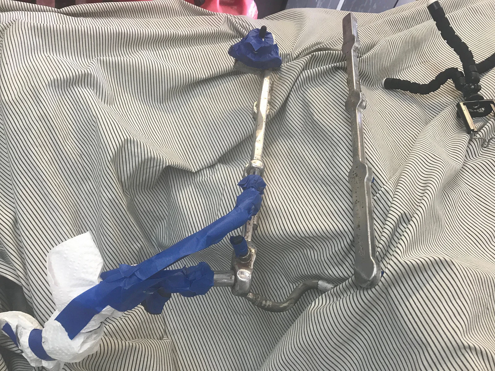

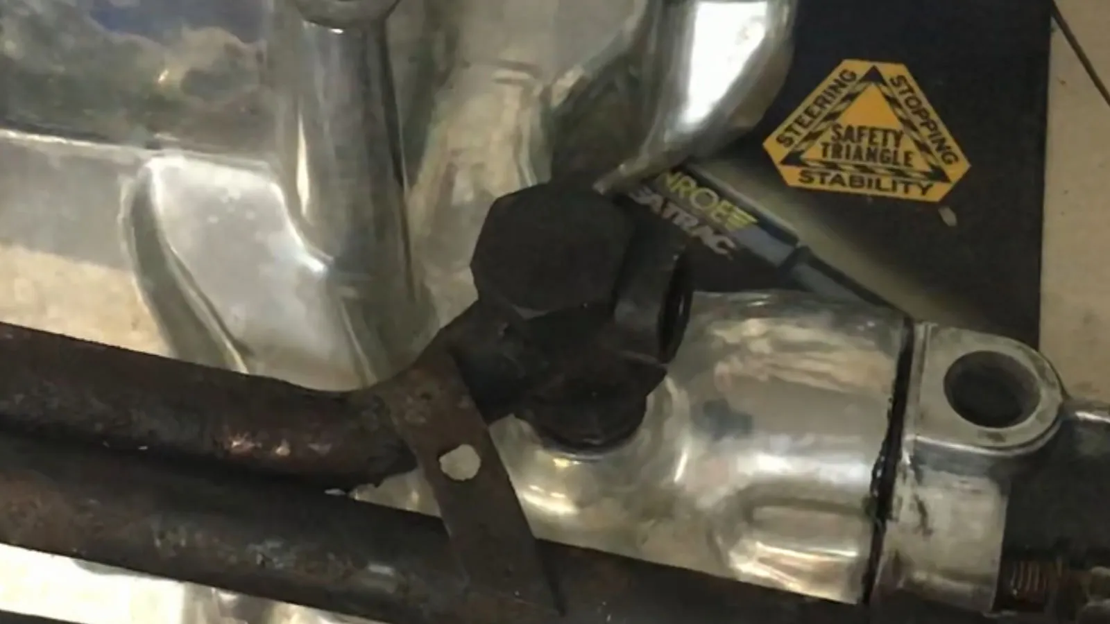

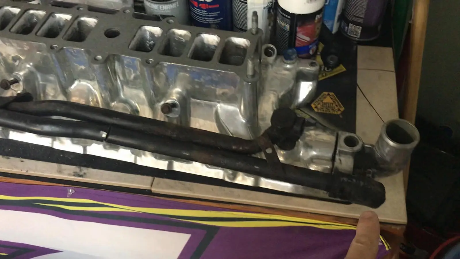

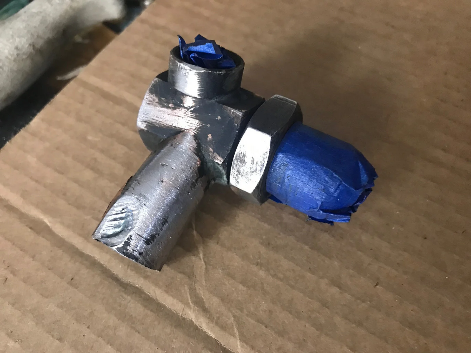

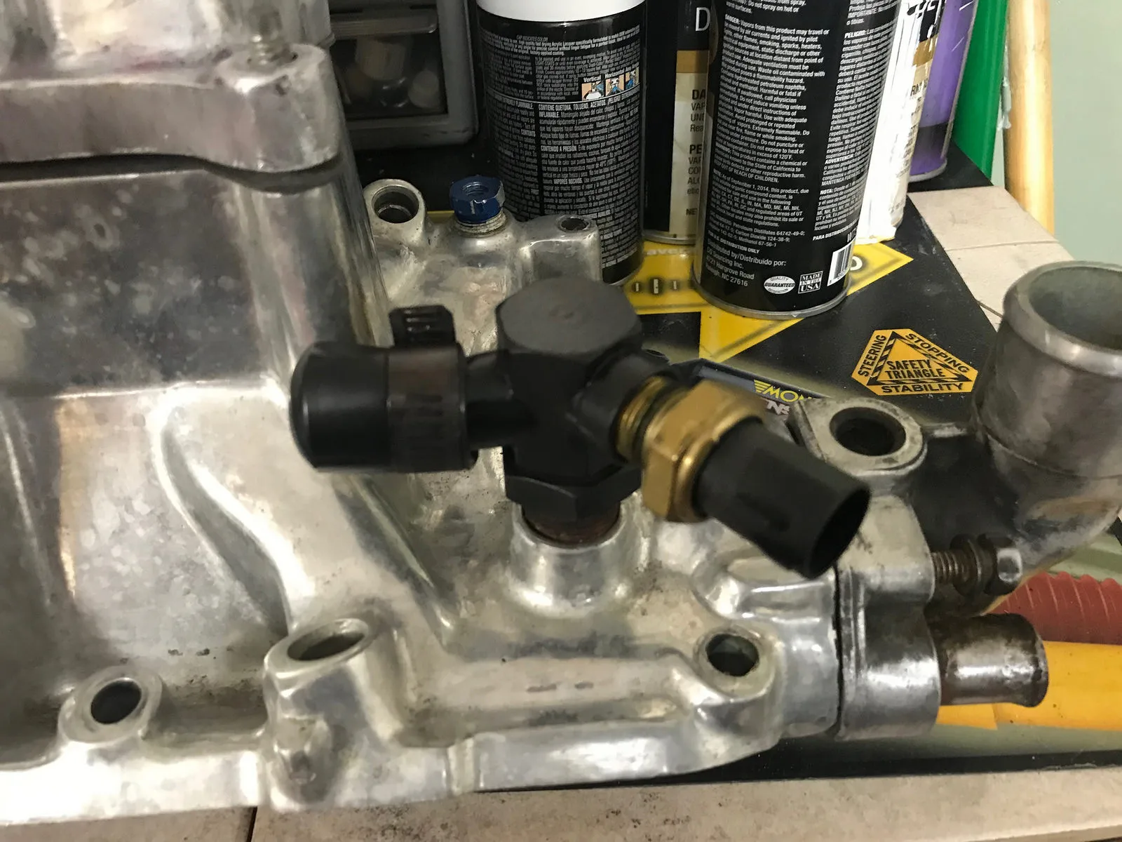

Didn't get much done but chasing threads on the used intake and ditched the heater stuff on the lower intake.
In order to get the temp sensor to work I need the adapter so I did the same mod as my previous 94.
I cut the heater tubes, capped off the upper one with the temp bung, stripped, primed it, painted it and installed it. Here are the pics.
