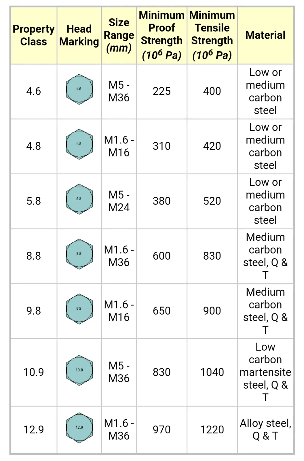

Wayne Waldrep
Before I post a pic, do you have one of yours?

FYI if anyone is interested.

FYI metric class 10.9, is equal to US grade 8, rated at a tensile strength of 150,000 psi, wanna go nuts, class 12.9 are rated at 170,000 psi
