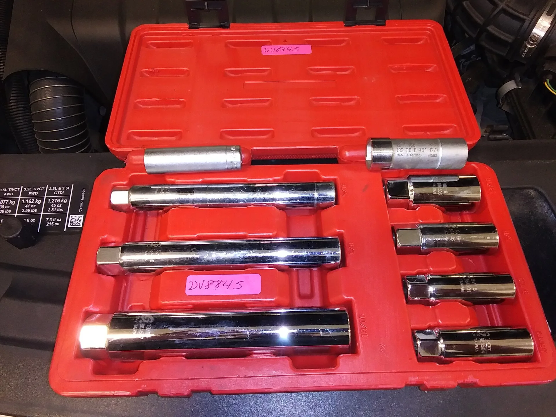

Good grief my spark plug socket selection will soon rival my regular sockets. Thanks, I'll get one coming.
There's the ones I keep at the shop. My Ford 3V socket is at home.

Score! That’s a low price for a specialty tool. Way to be helpful!
Those are rarely expensive. I think mine is Gearwrench-branded. CTA is top-notch quality though, and when it was the first search result and at that price? Yeah, I linked that one.
