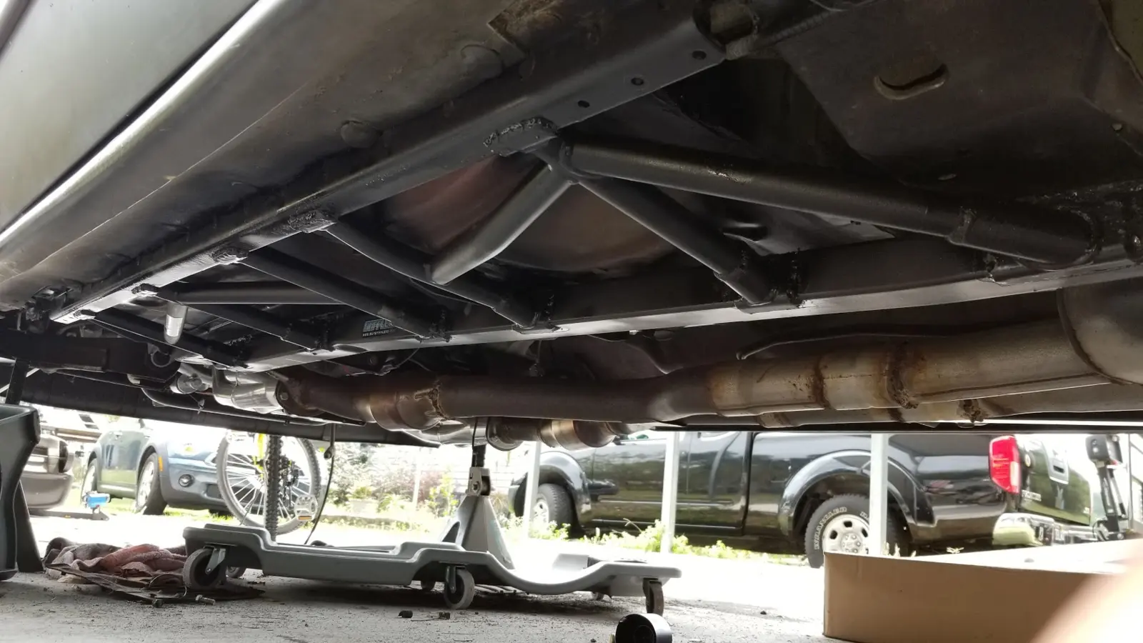

IF you have them on hand post a few pictures of them with the dimensions. The good ones are 2" x 1.5" with seat brackets and extend from the very front of the front subframe to the bottom of the lower control arm and have sealed ends.
I personally used Stifflers Fit kit on my convertible.

that looks like a TON of work haha, they are full length so it says but i doubt as long as other brands, they also have the seat connectors also, again i dont plan to ever build it up immensely so dont need anything crazy, but i do think i would like to get the MM ones. being a convert. and bottom of car is decent shape even torque boxes at 155k would rather spend the extra 100 and get stronger.
