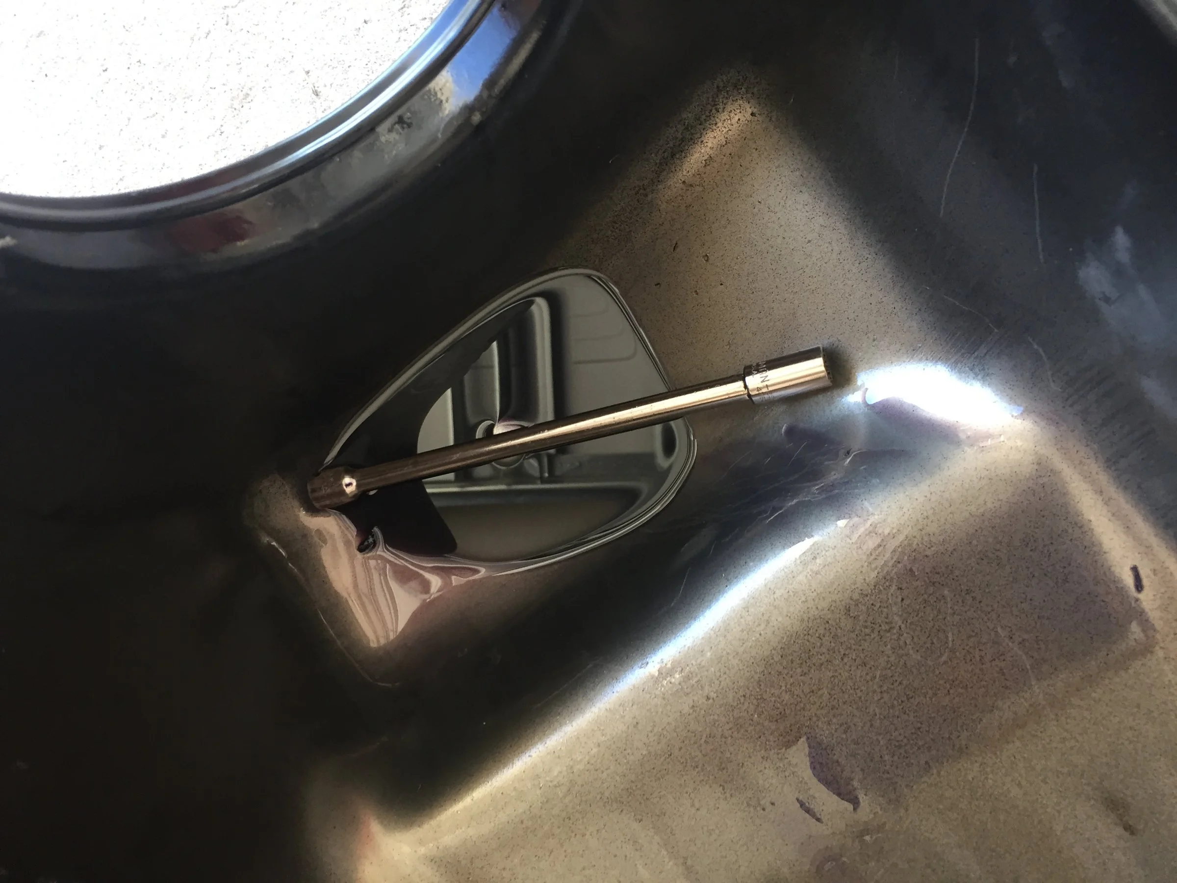

what happened and what is the crud in the bottom of the pan?
Priming the oil pump, extensions came apart (even though they were taped together). Clink Clink Clunk right to the bottom. couldn't get it out with a magnet due to it being wedged under the oil pickup. Had to pull the motor and drop the pan. Crud in the pan is just some pain overspray from manufacturing, and some new oil.

ThE tool to prime the pump isn't expensive. A lot less frustrating too when you use it with a cordless drill.

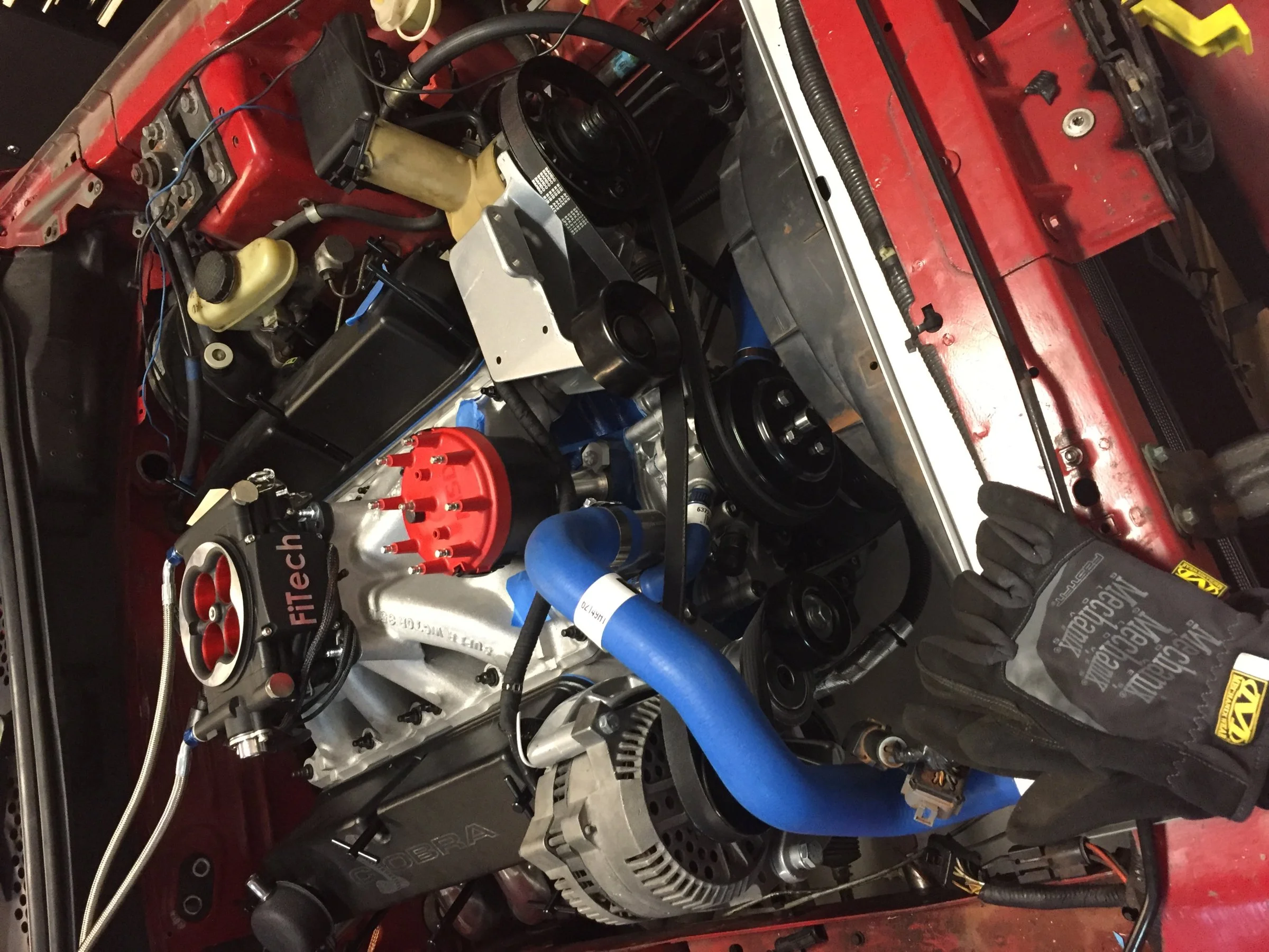

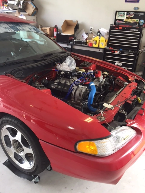

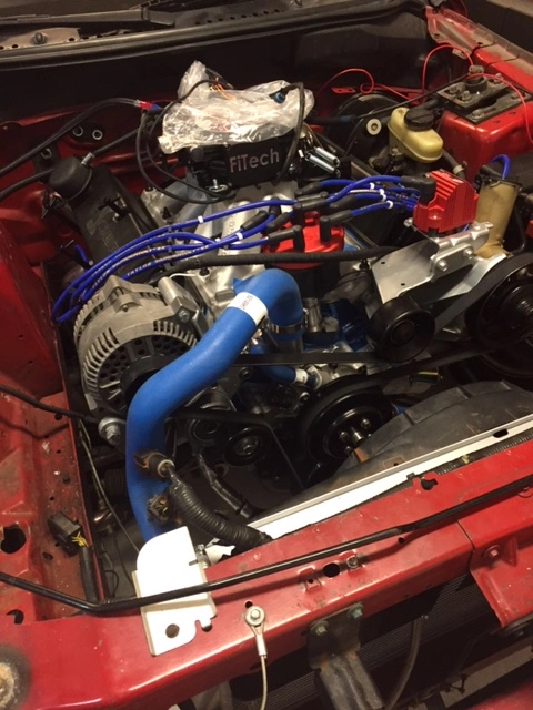

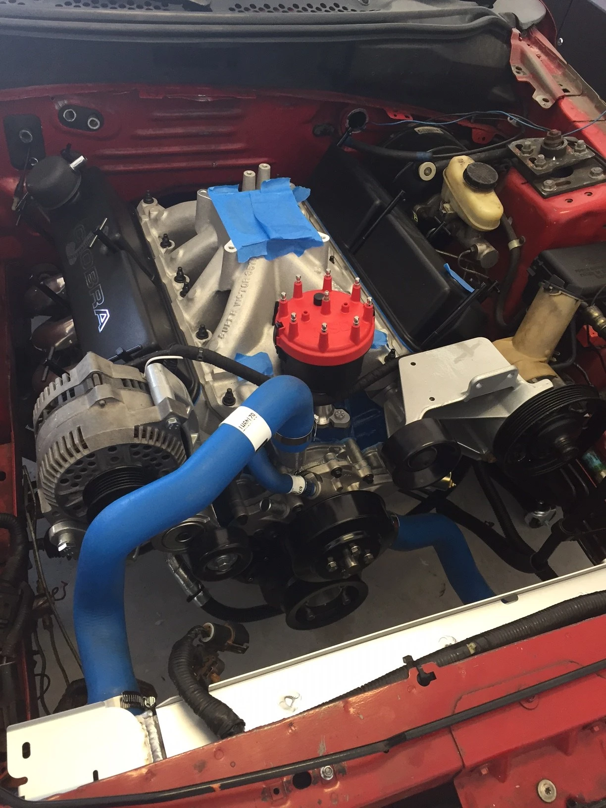

In the home stretch. All thats left is wire up the MSD, Fitech and fan, fill the trans with fluid, and hook up the mid-pipe and mufflers and it's time to fire! I'm off work tomorrow, so that gives me a full day to work on the car with no honey do list or kids to take care of.

Getting closer. Front end is on, everything excpet fan is wired up. I can crank and get it to fire briefly, but dies right away. It's something with the Fitech. The mid-pipe I got doesn't fit correctly, so I have a new one on order. With open long tubes this thing is LOUD AS HELL when it does fire briefly. Sounds like a damn Pro Mod. Can't really mess with much else until the exhaust is buttoned up. The neighbors do not appreciate. Can't see why not. I figured the ultra-liberal guy next door from California that drives a Prius would think it's cool. He doesn't. Oh well.
